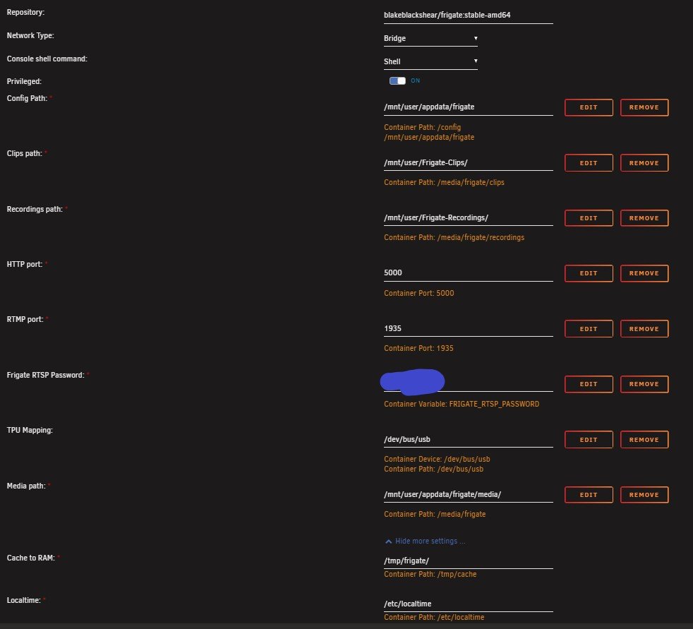

yayitazale Posted October 8, 2021 Author Share Posted October 8, 2021 38 minutes ago, DanielWWS said: using unraid and seem to be getting a constant error popping up at every detection: ## the start up process looks okay to me but im a novice. below log from start up ## this is my config.yml file: Ive installed the coral drivers but the TPU's are USB's and ive tried just one or the other and we get the same results. Its when a detection happens this starts. The usb's are both in USB3 ports and its got 32gb ddr3 memory // [email protected] processor and ive built this machine pretty much just to test and run this (from old parts but its all good.) Version: DEBUG 0.9.1-800F33E coral1 = inference speed - 10 coral2 = inference speed - 29.9 Does anyone have any ideas how to stop this reoccuring error? can it be added for someone to look into dealing with it if its a bug in unraid? I'm out for Holidays till tuesday so I can't help you but just for helping a little, the usb coral does not need the drivers so you can uninstall them. Make sure that you are binding the correct paths to the folders and that the container is on privileged mode. 1 Quote Link to comment
DanielWWS Posted October 8, 2021 Share Posted October 8, 2021 I'm out for Holidays till tuesday so I can't help you but just for helping a little, the usb coral does not need the drivers so you can uninstall them. Make sure that you are binding the correct paths to the folders and that the container is on privileged mode.Hi, thank you and I hope you enjoy your holidays. No mad rush! We’ve all got to have some down time. I installed the coral drivers after the problem started. Pushed a restart and hoped it would deal with the problem but it didn’t. Just deleted them and will test and report back before Tuesday. All other settings not changed. Sent from my iPhone using Tapatalk Quote Link to comment

yayitazale Posted October 13, 2021 Author Share Posted October 13, 2021 On 10/8/2021 at 7:00 PM, DanielWWS said: using unraid and seem to be getting a constant error popping up at every detection: ## the start up process looks okay to me but im a novice. below log from start up ## this is my config.yml file: Ive installed the coral drivers but the TPU's are USB's and ive tried just one or the other and we get the same results. Its when a detection happens this starts. The usb's are both in USB3 ports and its got 32gb ddr3 memory // [email protected] processor and ive built this machine pretty much just to test and run this (from old parts but its all good.) Version: DEBUG 0.9.1-800F33E coral1 = inference speed - 10 coral2 = inference speed - 29.9 Does anyone have any ideas how to stop this reoccuring error? can it be added for someone to look into dealing with it if its a bug in unraid? Can you test your Coral doing this on another machine like a raspberry, a Windows or a VM?: https://coral.ai/docs/accelerator/get-started/ Quote Link to comment
