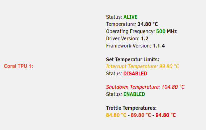

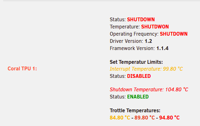

Hi @ich777
Ok, it seems the issue was indeed with the TPU reaching high temperatures.
shutdowntemp0=104800
shutdown_en0=1
shutdowntemp1=104800
shutdown_en1=1
shutdowntemp2=104800
shutdown_en2=1
shutdowntemp3=104800
shutdown_en3=1
Now it's much better as I allowed some more ventilation in the case.
2022-04-13 09:19:44 Coral Temp: 45.80C
2022-04-13 09:19:59 Coral Temp: 45.55C
2022-04-13 09:20:14 Coral Temp: 45.55C
2022-04-13 09:20:29 Coral Temp: 46.80C
2022-04-13 09:20:44 Coral Temp: 47.55C
2022-04-13 09:20:59 Coral Temp: 48.30C
2022-04-13 09:21:14 Coral Temp: 48.55C
2022-04-13 09:21:29 Coral Temp: 49.05C
2022-04-13 09:21:44 Coral Temp: 49.30C
2022-04-13 09:21:59 Coral Temp: 49.55C
2022-04-13 09:22:14 Coral Temp: 49.80C
2022-04-13 09:22:29 Coral Temp: 49.80C
2022-04-13 09:22:44 Coral Temp: 49.80C
2022-04-13 09:22:59 Coral Temp: 50.30C
2022-04-13 09:23:14 Coral Temp: 50.05C
2022-04-13 09:23:29 Coral Temp: 50.05C
2022-04-13 09:23:44 Coral Temp: 49.80C
2022-04-13 09:23:59 Coral Temp: 49.80C
2022-04-13 09:24:14 Coral Temp: 50.05C
2022-04-13 09:24:29 Coral Temp: 49.80C
2022-04-13 09:24:44 Coral Temp: 49.55C
2022-04-13 09:24:59 Coral Temp: 50.05C
2022-04-13 09:25:14 Coral Temp: 49.80C
2022-04-13 09:25:29 Coral Temp: 49.55C
2022-04-13 09:25:44 Coral Temp: 49.80C
2022-04-13 09:25:59 Coral Temp: 49.80C
2022-04-13 09:26:14 Coral Temp: 50.05C
2022-04-13 09:26:29 Coral Temp: 50.05C
2022-04-13 09:26:44 Coral Temp: 49.80C
2022-04-13 09:26:59 Coral Temp: 49.80C
2022-04-13 09:27:14 Coral Temp: 50.05C
2022-04-13 09:27:29 Coral Temp: 49.80C
2022-04-13 09:27:44 Coral Temp: 49.80C
2022-04-13 09:27:59 Coral Temp: 49.80C
2022-04-13 09:28:14 Coral Temp: 50.05C
2022-04-13 09:28:29 Coral Temp: 49.80C
2022-04-13 09:28:44 Coral Temp: 50.30C
2022-04-13 09:28:59 Coral Temp: 49.80C
2022-04-13 09:29:14 Coral Temp: 49.80C
2022-04-13 09:29:29 Coral Temp: 49.80C
2022-04-13 09:29:44 Coral Temp: 50.05C
The script works great. I will monitor how things go and get back to you.
Thank you for your assistance!

any idea whats going on? when I reboot my unraid machine the driver shows the coral as working:
as soon as I start frigate the coral seems to crash and stays in shutdown mode until next reboot.
Yes, it is most likely that the shutdown temperature of 104.80 °C was triggered and that the module shut itself off.
What module do you own? Are you sure that you have enough airflow over the module?
I've also posted a tutorial how you can write the temperature readings to a file to see what it actually does:
Thanks for taking the time to answer!
I'm using the mini pcie module inside a pci converter (everything else is unavailable atm)
I restarted the container and for the first time it actually ran for a while and didn't crash immediately.
As soon as I walked out and around the cameras (actually giving the coral something to do) it again crashed.

21 minutes ago, sillywalks said:
But I highly doubt it jumped from 40*C to 100*c in 15 seconds to cause a temperature crash.
Why not?
22 minutes ago, sillywalks said:
The temp readings from your script don't make a lot of sense. -89.7*C sound wrong.
These are the redings from the TPU itself and nothing more but if it says -89.7C then ther must be something wrong…
What does the Pligin page say?
4 minutes ago, sillywalks said:
I might have been an idiot and setup an unasigned drive in the wrong mode (not SLAVE r/w) since changing this all is running smoothly. Will let it run and see if it keeps going.
I really can‘t imagine thats related, but it may be if the application itself crashes.
Plugin page didn't say anything except "shutdown"
Currently its been running over an hour without any issues and multiple working detections.
So Unassigned Devices caused this? :D
What temperature are you currently on?
