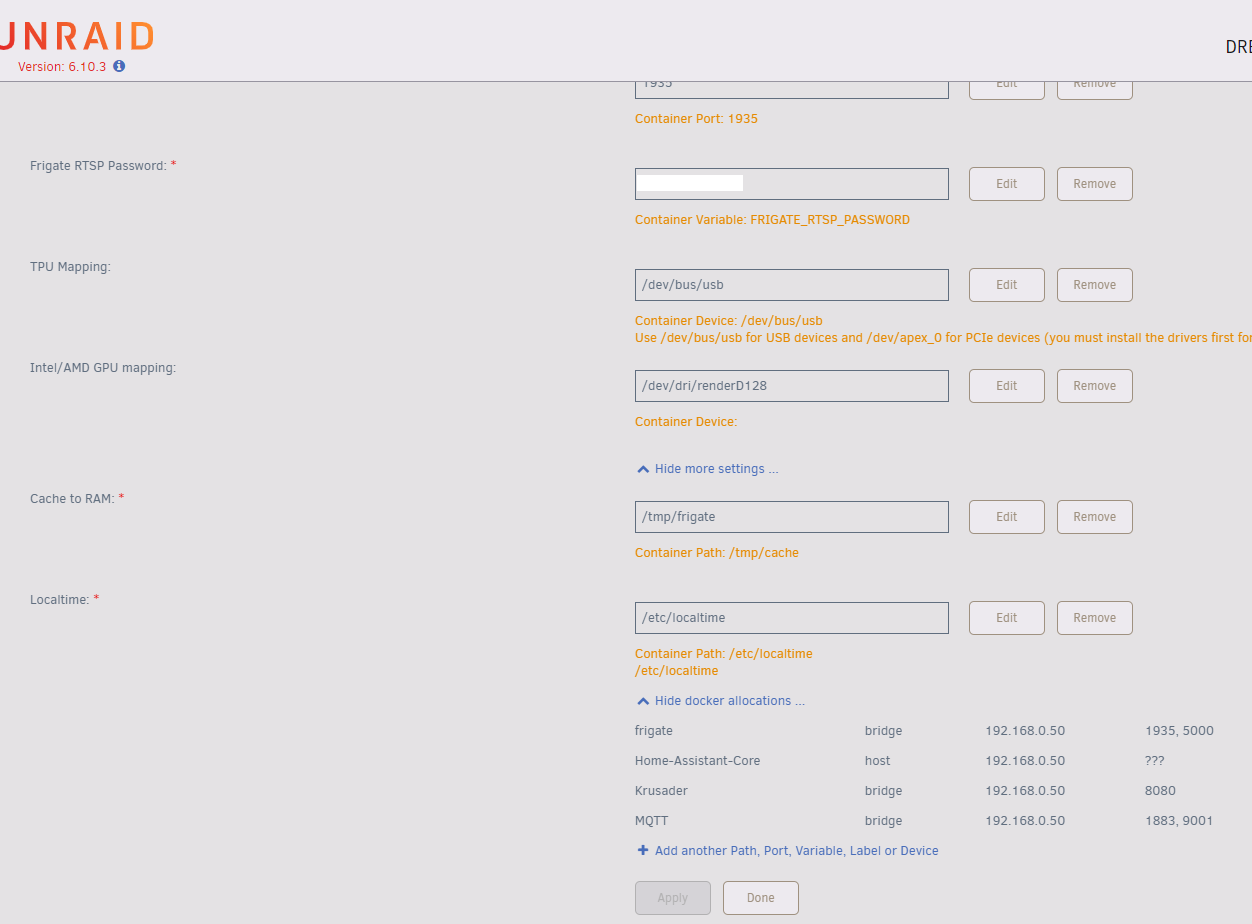

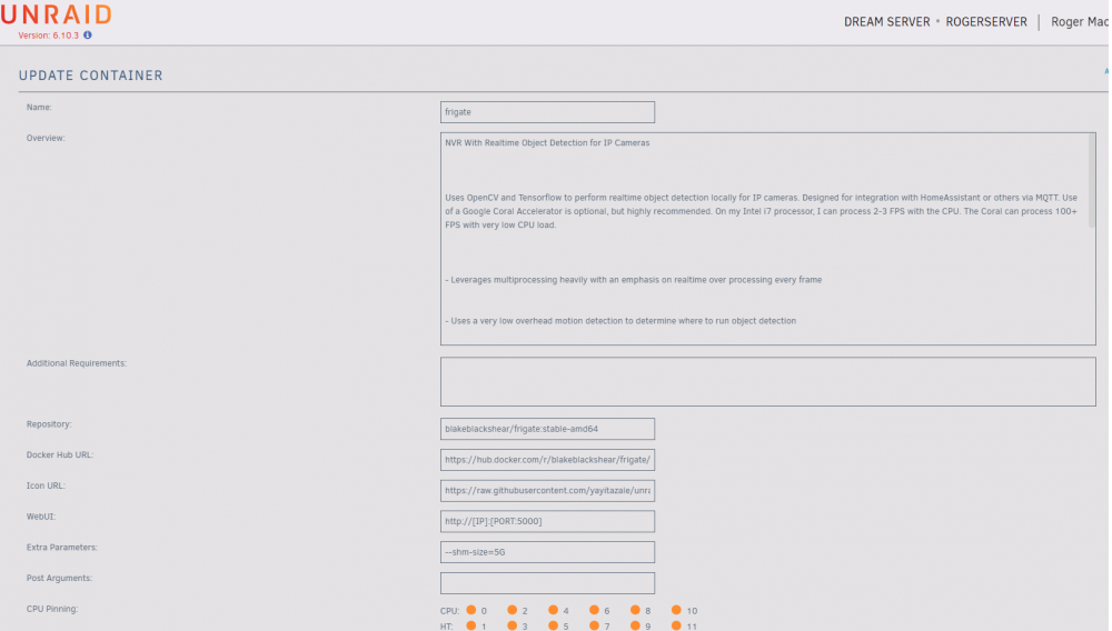

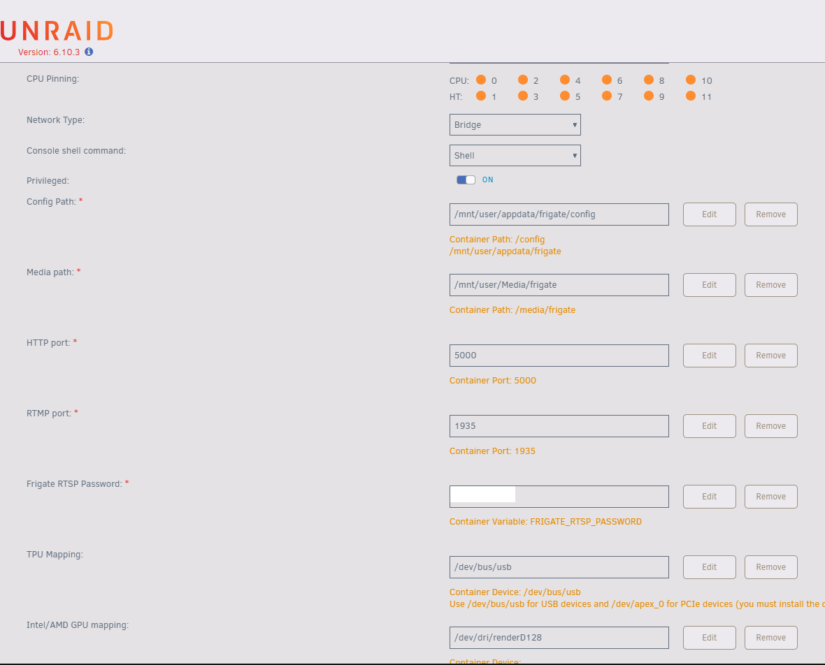

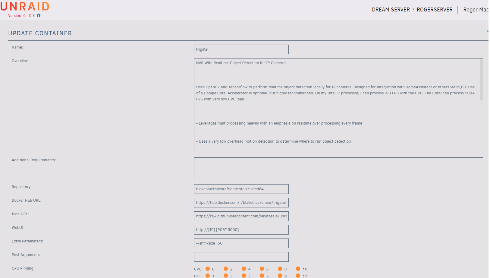

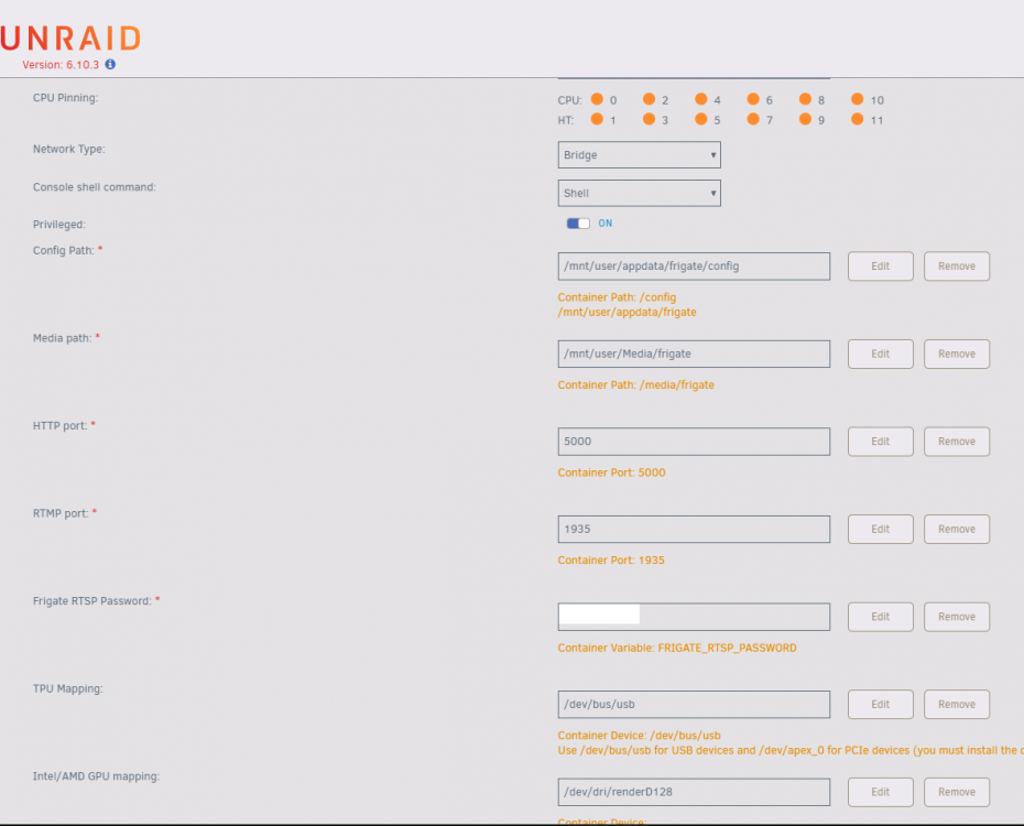

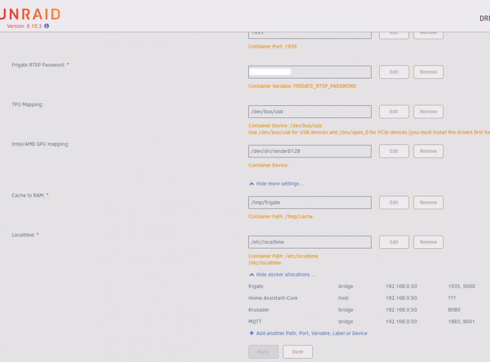

I am not able to make the FRIGATE detect my GOOGLE CORAL USB, for all the attempts I made it always appears written: No EdgeTPU was detected. If you do not have a Coral device yet, you must configure CPU detectors.
What I noticed in some forums was the detail referring to the HARDWARE ID of the pendrive is different from what FRIGATE looks for when it tries to locate a GOOGLE CORAL USB, the ID that is searched for would be the number: 18d1:9302 , since what is detected in my PC (I use UNRAID SERVER system) is the number : 1a6e:089a Global Unichip Corp.
How can I make FRIGATE be able to locate the GOOGLE CORAL USB flash drive plugged into the machine?
Version
Current version: 3.1
Frigate config file
   mqtt:
     host: 192.168.0.213
     port: 1883
     topic_prefix: frigate
     client_id: frigate
     user: roger561
     password: roger561
     stats_interval: 60
detectors:
  coral:
     type: edgetpu
     device: usb
database:
Version
Frigate config file
   mqtt:
     host: 192.168.0.213
     port: 1883
     client_id: frigate
     user: roger561
     password: roger561
     stats_interval: 60
detectors:
  coral:
     type: edgetpu
     device: usb
database:
   path: /media/frigate/frigate.db
     cameras:
       back:
    ffmpeg:
inputs:
- path: rtsp://admin:[email protected]:554/Streaming/Channels/102/
     roles:
     - detect
Can you attach the configuration of the container?
Thank you very much in advance for your help and attention, the prints are below, if that is not what you want, please let me know where I am looking for the information you need, very grateful!
Edited by Roger Maciel de Souza
I don't see anything wrong. Can you try to use the coral in another computer with one of the example projects https://coral.ai/examples/
We found some corals are factory defective.
Edited by yayitazale
Thank you immensely for your attempt to help, I managed to make the G. CORAL USB work on my server using the UNRAID system, what I did to correct it was to change information within the config.yml file that is located in the frigate/config folder.
Basically the G. Coral USB is not identified as long as FRIGATE does not present ZERO ERRORS when the service is started, while the service cannot start google coral continues to appear as unidentified, as long as there is no longer any error in the configuration of the file config.yml the pendrive will be detected and will even change the HARDWARE ID of the pendrive without the need to make any changes to the system, the frigate itself will identify the PEN DRIVE google CORAL with the ID 18d1:9302,
I saw several reports of people who were having problems with FRIGATE seeing only the HARDWARE ID as: 1a6e:089a Global Unichip Corp, this actually happens, but it only happens if the command lines in CONFIG.YML still have errors.
At least that was my experience with the UNRAID system using the frigate via DOCKER, I don't know if this is replicated for other systems, but here, as soon as the configuration of the config.yml file was completely correct and I restarted the MQTT and FRIGATE service and both were in GREEN status constantly the google flash drive was detected correctly and started to work automatically changing to the ID and recognition form of the GOOGLE CORAL USB flash drive.
The correct thing is to analyze all the lines of the FRIGATE LOG and excluding the lines that are showing errors to minimize as much as possible the amount of configurations necessary to load the frigate and start the system. One detail I noticed is that FRIGATE via DOCKER on UNRAID SERVER requires much less configuration in the config.yml because they are already available in DOCKER's EDIT via UNRAID, not being necessary to be declared and configured again in config.yml, below I will list how my CONFIG.YML is currently and now everything works perfectly loading GOOGLE CORAL and identifying all objects perfectly.
The biggest problem I faced was to get the FRIGATE service on UNRAID (via DOCKER) to start, it started quickly, turning green in the status, after a few seconds the service was automatically turned off, because there were coding errors in its config.yml file,
another detail that I realized that I needed to EDIT the FRIGATE Docker in UNRAID and change its connection type from Bridge to HOST , this way also made it easier for the system to stay online permanently.
I'm going to change only the passwords and login part by putting generic values, only in the password I don't know if this is really necessary or mandatory but I followed a pattern that I saw in a documentation where it describes that the password must start with the syntax: FRIGATE_*********   (**** enter your password here).
I configured the MQTT service password by creating and editing the passwords.txt file inside the MQTT folder and put
typeyourusernamehere:FRIGATE_yourpasswordhere   , then save the file as passwords.txt and put on directory /MQTT the password will work from this moment on. Then use this same username and password in the config.yml file
