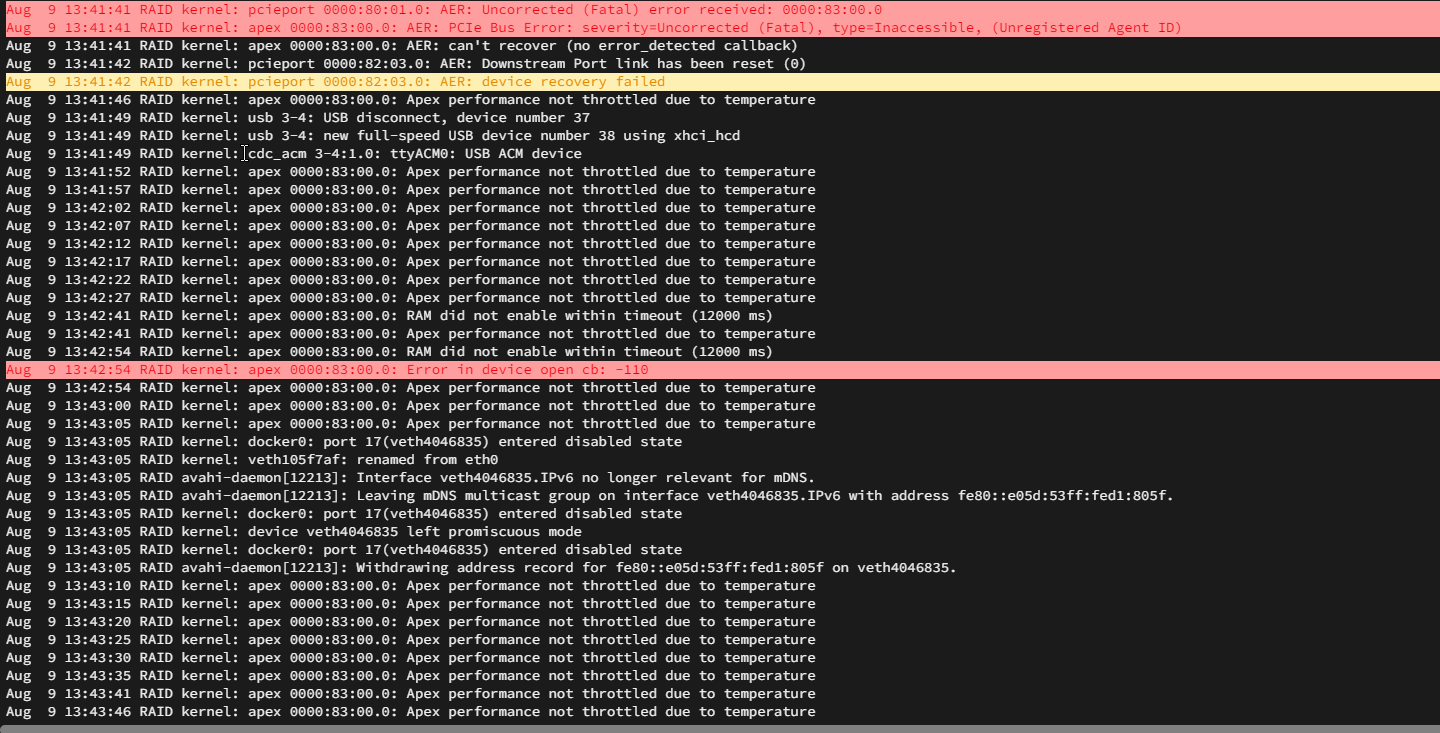

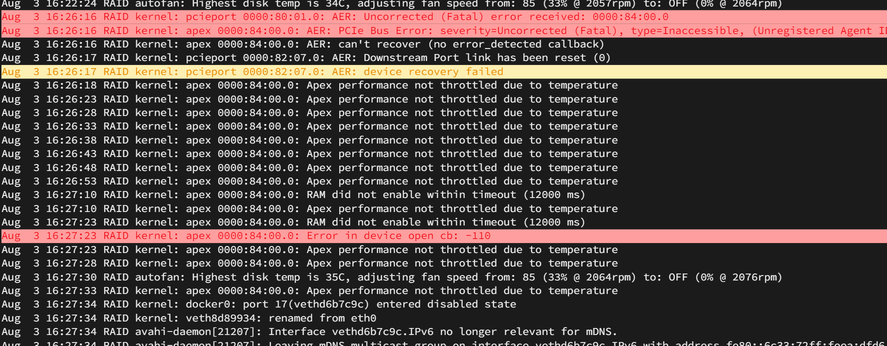

I have an issue with a coral TPU (Mini PCIe) that's on a Mini PCIe to PCI-E card plugged into a PCI Express slot. It will randomly shut down  and I need to restart the server to get it back, I used the script for temperature and it's not getting hot (I have put a heatsink and fan on the TPU). Here is the readings from the script :

I'm assuming the reason for the negative temperature is because of the shutdown, I cannot see any fault in the logs other than :
Aug  7 12:49:40 Tower kernel: apex 0000:05:00.0: Apex performance not throttled due to temperature
Aug  7 12:49:45 Tower kernel: apex 0000:05:00.0: Apex performance not throttled due to temperature
Aug  7 12:49:50 Tower kernel: apex 0000:05:00.0: Apex performance not throttled due to temperature
Aug  7 12:49:55 Tower kernel: apex 0000:05:00.0: Apex performance not throttled due to temperature
Aug  7 12:50:00 Tower kernel: apex 0000:05:00.0: Apex performance not throttled due to temperature
Over and over until the server is reset. Any idea what's happening?
Thanks.

@ich777 any idea? It can be a faulty one?
15 hours ago, luixmod said:
how can i add nvidia codec to the config file? everytime i add hwaccel_args: -c:v h264_cuvid i get the green screen on the cameras! i think i am doing right but maybe i am missing something
Are you running the nvidia version? Did you install the nvidia plugin on unraid? Did you read this?
You can try to disable the shutdown from the module but be aware that you have to monitor the temperature on your own since even Google mentions in their documentation that the TPUs can be a fire hazard...
It is also possible that your temperature sensor on the TPU is defective.
To disable the shutdown execute the following line from an Unraid terminal:
sed -i "/shutdown_en0=/c\shutdown_en0=0" /boot/config/plugins/coral-driver/settings.cfg
and restart your server afterwards.

I am having a similar issue to @AdvancedMobileRepairs Using the Dual TPU in Magic-Blue-smoke PCIe adapter. Prior to this I was using a single TPU with a different adapter that was working fine. I have been monitoring the Coral Temperatures at they have not been going above 48 Degrees. I have this error in my syslog:
If anyone has any insight into this? I already asked in the Frigate github and we troubleshooted to a point but then they told me to ask in the unraid forum.
Thank you
EDIT EDIT:
Per this thread:
I disabled ASPM on PCIe in my BIOS. restarted server and running frigate to see how long it works before the coral shuts down.
Edited by ssjucrono
And it failed again! That did not fix the issue. very weird
Temp is not the issue it seems
Anyone have any insight?
For me looks like a faulty temp. sensor
