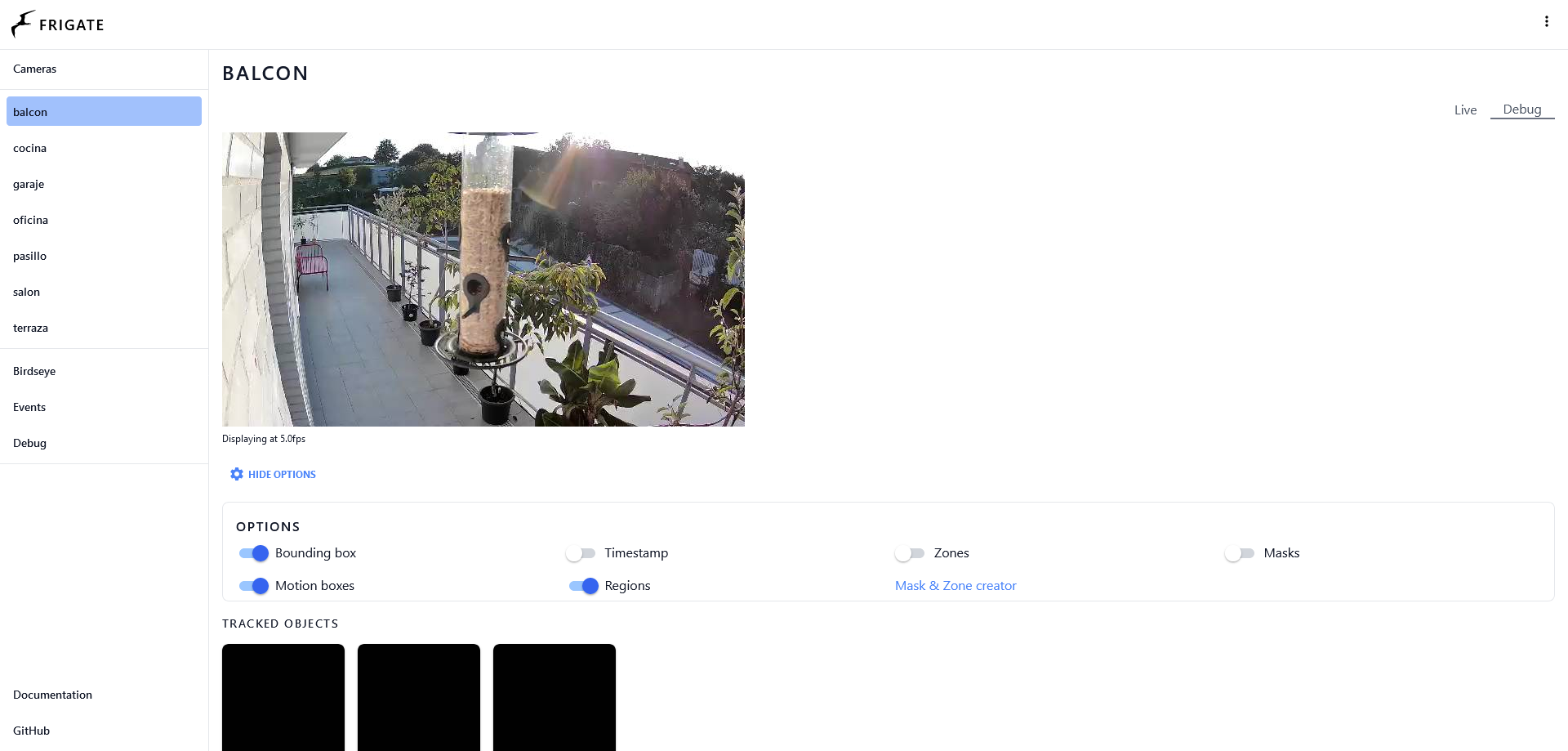

16 hours ago, yayitazale said:
Wow nice spider web... You need to hit the Debug button at top right:
Thanks that worked :)

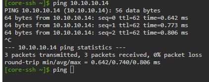

I'm trying to get the home assustant frigate plugin to work but it's not connecting
Log Details (ERROR)
This error originated from a custom integration.
Logger: custom_components.frigate.api
Source: custom_components/frigate/api.py:51
Integration: frigate (documentation, issues)
First occurred: 17:24:59 (1 occurrences)
Last logged: 17:24:59
Timeout error fetching information from http://10.10.10.14:5000/api/stats:
The ip is reachable from home assistant -
any ideas?

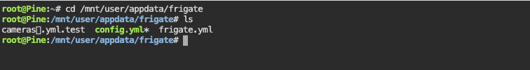

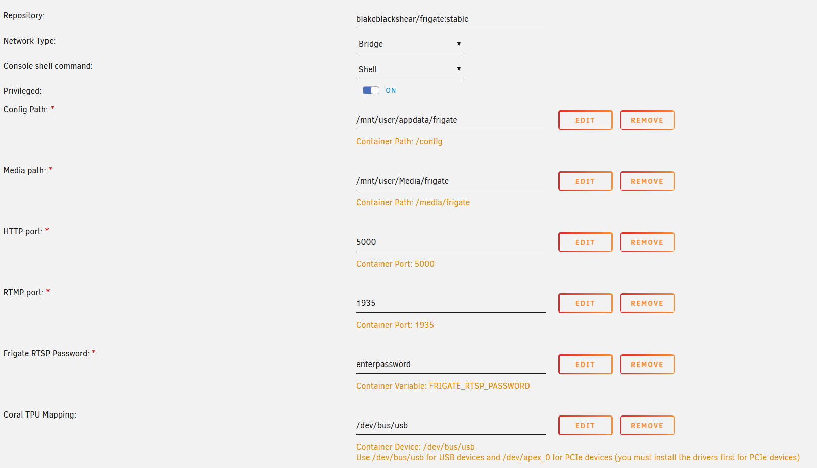

 Hi , I have just  followed the instruction Breaking Changes Removed the app and installed the latest. Now  Frigate will not load Executive Error. everything was fine before , reverted back to 0.11.0 RC1 and still have the same . There are no logs to advice what the problem is. Could you give me some guidance please.
Are you pointing to the right path of config file? Are your port not allocated in another container?

 Yes but when i look at the path  as below my config is there but when i look in the container it isn't.273861868_Screenshot2022-09-23at11_04_36.png.76da9e556eb3e8e3e4e209b100aff181.png
Can you post your container config image?
37 minutes ago, yayitazale said:
Can you try to run it deleting the --gpus=all entry on extra parameters?
Thanks a lot.  That started the docker container...
Ok I will change the template for not nvidia users and point it in the docs
please see attached,
