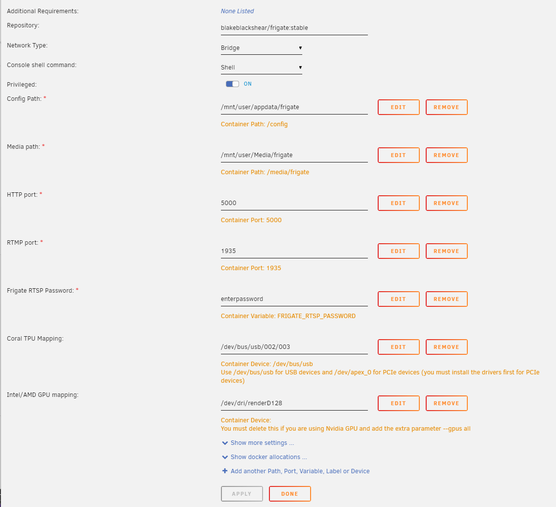

4 minutes ago, yayitazale said:
I was asking for a image of the container itself like so:
sorry

43 minutes ago, mikey6283 said:
sorry
As I see you are not using nvidia, so can you delete the extra parameter --gpus=all switching to the advanced view mode in there.
 Sorry but i am unsure which parameter  to delete ? is it the intel AMD gpu mapping ?
22 minutes ago, yayitazale said:
 Thank you started, now i need to sort the Config out.

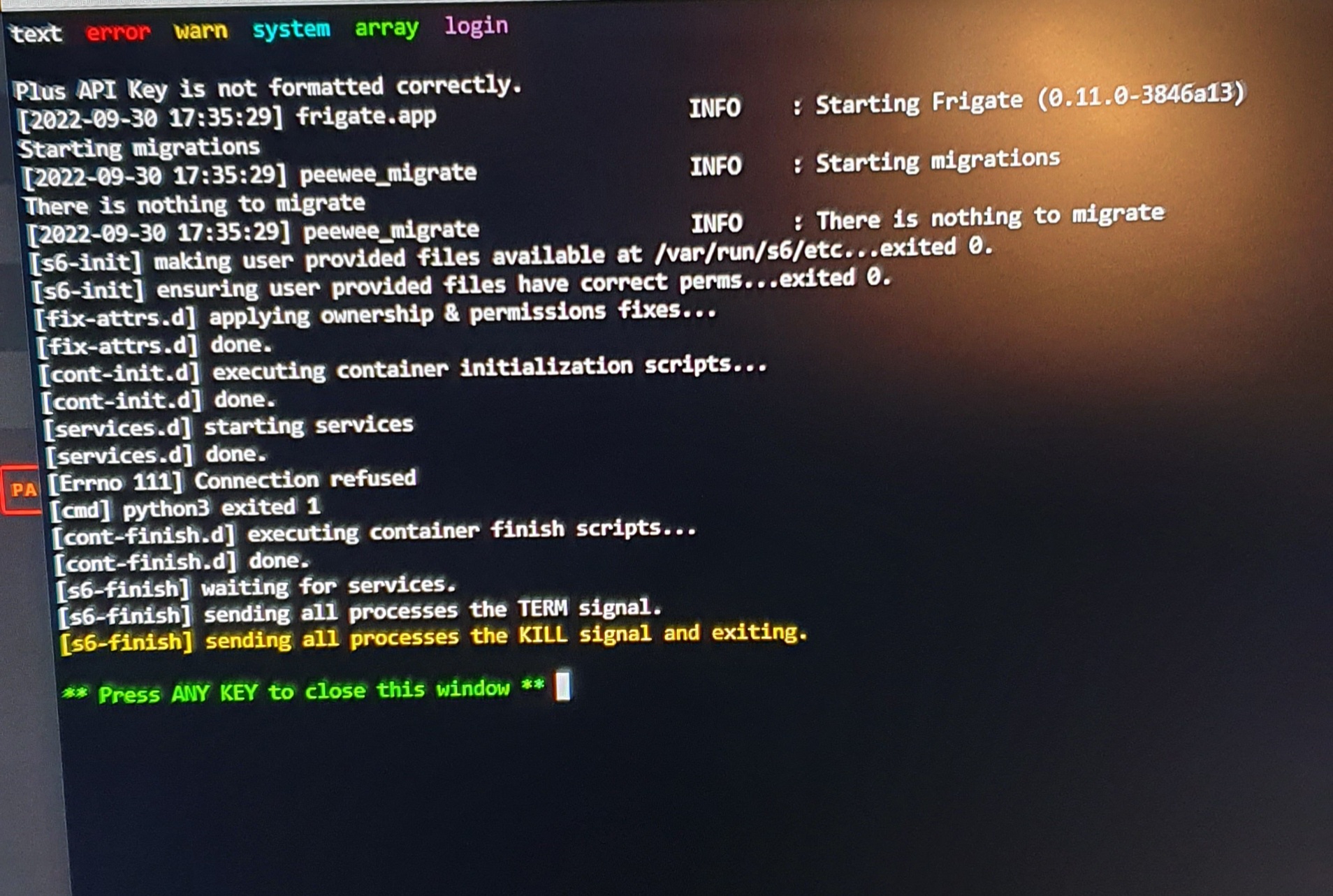

Hi eveybody,
I would like to try Frigate but i cannot get it up and running. I am not using Home Assistant but iobroker and like to use the mqtt server provided by iobroker. Please find my config attached.
Edited by robse
Attached log
59 minutes ago, robse said:
Hi eveybody,
I think the problem is the port, you have to declare it below the IP with the entry "port: 1884" (or just not declare it as you are using the default port), but maybe you have more things to fix. I suggest you for a easier start at the beginning to use the complete example config.yml example of the docs as a template:
https://docs.frigate.video/configuration/index
Edited by yayitazale
Thanks, the problem was the port declaration.

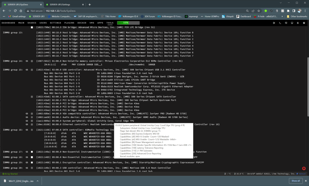

I've installed it OK into the hardware and it is seen by the PCIe bus. (see image below)
The apex and gasget drivers are installed. (see below)
BUT the apex drivers dont seem to recognise the Coral card and so it doesnt load for frigate.
The drivers from @ich777 are just saying "No PCI based Coral TPU Devices found!"  (which isnt a surprise because I can see the Apex driver isnt recognising the card.
Nov  3 21:18:34 SERVER-UR1 kernel: apex 0000:05:00.0: Cannot get BAR2 base address
Nov  3 21:18:34 SERVER-UR1 kernel: apex 0000:05:00.0: error adding gasket device
Nov  3 21:18:34 SERVER-UR1 kernel: ahci 0000:07:00.0: SSS flag set, parallel bus scan disabled
Nov  3 21:18:34 SERVER-UR1 kernel: ccp 0000:09:00.1: psp enabled
Nov  3 21:18:34 SERVER-UR1 kernel: apex: probe of 0000:05:00.0 failed with error -12
You are facing a completely different issue here, please make sure that you got Above 4G Decoding in your BIOS enabled the driver is working but your hardware has some difficult enabling it or better speaking allocating/finding the address space for the TPU.
Please post your Diagnostics for further help and enable the above mentioned option in the BIOS.

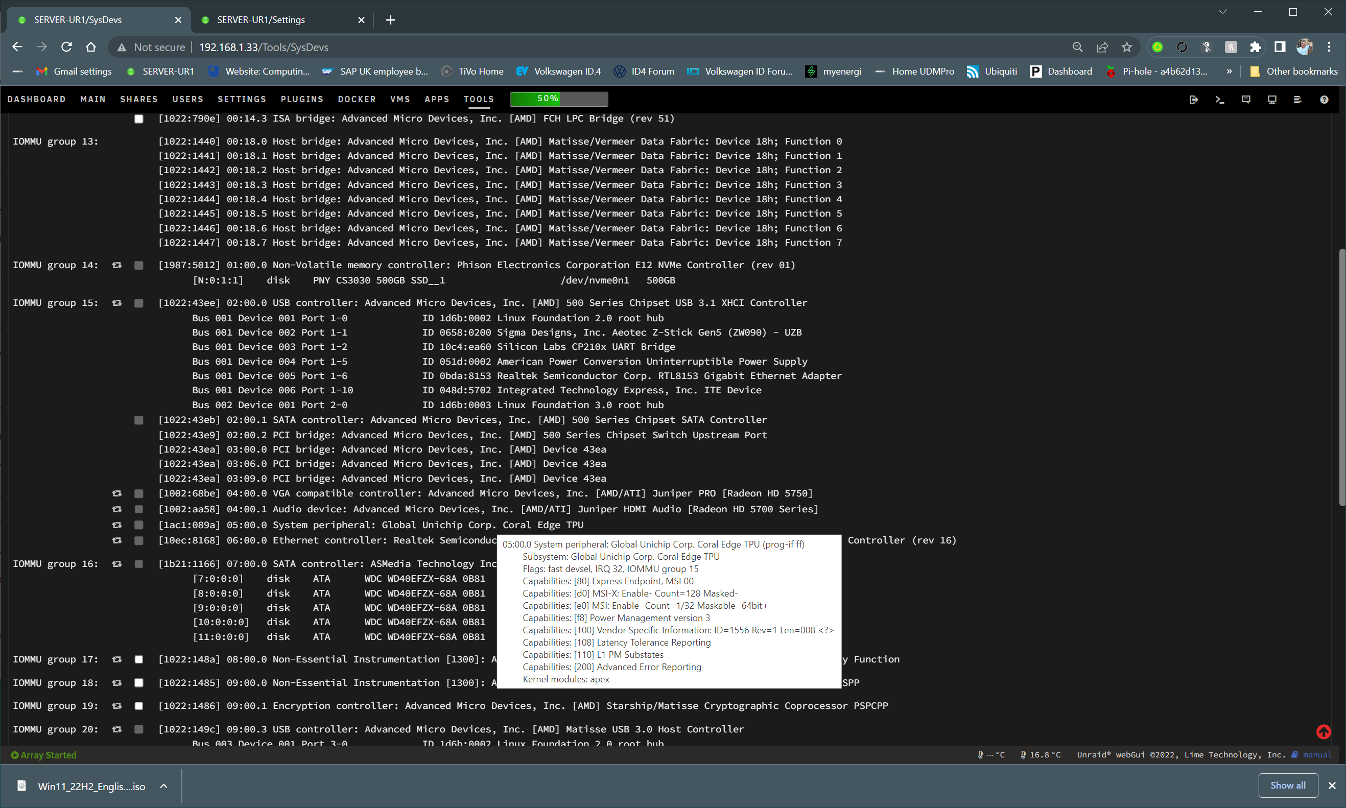

@ich777OK so i ordered and installed a more expensive StarTech PCIe to Mini PCIe adaptor card and have the same problem.
Driver doesnt see a PCIe card, and as you said the route of the problem is the Above4G not working.
This is seen by the error "Cannot get BAR2 base address"
So the coral card is recognised on the bus, but the driver cant find it to address it.
The motherboard is a Gigabyte b550m DS3H with F/w F15a from march 2022, there is a newer version but I know that wont make any difference, so I havent flashed it yet.
Above4G decoding is enabled and Re-size BAR support is set to Auto (the other option is disabled)
Ive also left the PCIEX16 bifurcation to Auto rather than setting the lanes to a fixed setting.
Any pointers you can provide to help???  Im kind of at a loss because I've never seen this type of problem before.
thanks in advance.
R.
server-ur1-diagnostics-20221108-2245.zip
Right!  I fixed it!!!
I just tried a different slot... which was obvious really.
I was using the PCIe X1 slot and then I moved it to the PCIe X16 slot.
I wasnt using the PCIe X16 because the hd controller board was in that slot!
Big Doh!  from me.
Shout out to Brian H. because it was his post that gave me the clue.
