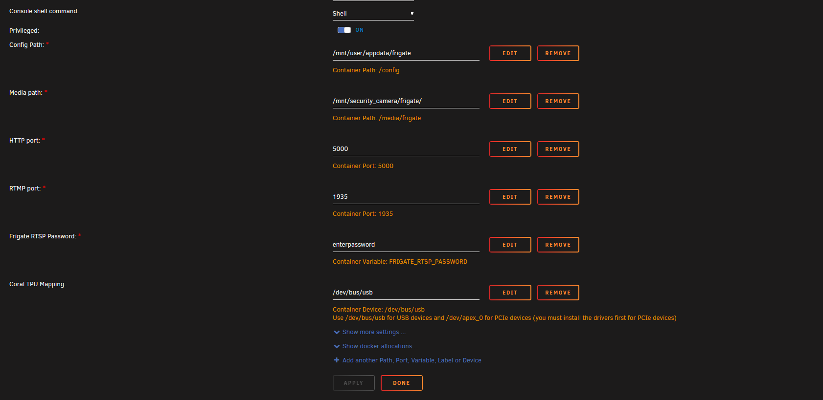

I have been unable to get recordings to work at all. Detection, events and clips are working fine. I have reduced my config to minimal settings in an attempt to find the issue but no luck so far. I have also tried normal rtsp streams and the reolink specific configuration. Any help would be greatly appreciated. Thanks!
Unraid version 6.11.3

You have a 0 day retention policy for records, witch means:
"When retain -> days is set to 0, segments will be deleted from the cache if no events are in progress."
https://docs.frigate.video/configuration/record#what-if-i-dont-want-247-recordings
With your configuration, only events will be saved.

That makes sense, thanks. I changed the retention to 14 days  and still no recording.  I am OK with 24/7 recordings or a very long retention period actually (that is how I had blue iris set up) and I have 4 TB of storage dedicated to security footage.
Do you see anything wrong with my config that would prevent ANY recordings from working? I have never had a single recording from an event or otherwise.
Thanks
Thanks
Do you have any error on the logs?

I do seem to be having ffmpeg errors... any advice?
I am not seeing the same errors in newer log entries. The previous entries looked to be using the non-reolink settings.

My frigate instance has been crashing recently.  Looking for some guidance.  Should I switch over to the new beta release?  Here are the logs from a start and eventual crash:

[2023-02-02 15:29:20] frigate.app INFO : Starting Frigate (0.11.1-2eada21)
Starting migrations
[2023-02-02 15:29:20] peewee_migrate INFO : Starting migrations
There is nothing to migrate
[2023-02-02 15:29:20] peewee_migrate INFO : There is nothing to migrate
[2023-02-02 15:29:20] detector.coral INFO : Starting detection process: 256

Frigate was working so well on UNRAID with my wyze cams and no CORAL, but  it stopped working few weeks ago, this is what I see in the logs:
text  error  warn  system  array  login
[2023-02-13 15:39:27] frigate.video                  ERROR   : garden2: ffmpeg process is not running. exiting capture thread...
[2023-02-13 15:39:27] frigate.video                  ERROR   : frontyard: Unable to read frames from ffmpeg process.
[2023-02-13 15:39:27] frigate.video                  ERROR   : garage: ffmpeg process is not running. exiting capture thread...
[2023-02-13 15:39:27] frigate.video                  ERROR   : frontyard: ffmpeg process is not running. exiting capture thread...
[2023-02-13 15:39:32] ws4py                          INFO    : Managing websocket [Local => 127.0.0.1:5002 | Remote => 127.0.0.1:53244]
[2023-02-13 15:39:34] watchdog.frontyard             ERROR   : Ffmpeg process crashed unexpectedly for frontyard.
[2023-02-13 15:39:34] watchdog.frontyard             ERROR   : The following ffmpeg logs include the last 100 lines prior to exit.
[2023-02-13 15:39:34] ffmpeg.frontyard.detect        ERROR   : [tcp @ 0x55f1ef216240] Connection to tcp://192.168.20.125:554?timeout=5000000 failed: No route to host
[2023-02-13 15:39:34] ffmpeg.frontyard.detect        ERROR   : rtsp://XXXX:[email protected]/live: No route to host
[2023-02-13 15:39:34] watchdog.garage                ERROR   : Ffmpeg process crashed unexpectedly for garage.
[2023-02-13 15:39:34] watchdog.garage                ERROR   : The following ffmpeg logs include the last 100 lines prior to exit.
[2023-02-13 15:39:34] ffmpeg.garage.detect           ERROR   : [tcp @ 0x55cacbc1f240] Connection to tcp://192.168.20.53:554?timeout=5000000 failed: No route to host
[2023-02-13 15:39:34] ffmpeg.garage.detect           ERROR   : rtsp://XXXXX:[email protected]/live: No route to host
[2023-02-13 15:39:34] watchdog.garden2               ERROR   : Ffmpeg process crashed unexpectedly for garden2.
[2023-02-13 15:39:34] watchdog.garden2               ERROR   : The following ffmpeg logs include the last 100 lines prior to exit.
[2023-02-13 15:39:34] ffmpeg.garden2.detect          ERROR   : [tcp @ 0x5557daca5240] Connection to tcp://192.168.20.191:554?timeout=5000000 failed: No route to host
[2023-02-13 15:39:34] ffmpeg.garden2.detect          ERROR   : rtsp://XXX:[email protected]/live: No route to host
[2023-02-13 15:39:37] frigate.video                  ERROR   : frontyard: Unable to read frames from ffmpeg process.
[2023-02-13 15:39:37] frigate.video                  ERROR   : garden2: Unable to read frames from ffmpeg process.
[2023-02-13 15:39:37] frigate.video                  ERROR   : frontyard: ffmpeg process is not running. exiting capture thread...
[2023-02-13 15:39:37] frigate.video                  ERROR   : garden2: ffmpeg process is not running. exiting capture thread...
[2023-02-13 15:39:37] frigate.video                  ERROR   : garage: Unable to read frames from ffmpeg process.
[2023-02-13 15:39:37] frigate.video                  ERROR   : garage: ffmpeg process is not running. exiting capture thread...
[2023-02-13 15:39:44] watchdog.garage                ERROR   : Ffmpeg process crashed unexpectedly for garage.
[2023-02-13 15:39:44] watchdog.frontyard             ERROR   : Ffmpeg process crashed unexpectedly for frontyard.
[2023-02-13 15:39:44] watchdog.garage                ERROR   : The following ffmpeg logs include the last 100 lines prior to exit.
[2023-02-13 15:39:44] watchdog.frontyard             ERROR   : The following ffmpeg logs include the last 100 lines prior to exit.
[2023-02-13 15:39:44] watchdog.garden2               ERROR   : Ffmpeg process crashed unexpectedly for garden2.
[2023-02-13 15:39:44] ffmpeg.garage.detect           ERROR   : [tcp @ 0x556c74d47240] Connection to tcp://192.168.20.53:554?timeout=5000000 failed: No route to host
[2023-02-13 15:39:44] ffmpeg.frontyard.detect        ERROR   : [tcp @ 0x55b22779b240] Connection to tcp://192.168.20.125:554?timeout=5000000 failed: No route to host
[2023-02-13 15:39:44] ffmpeg.garage.detect           ERROR   : rtsp://XXX:[email protected]/live: No route to host
[2023-02-13 15:39:44] ffmpeg.frontyard.detect        ERROR   : rtsp://XXXX:[email protected]/live: No route to host
[2023-02-13 15:39:44] watchdog.garden2               ERROR   : The following ffmpeg logs include the last 100 lines prior to exit.
[2023-02-13 15:39:44] ffmpeg.garden2.detect          ERROR   : [tcp @ 0x55b6a4ac6240] Connection to tcp://192.168.20.191:554?timeout=5000000 failed: No route to host
[2023-02-13 15:39:44] ffmpeg.garden2.detect          ERROR   : rtsp://XXXX:[email protected]/live: No route to host
[2023-02-13 15:39:47] frigate.video                  ERROR   : garage: Unable to read frames from ffmpeg process.
[2023-02-13 15:39:47] frigate.video                  ERROR   : garden2: Unable to read frames from ffmpeg process.
[2023-02-13 15:39:47] frigate.video                  ERROR   : frontyard: Unable to read frames from ffmpeg process.
[2023-02-13 15:39:47] frigate.video                  ERROR   : frontyard: ffmpeg process is not running. exiting capture thread...
[2023-02-13 15:39:47] frigate.video                  ERROR   : garage: ffmpeg process is not running. exiting capture thread...
[2023-02-13 15:39:47] frigate.video                  ERROR   : garden2: ffmpeg process is not running. exiting capture thread...
[2023-02-13 15:39:54] watchdog.garage                ERROR   : Ffmpeg process crashed unexpectedly for garage.
[2023-02-13 15:39:54] watchdog.garage                ERROR   : The following ffmpeg logs include the last 100 lines prior to exit.
[2023-02-13 15:39:54] ffmpeg.garage.detect           ERROR   : [tcp @ 0x564047538240] Connection to tcp://192.168.20.53:554?timeout=5000000 failed: No route to host
[2023-02-13 15:39:54] ffmpeg.garage.detect           ERROR   : rtsp://XXXX:[email protected]/live: No route to host
[2023-02-13 15:39:54] watchdog.frontyard             ERROR   : Ffmpeg process crashed unexpectedly for frontyard.
[2023-02-13 15:39:54] watchdog.frontyard             ERROR   : The following ffmpeg logs include the last 100 lines prior to exit.
[2023-02-13 15:39:54] ffmpeg.frontyard.detect        ERROR   : [tcp @ 0x5601e680a240] Connection to tcp://192.168.20.125:554?timeout=5000000 failed: No route to host
[2023-02-13 15:39:54] ffmpeg.frontyard.detect        ERROR   : rtsp://XXXX:[email protected]/live: No route to host
[2023-02-13 15:39:54] watchdog.garden2               ERROR   : Ffmpeg process crashed unexpectedly for garden2.
[2023-02-13 15:39:54] watchdog.garden2               ERROR   : The following ffmpeg logs include the last 100 lines prior to exit.
[2023-02-13 15:39:54] ffmpeg.garden2.detect          ERROR   : [tcp @ 0x55d00efb0240] Connection to tcp://192.168.20.191:554?timeout=5000000 failed: No route to host
[2023-02-13 15:39:54] ffmpeg.garden2.detect          ERROR   : rtsp://XXXX:[email protected]/live: No route to host
[2023-02-13 15:39:57] frigate.video                  ERROR   : garden2: Unable to read frames from ffmpeg process.
[2023-02-13 15:39:57] frigate.video                  ERROR   : garden2: ffmpeg process is not running. exiting capture thread...
[2023-02-13 15:39:57] frigate.video                  ERROR   : garage: Unable to read frames from ffmpeg process.
[2023-02-13 15:39:57] frigate.video                  ERROR   : frontyard: Unable to read frames from ffmpeg process.
[2023-02-13 15:39:57] frigate.video                  ERROR   : garage: ffmpeg process is not running. exiting capture thread...
[2023-02-13 15:39:57] frigate.video                  ERROR   : frontyard: ffmpeg process is not running. exiting capture thread...
[2023-02-13 15:39:58] ws4py                          INFO    : Terminating websocket [Local => 127.0.0.1:5002 | Remote => 127.0.0.1:53244]
