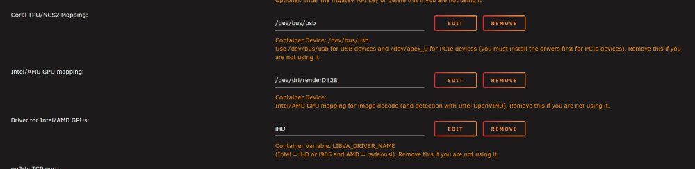

so after getting everything up and running I have added another GPU into my server to use with a VM.  so i have changed the config of my docker I have added the below
and then the following two parameters
I have added the correct ID for the GPU but for some reason its using the other GPU what have i done wrong?
Please open a issue in github to the main developers as in the docs they only "support" the --gpus=all extra paramateres.
https://github.com/blakeblackshear/frigate/issues

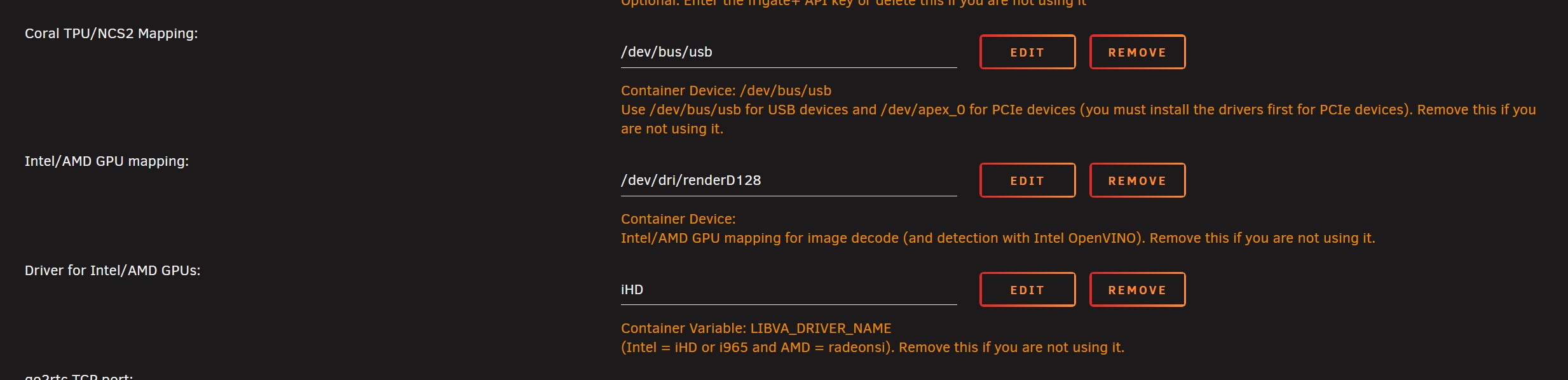

Ever since I installed the Coral Accelerator Module Drivers plugin and the m.2 Google Coral, my entire server has been crashing constantly.  I went ahead and removed the Google Coral and uninstalled the plugin, but it keeps happening still.  Is there any reason why this would be happening?  Is there anything lingering from the plugin install that I can remove?
Can you attatch a diagnostic file?
