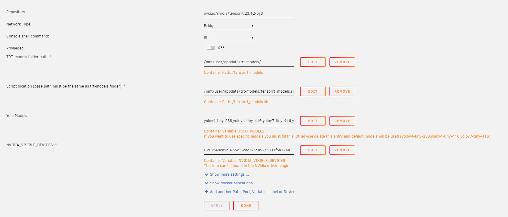

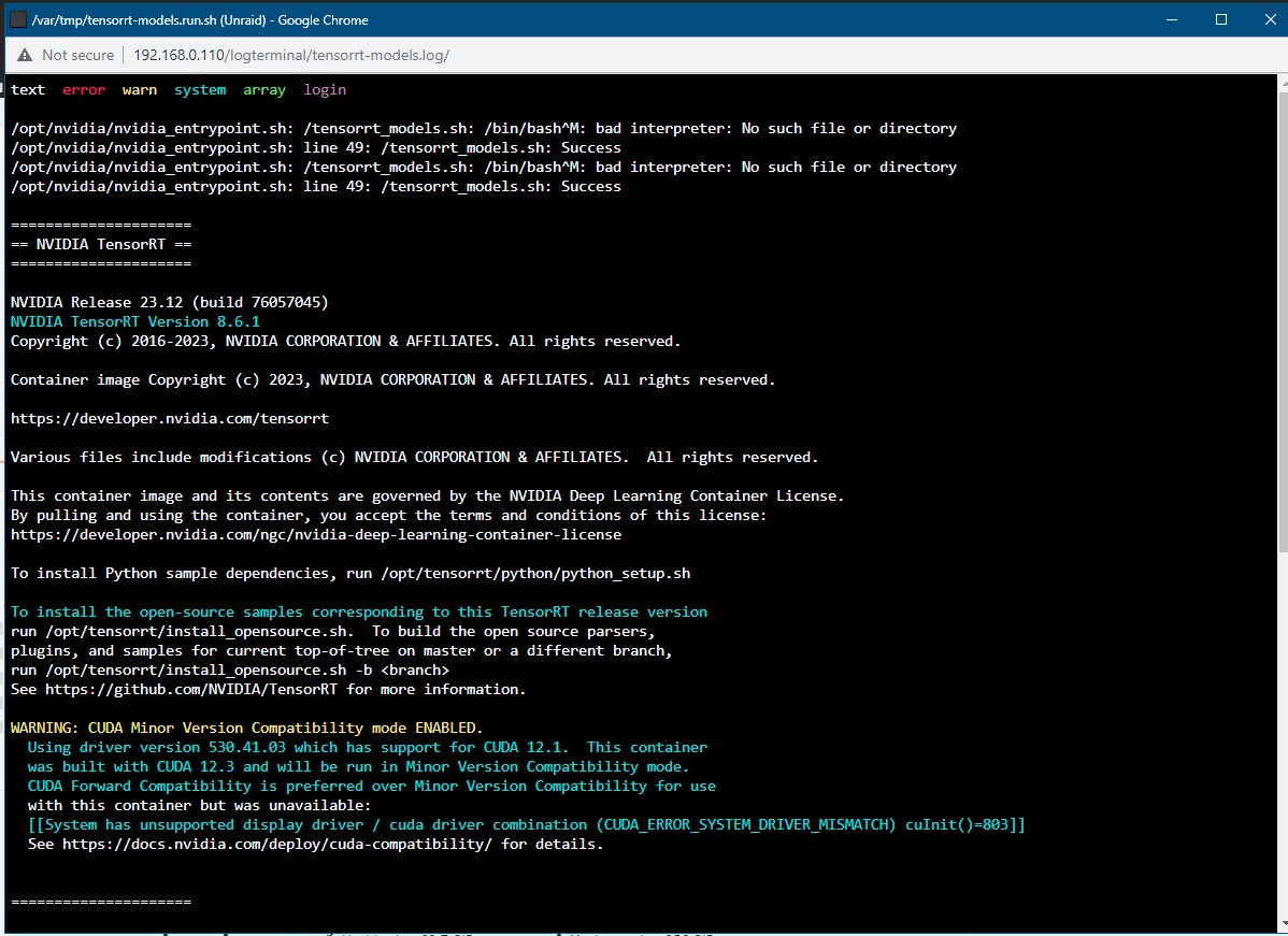

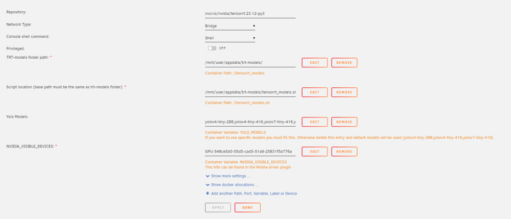

I am trying to get started with the Tensorrt-models docker container and have set it up as below with the script,
have did the "chmod +x /mnt/user/appdata/trt-models/tensorrt_models.sh" and when running the container I get the error below:
/opt/nvidia/nvidia_entrypoint.sh: /tensorrt_models.sh: /bin/bash^M: bad interpreter: No such file or directory
/opt/nvidia/nvidia_entrypoint.sh: line 49: /tensorrt_models.sh: Success
any ideas what I am doing wrong?
Do you have the /mnt/user/appdata/trt-models folder mapped already to frigate and frigate running? If yes, please stop frigate, run this container and then restar frigate.
Yes its mapped to frigate, I've stopped the frigate container and started the Tensorrt-models docker and it the same error that pops up. Is there something else I am missing?
Maybe you have to download the sh again or try another path. Anyway, don't waste too much time on this, the next frigate versión witch will be released very soon will have the tensor model integrated inside the container, so what you are doing will be in vain. I suggest you to wait some weeks and use this feature in the frigate v13.
