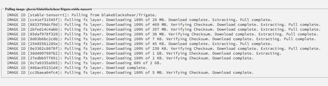

2 hours ago, yayitazale said:
Can you post the error?
Sure thing. For fun I put the shim to 16GB (--shm-size=16gb); same error.
Error: failed to register layer: write /usr/local/cuda/targets/x86_64-linux/lib/libcublasLt.so.12.1.0.26: no space left on device
CUDA would point to the graphics card.  My config currently has all the related nvidia gpu related settings defined in the container.
I suggest you to open a issue https://github.com/blakeblackshear/frigate/issues I cannot help you with this error.

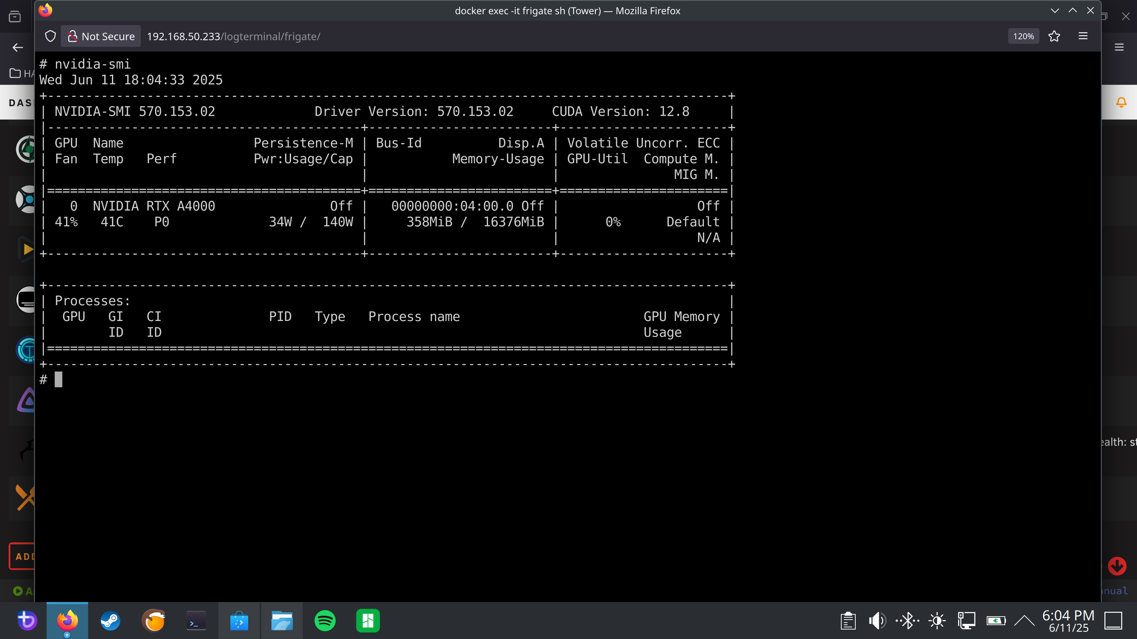

So I was previously running a frigate instance with a quadro p1000 and a reolink doorbell with no problems but lost the config when I changed to an rtx a4000. I tried to generate a new config and it seems to be in a restart loop. anyone can help?
config:
mqtt:
host: 192.168.50.5
user: frigatemqtt
password: xxxxxxxxxxx
detectors:
tensorrt:
type: tensorrt
device: 0
model:
path: /config/model_cache/tensorrt/8.5.3/yolov7-tiny-416.trt
input_tensor: nchw
input_shape: [1, 3, 416, 416]
go2rtc:
streams:
doorbell:
- "ffmpeg:http://192.168.50.19/flv?port=1935&app=bcs&stream=channel0_main.bcs&user=xxxxxxxxxxxxxx&password=xxxxxxxxxxx#video=copy#audio=copy#audio=opus"
- rtsp://192.168.50.19/Preview_01_sub
doorbell_sub:
- "ffmpeg:http://192.168.50.19/flv?port=1935&app=bcs&stream=channel0_ext.bcs&user=xxxxxxxxxxxxx&password=xxxxxxxxxxxxx"
cameras:
doorbell:
ffmpeg:
inputs:
- path: rtsp://127.0.0.1:8554/doorbell
input_args: preset-rtsp-restream
roles:
- record
- path: rtsp://127.0.0.1:8554/doorbell_sub
roles:
- detect
detect:
width: 416
height: 416
fps: 5
snapshots:
enabled: true
timestamp: true
bounding_box: true
retain:
default: 2
record:
enabled: true
retain:
days: 7
mode: motion
logs

Correct if I'm wrong but in the logs it mentions some gpu stats for a few seconds before the python segmentation fault, doesn't it mean that is being used? Also, on the frigate gui I could see rtx a4000 utilization on the bottom.
I'm using the Nvidia Driver Version: 570.153.02 from the production branch, I'm using the tensorrt branch and already added the --runtime=nvidia , corrected the tensorrt part like you recommended and I'm still getting the same error...
I also ran nvidia-smi and it seems fine I think
EDIT: don't really know if there is anything else I have to do regarding gpu passthrough
Edited by renk1
While browsing closed issues on github I saw some reports of users pointing that they could only run models up to 320 so I changed to yolov7-320 and it seems to be stable. thanks @yayitazale

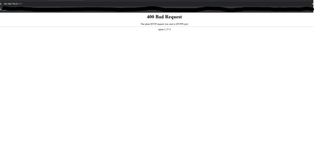

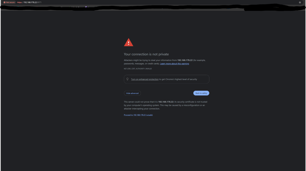

4 minutes ago, NoRaid99 said:
Thanks a lot for your helpfull answers, that is very kind.
about point 2:
I found the docs for auth and I can login with credentials on port 8971. But the problem is that port 5000 is allways open to reach GUI. I created a new container without the port 5000 setting variale, but it is still set and open.
Is there a way to block this port? Otherwise it doesn't seem to make much sense for me.
(Perhaps it makes a difference that I have the container connectet to "eth" and gaved him his own IP.)

I'm having an issue where I click "install" on the docker image, fill out all of the info and then when it's pulling down the images it seems to hang on one part and never completes. Has anyone else run into something like that?

I guess your Docker image is not big enough for the tensorrt image. Go to Settings > Docker, then disable Docker and increase the Docker Image Size to at least 8GB. This tensort version of frigate requires at least 4-5GB.
I use a disk, not an image so size isn't an issue, it does have plenty of space.
I don't know what issue can you have then.
Hey all,
Testing our Frigate in Unraid to see if it meets my needs and it seems like my NVIDIA 2060 isn't being used for encoding/decoding and I was wondering if someone could offer a hand? Been pouring over docs, posts, etc the last few days so I'm probably a little blind to a resolution at this point.
I'll share some configs below:
Frigate config:
mqtt:
  enabled: true
  host: 192.168.0.200
  user: '{FRIGATE_MQTT_USER}'

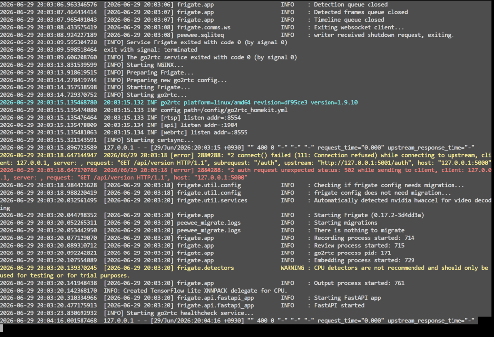

2025-07-25 19:54:17.961952591 [INFO] Preparing Frigate...
2025-07-25 19:54:18.040549921 [INFO] Starting Frigate...
2025-07-25 19:54:19.729201612 [2025-07-25 19:54:19] frigate.util.config INFO : Checking if frigate config needs migration...
2025-07-25 19:54:19.742543992 [2025-07-25 19:54:19] frigate.util.config INFO : frigate config does not need migration...
2025-07-25 19:54:19.767363875 [2025-07-25 19:54:19] frigate.app INFO : Starting Frigate (0.15.2-3bda638)
2025-07-25 19:54:19.768138686 [2025-07-25 19:54:19] frigate.util.services INFO : Current file limits - Soft: 40960, Hard: 40960
2025-07-25 19:54:19.768170646 [2025-07-25 19:54:19] frigate.util.services INFO : File limit set. New soft limit: 40960, Hard limit remains: 40960
2025-07-25 19:54:19.775210832 [2025-07-25 19:54:19] peewee_migrate.logs INFO : Starting migrations
2025-07-25 19:54:19.775866648 [2025-07-25 19:54:19] peewee_migrate.logs INFO : There is nothing to migrate
2025-07-25 19:54:19.789804641 [2025-07-25 19:54:19] frigate.app INFO : Recording process started: 382
2025-07-25 19:54:19.800901647 [2025-07-25 19:54:19] frigate.app INFO : Review process started: 391
2025-07-25 19:54:19.802844921 [2025-07-25 19:54:19] frigate.app INFO : go2rtc process pid: 98
2025-07-25 19:54:19.819370203 [2025-07-25 19:54:19] detector.coral INFO : Starting detection process: 398
2025-07-25 19:54:19.836357536 [2025-07-25 19:54:19] frigate.app INFO : Output process started: 417
2025-07-25 19:54:19.864411136 [2025-07-25 19:54:19] frigate.app INFO : Camera processor started for testcam: 431
2025-07-25 19:54:19.885166805 [2025-07-25 19:54:19] frigate.app INFO : Capture process started for testcam: 439
2025-07-25 19:54:20.228884752 [2025-07-25 19:54:20] frigate.api.fastapi_app INFO : Starting FastAPI app
2025-07-25 19:54:20.320991177 [2025-07-25 19:54:20] frigate.api.fastapi_app INFO : FastAPI started
2025-07-25 19:54:22.445554555 [2025-07-25 19:54:19] frigate.detectors.plugins.edgetpu_tfl INFO : Attempting to load TPU as usb
2025-07-25 19:54:22.448760781 [2025-07-25 19:54:22] frigate.detectors.plugins.edgetpu_tfl INFO : TPU found
Running nvidia-smi in my unraid dashboard console:
Running nvidia-smi in my frigate docker console:
Nvidia Driver Version: 575.64.05
Appreciate any help in advance, ty ty!
