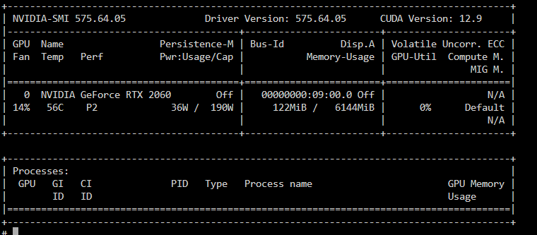

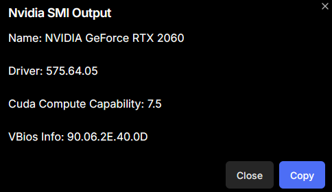

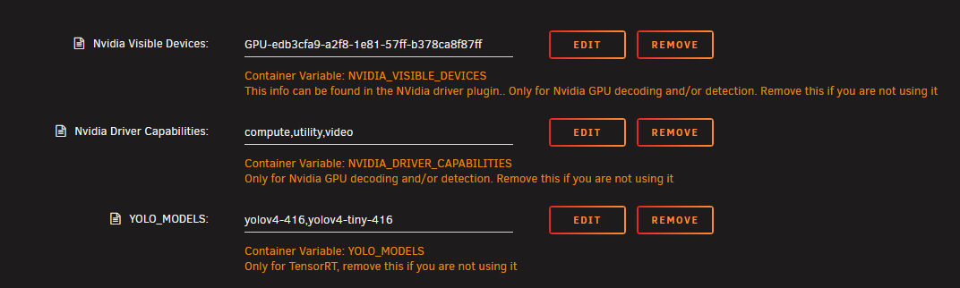

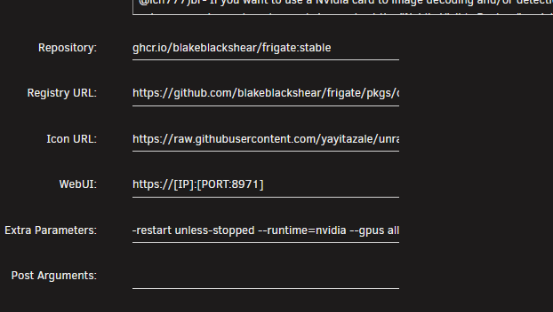

You don't need to use "--gpus all" as the GPU pass-through of a specific GPU to the container is done with the "nvidia visible devices" and "nvidia driver capabilities" variable. If you are using the GPU only for decoding/encoding then you can delete the YOLO_MODELS variable as this is only use for GPU detection.
What you can see about the GPU decoding in the logs of frigate? Is go2rtc working correctly?
Edited by yayitazale

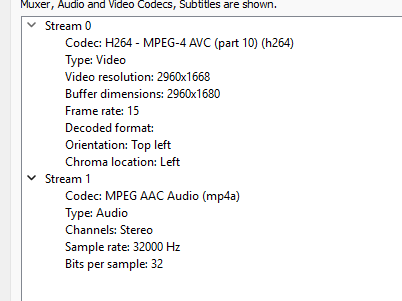

      - "ffmpeg:testcam#audio=aac#video=h264#encoder=h264_nvenc#width=1280#height=720#bitrate=2500k"

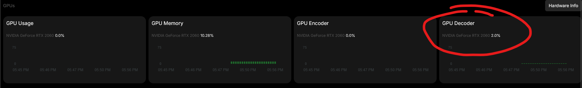

I can now see my GPU being used for decoding, but the stream to HA is back to the fullresolution stream from the camer, it seems the ffmpeg args aren't being applied to the stream? From VLC to rtsp://192.168.0.200:8554/testcam:

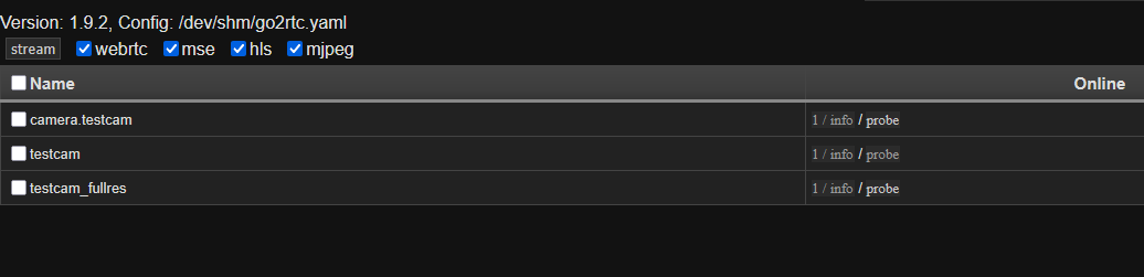

Edit 2:

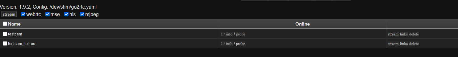

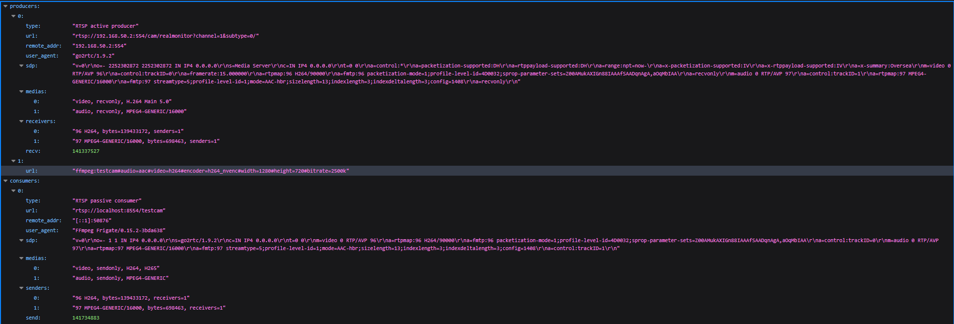

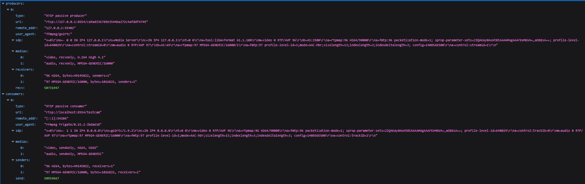

Checking go2rtc via port 1984, I see three streams:

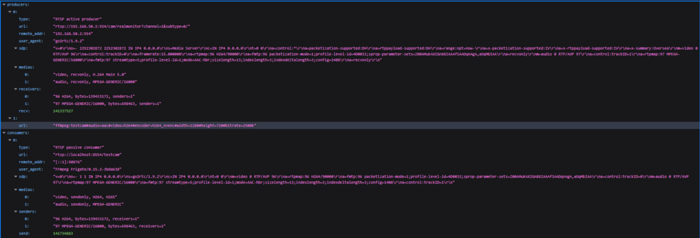

Checking the producer details of camera.testcam:
So the params seem to be on the URL? But theyre not transforming the stream?

Results in 2-stream in rtc
testcam (720p) shows:

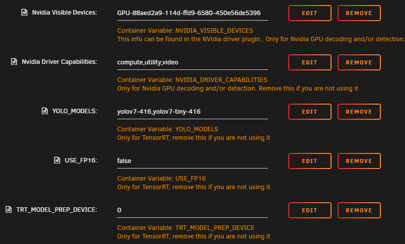

Hello,
Thanks for taking a look!
I've removed the YOLO_MODELS as well as the --gpus all extra parameter and it appears to be the same result - 0 gpu activity for encoding/decoding.
Regarding logging, this is all the information available to me in logs via Unraid, not sure why that is. As I interact with Frigate, via HA for example, I do see API request get logged, but not much else after startup, would you have any recommendations regarding additional logging? The Frigate UI returns the same logging statements:

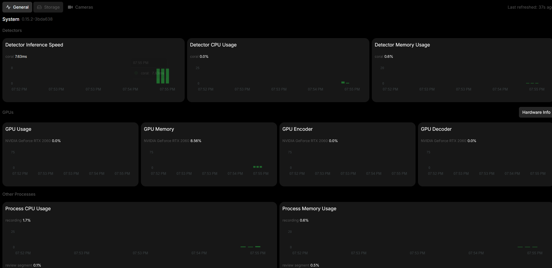

From within the Frigate metrics view:

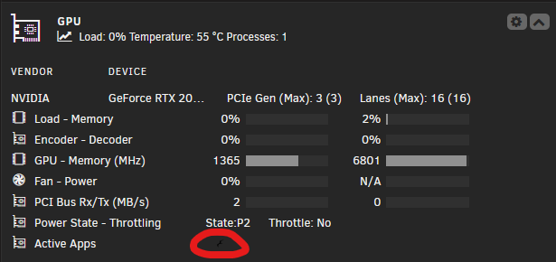

And from within Unraid dashboard:
So it definitely appears that the GPU is passed through to Frigate, and Frigate is connected but it just doesn't use the GPU for encode/decode which is why I leaned back towards an error in configuration.
I would echo your perspective and was hoping to see SOMETHING more in logs, the lack of information is definitely problematic, not sure why logs are so quiet

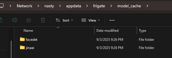

okay so I re-installed the tensor version. I am able to get it up and running and add a camera. It it showing the Nvidia GPU as passed through. This is the yolo version I have set in the template (however I've tried multiple versions and it never generates the models):
However, it's not loading any of the models in the appdata folder:
and if I try to add the tensorrt detector to my config, frigate just bootloops until I remove it
detectors:
tensorrt:
type: tensorrt
device: 0
do I need to manually create those model folders/files?
Edited by KittenMittons
detectors:
tensorrt:
type: tensorrt
device: 0
Did you added "--runtime=nvidia" as extra parameter under advanced view?
Yessir
22 minutes ago, KittenMittons said:
Yessir
And what do you see in the logs?

Unable to get GPU detector working on v16.
I just upgrade to v16 and I can no longer get my NVIDIA GPU to work as a detector. I tried keeping the tensorrt settings, but that just throws an error stating it's no longer support and causes the docker container to endlessly restart. I also tried changing it to onnx, but that also causes it to endlessly loop, and I have no idea how to get any models to work with it. The only way for me to keep the container up and running is by using a CPU detector, so I know the rest of the config should be good.
GPU: Nvidia RTX 2060
Docker Image: ghcr.io/blakeblackshear/frigate:stable-tensorrt
YOLO_MODELS: yolov7-320,yolov7x-640

From what I understand after reading the documentation, the generation of YOLO models for TensorRT is now only available for Jetson Nano.
In your case, you have to switch to use ONNX models, as explained here.
The usage of the tensorRT version is still needed, but you have to manually download and place the model.

When switching to ONNX, do I need to remove all the attributes that are listed in the unraid config that pertain to TensorRT?
2 hours ago, Professor Oak said:
That's what I was afraid of. I tried downloading/creating YOLO 3, 4, 7 and 9 models, but kept running into many issues. I'll see if I can take my time with it now since my deployment is currently stable.
Yes, they are already removed from the master template but will no make any difference to you until you reinstall the app, so the easiest way is just remove the entries.
