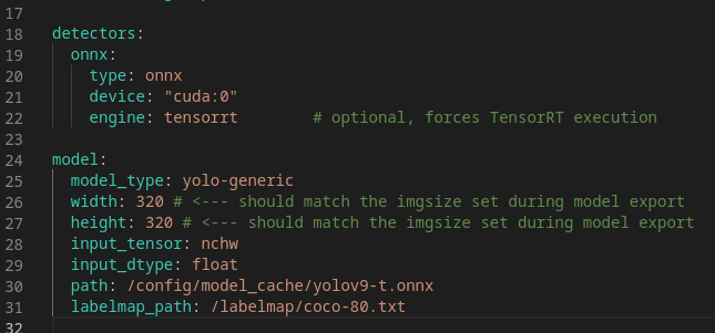

Don't you need this instead of type:cuda
detectors:
  onnx_0:
    type: onnx
	device: gpu

Hi! I'm trying a fresh install with an rtx a4000 and the yolox_m.onnx but I'm getting this error:
onnxruntime.capi.onnxruntime_pybind11_state.InvalidArgument: [ONNXRuntimeError] : 2 : INVALID_ARGUMENT : Unexpected input data type. Actual: (tensor(uint8)) , expected: (tensor(float))
any ideas why?
thanks
any ideas why?
thanks
You did not copy the required input_dtype config https://docs.frigate.video/configuration/object_detectors#yolo-v3-v4-v7-v9-1
detectors:
onnx:
type: onnx
gpu: true
input_tensor: nchw
input_dtype: float
num_threads: 2
model_path: /config/model_cache/yolox_m.onnx

Width and height missing... Copy the proposed configuration
