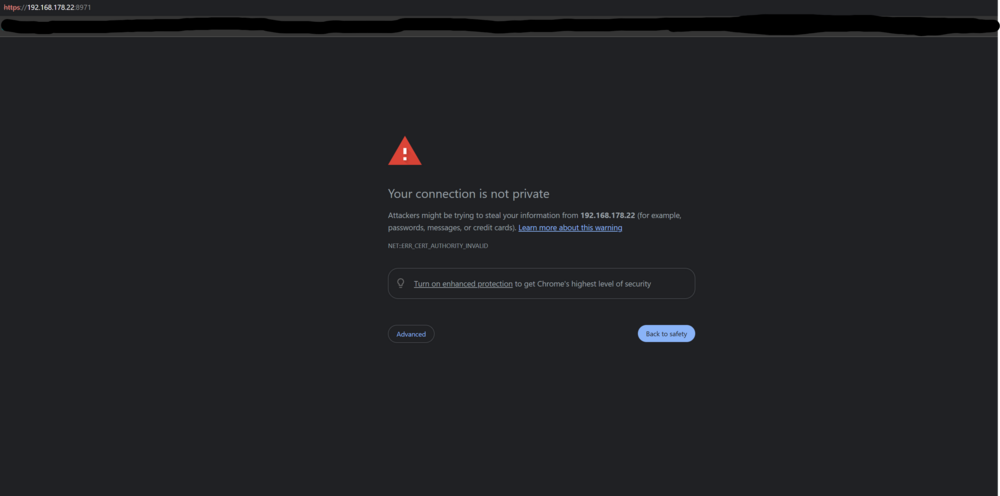

Thanks very much for the info, it really helped.
Just out of interest has there been an up in the last 20 odd hours that may have broken something?
Everything was working fine yesterday. Today I thought I would start from scratch like I have been doing over the past 3 days, but today Im getting the following.
2026-06-29 19:39:20.070663773 127.0.0.1 - - [29/Jun/2026:19:39:20 +0930] "" 400 0 "-" "-" "-" request_time="0.000" upstream_response_time="-"
2026-06-29 19:39:43.535285958 192.168.178.20 - - [29/Jun/2026:19:39:43 +0930] "GET / HTTP/1.1" 400 657 "-" "Mozilla/5.0 (Windows NT 10.0; Win64; x64) AppleWebKit/537.36 (KHTML, like Gecko) Chrome/149.0.0.0 Safari/537.36" "-" request_time="0.000" upstream_response_time="-"
2026-06-29 19:39:43.918769616 192.168.178.20 - - [29/Jun/2026:19:39:43 +0930] "GET /favicon.ico HTTP/1.1" 400 657 "http://192.168.178.22:8971/" "Mozilla/5.0 (Windows NT 10.0; Win64; x64) AppleWebKit/537.36 (KHTML, like Gecko) Chrome/149.0.0.0 Safari/537.36" "-" request_time="0.000" upstream_response_time="-"
2026-06-29 19:40:20.167602798 127.0.0.1 - - [29/Jun/2026:19:40:20 +0930] "" 400 0 "-" "-" "-" request_time="0.000" upstream_response_time="-"
To get past that page I end up needing to place my cursor at the start of the address which is simply my ip:8971 and press enter. This then gives me the following page.
Edited by JWMutant

What do you see in the logs after restarting the container?

Yes I haven’t gotten as far as setting up the detector because I’m getting the 400 error when trying to access the UI.
From what I can work out the internal port mapping is not correct. But am not sure how to resolve it purely because I haven’t changed anything in regards the initial set up. I haven’t changed any ports or anything like that.
I cannot help you without more info, can you share a screenshot of the configuration of the container and the configuration file (config.yaml) created during the initial startup?
I worked out what the problem was/is.
Frigate 0.17 serves the UI over HTTPS on port 8971, not HTTP. But when you left click on the Frigate docker and select webui it automatically launches a new webpage as http://192.168.178.22:8971. But what it should be doing is opening a new webpage as https://192.168.178.22:8971.
I get the warning but at least I can open it now.
Not sure if it is defaulting the new webpage to http because of something on my end or if its how the docker does things.
Edited by JWMutant
https://docs.frigate.video/frigate/installation#ports
8971
Authenticated UI and API access without TLS. Reverse proxies should use this port.
EDIT: You're right, https://docs.frigate.video/configuration/tls, so I just modified the template so that future new installations will use HTTPS by default for the web UI.
Thanks
Edited by yayitazale
