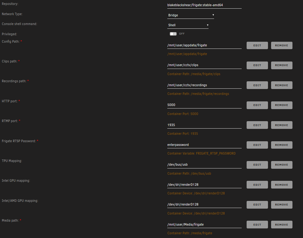

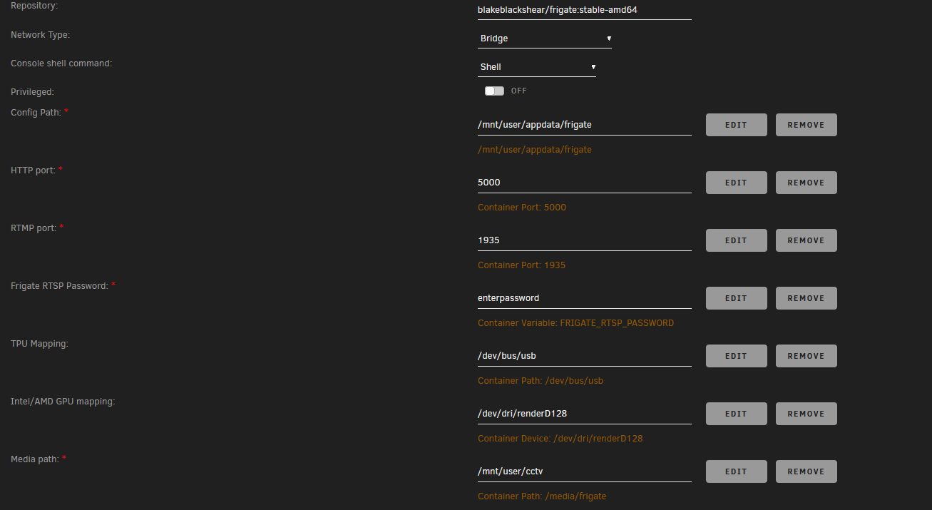

Can you attach your docker settings? Can you see the tpu on unraid under tools>system devices>USB devices? You can find it as a Google Inc. device.

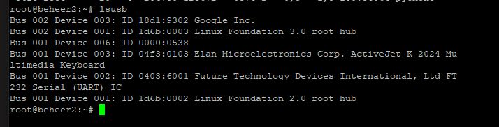

i feel stupid now.......... where can i see the docke settings and... where is this tools option ? on my debian machine ? sorry........😞
edit: this is my LSUSB, it shows Google, and Frigate says also it sees it. Maybe it is normal to get much higer processor times just because the camera's are also be seen /active in my Home Assistant (dashboard) and only the AI component of de images (looking for objects) is offloaded ? Would it be better to run the camera's on a dedicated NUC to not interere with Home Assistant?
Edited by Hendrik6073

Ok. This forum is for unraid users, please use the official project forum on github. By the way, yes, using frigate with a TPU still uses some CPU for ffmpeg decoding and movement detection.

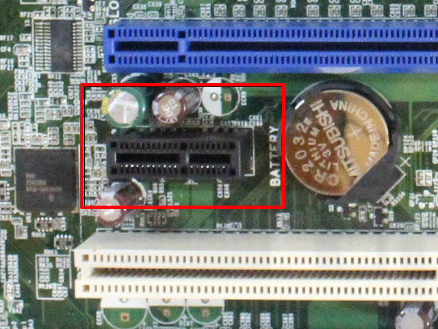

Slightly off topic... but I just tried this out with CPU inference and am impressed, so I want to get the Coral TPU
Im not familiar with M.2 and after an hour of Amazon searches.. and can't figure out what adapter I need for this.  Any recommendations?
I have an older Dell T20 with one "one full-height, half-length x16 PCIe Gen3 card slot connected to processor" and "One full-height, half-length x16 (x4) PCIe Gen2 card slot connected to PCH"
It looks like the M.2 A+E  Coral is easier to find.. but cant find the right adapter.  If I get the M.2 B+M, most adapters I saw say they are for M.2 M keyed SSDs.. I assume that's not the right one for this?
BTW with one camera and a low framerate.. it seems to work fine with CPU inference.  I'll wait for the TPU to add my other cameras.

If I'm correct, your motherboard is a VD5HY-0VD5HY so you can use a Mini PCI version connecting it to the Mini PCI Gen2 slot:
Thanks.. but that's a half-length x1 PCIe slot.  I don't think they're compatible?  Im going to try this adapter https://smile.amazon.com/gp/product/B07D6ZCBHY

You hace mixed configs for older versions. Delete the entrys of clips and recording paths, change the path of media to /mnt/user/cctv and delete the "Inter GPU mapping" entry and try again.
It still does not start
I also tried to delete container and redownload it from CA (hoping in a correct template):
the first time I see this error when building the container:
docker: Error response from daemon: error gathering device information while adding custom device "/dev/dri/renderD128": no such file or directory.
But then after few tentatives it worked (but container does not start still)
not sure about what is happening, everything loosk right. Maybe try to start from srchatch again, first deleting the entire docker and image and then adding the cameras one at a time...
Edited by yayitazale
I tried modifing config with just mqtt 1 camera e detectors but still I see error in building the container:
root@localhost:# /usr/local/emhttp/plugins/dynamix.docker.manager/scripts/docker run -d --name='frigate' --net='bridge' -e TZ="Europe/Berlin" -e HOST_OS="Unraid" -e 'FRIGATE_RTSP_PASSWORD'='enterpassword' -p '5000:5000/tcp' -p '1935:1935/tcp' -v '/mnt/user/appdata/frigate':'/config':'rw' -v '/mnt/user/Media/frigate':'/media/frigate':'rw' -v '/tmp/frigate':'/tmp/cache':'rw' -v '/etc/localtime':'/etc/localtime':'rw' --device='/dev/bus/usb' --device='/dev/dri/renderD128' --shm-size=5G 'blakeblackshear/frigate:stable-amd64'
cc6093a248943b695bffe696d9da014ae29f9b52fdb2c388f9926ae90d3c9cce
(this time I made no changed to the template)
Any hint on why the dev/dri is not found?
Update:
Don't know why but I followed this guide (
adding
modprobe i915
chmod -R 777 /dev/dri

10 hours ago, bigbangus said:
Any way to avoid having the refresh the usb coral path in the docker template when I reboot my server? It sometimes changes if I have various devices plugged/unplugged in the usb ports.
I read this https://forums.unraid.net/topic/71372-usb-passthrough-device-location-changing/ but not sure if there was a clear solution.
You only need to map '/dev/bus/usb' as a device and frigate will detect your TPU and only use that device. There is no need to change anything on that line on the template.
Thanks! User error. RTFM.
