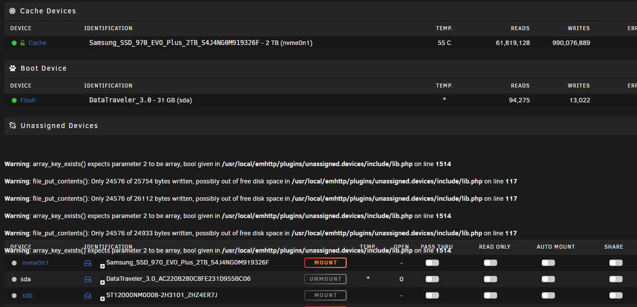

Anyway this was a backup to a UAD drive r-sync incremental but I did some path wrong and I got this
And just before this it stopped my VM and wrote:

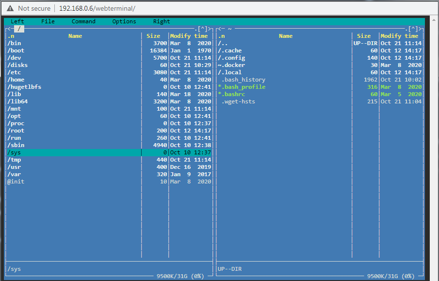

The positive is that I do have access to MC:
So what can or should I remove before trying another reboot?

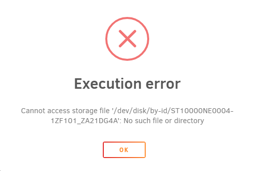

Serial from the dashboard ID:
And trying to start I get:
Update tried the serial number I could save the VM but it couldnt start
Sorry @itimpi this doesn't seem to work?
