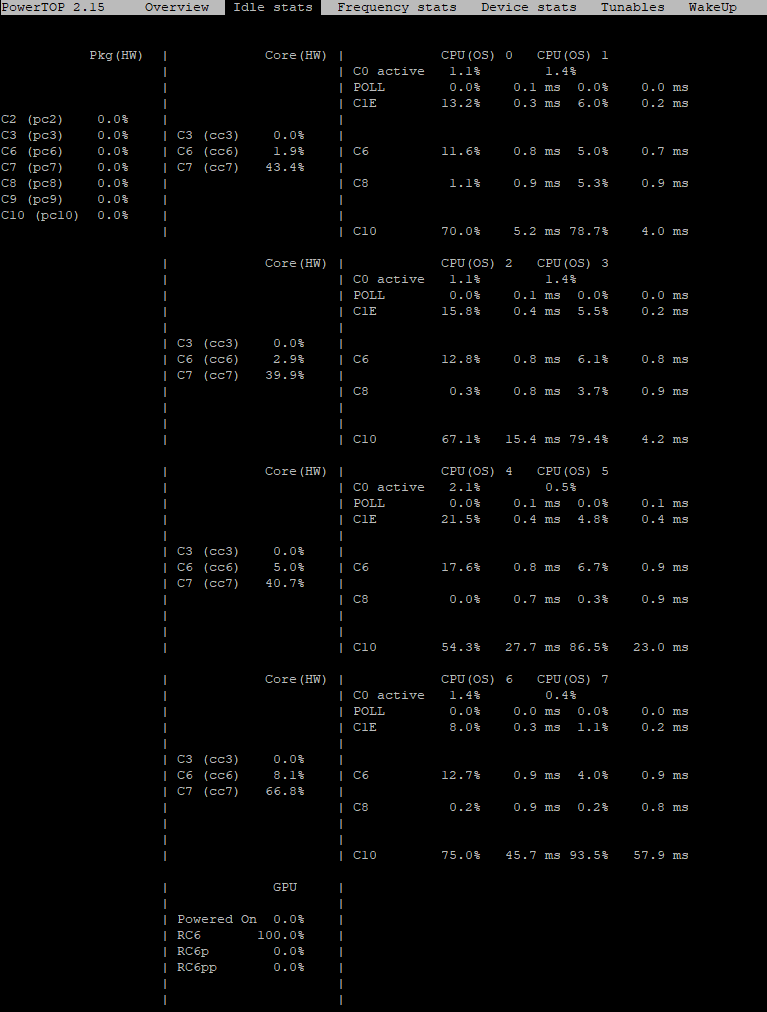

    Good news everyone! I managed to get C10 pkg C-State (previously I get no higher than C3) on Asrock LGA1700 mobo and you can too. Yay!   My setup is:   Motherboard: Asroc

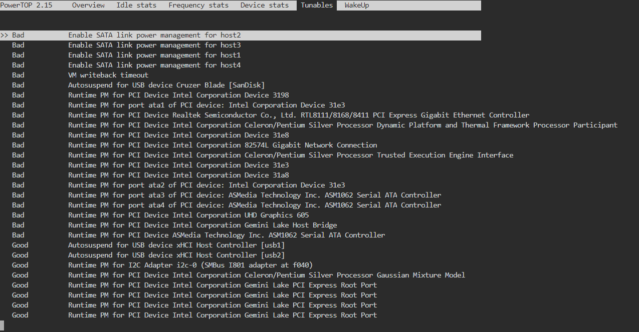

Hi All
I wonder if people can offer me some advice.
I have a unraid server (been running for years) and comsumes around 50w , 24/7
Would love to lower the number
This is mainly a plex server, so doesnt do much, performance is not a main consideration.
I currently spin down the disks. (30min) which doesnt appear to make any diff.
The server has 4x8tb drives. (Tosibiha)
Server spec (this is a soldered on CPU)
Model: Custom
M/B: ASRock J4105-ITX Version - s/n: M80-B3004200454
BIOS: American Megatrends Inc. Version P1.30. Dated: 05/04/2018
CPU: Intel® Celeron® J4105 CPU @ 1.50GHz
HVM: Enabled
IOMMU: Enabled
Cache: 224 KiB, 4096 KiB
Memory: 8 GiB DDR2 (max. installable capacity 256 GiB)
Network: bond0: fault-tolerance (active-backup), mtu 1500
 eth0: 1000 Mbps, full duplex, mtu 1500
 eth1: interface down
I saw about auto tune, but is that a good idea on this server?  It is a live unit.
Is 50w decent, or can i get it into some sort of sleep state, as its not used a huge amount.

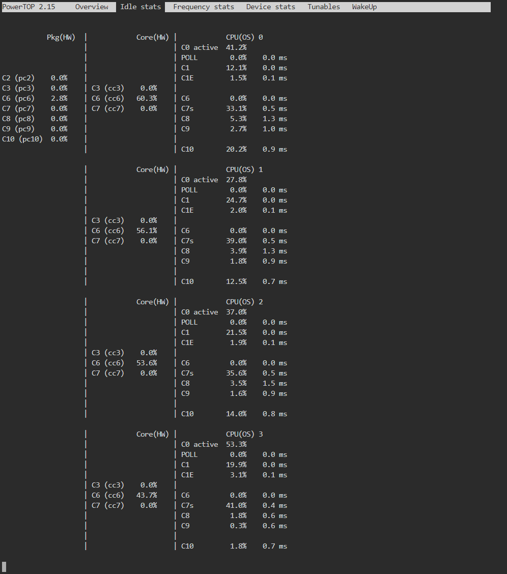

Powertop Reads:
Really appreciate any advice anyone can give! :)
Doesn't make sense. A spinning disk consumes usually 6 to 8W and a non spinning disk 0.5 to 1.5W. This difference should be noticeable on your power meter.

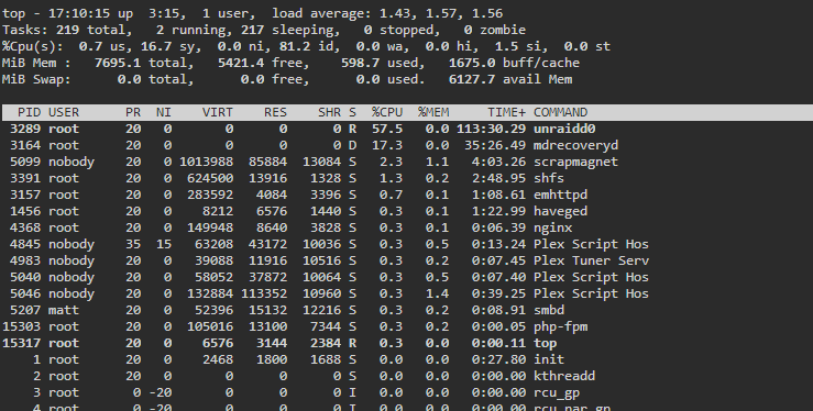

I saw about auto tune, but is that a good idea on this server? ... Powertop Reads:
Did you even read the first post? As you are having "bad" entries it does not seem so.
Aha, and why is your CPU having a load of 50%? Check your "C0 active" values. This is far away of an "not used" server. Execute "top" and check what is causing this huge load.
It wasdoing a partity check.  Ill let it calm and wait for the spins to spin down
For a server of this type with disks spun down, what sort of wattage would be decent?
I did read first post , but it warned about using auto tune in certain cases.....  Sorry im n00b!
Edited by virtualP

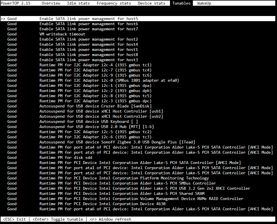

Greetings,
first of all thanks for all the tips, I already managed to lower power consumption of my rig a bit. I have a couple of questions though, maybe someone will be able to help me.
I built a new PC to host unraid on, these are the specs:
MB: Asus PRIME H610M-R D4
CPU: i3-12100
HDD: 2x Seagate Ironwolf 4TB
SSD: Samsung 850 EVO 500GB (SATA)
PSU: Corsair RM550x (2018 revision sadly)
When running unRAID and 2 containers (Photoprism and nextcloud) I measured about 20W power usage. CPU is reaching C8 I believe. Is this good result? I thought I could run a little lower. I have disks set up to spin down but they never do that, I don't know why.
Main issue is when I start VM with home assistant and when I attach Sonoff Zigbee 3.0 USB stick. Power usage is now 30W and CPU never reaches any C state. I tried to apply all the tweaks but nothing seems to be helping. I'm attaching a couple of screenshots.

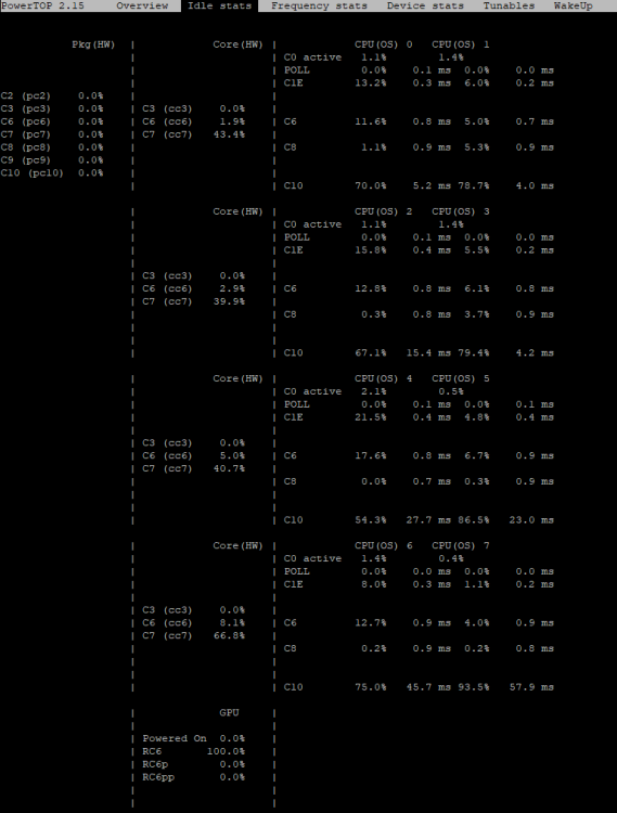

First of all, many thanks for all the tips gathered throughout this topic and points given by @Mgutt!
My setup is  hovering between 27 and 32 watt when disks are idling. Which I think is a great feat on it's own, but with my continuous quest to bring down power consumption, I would like to ask some pointers whether more is possible with current usage. I have applied all recommended bios settings tweaks and Powertop tuning as per instruction.
My setup is:
MB: Gigabyte C246M-WU4
CPU: Intel® Xeon® E-2288G
HDD: 6x WD ULTRASTAR 18TB
SSD: Samsung 970 EVO 1TB (NVME)
        Samsung 970 EVO Plus 2TB (NVME)
PSU: Corsair RM550x (2021)
RAM: 2x KINGSTON 2666 MHz ECC 32 GB
C states reach C9, but I always seems to have CPU's stuck in C2.
I am not running VM's, but believe Home-Assistant docker is to blame. CPU usage seems to continuously around 1 - 2%.
Is anyone experiencing the same and having ideas whether this could be lowered by e.g. tweaking Home-Assistant ?
I checked my server and I don't see a process "hass", although I'm using Home Assistant, too. Please press "c". It will show the full command then. Or execute:
pgrep -af hass
Your shfs load is high as well. It seems you didn't change docker containers to the path /mnt/cache/appdata. Anytime something writes to /mnt/cache/user, it adds a little bit shfs process overhead. Some German information about this tweak:
https://forums.unraid.net/topic/99393-häufig-gestellte-fragen/#comment-1223263
Is fail2ban present all the time, too?
This is pretty usual. VMs produce load. Load stops the CPU from going to sleep. But you could try to give the vm only the very first CPU core #0 and then check again. Another variant could be to isolate the last cpu core and use this exclusively for HA. Then reduce the maximum frequency for this single core:
Lets say your last core is #7 as you are having an 8-core CPU. Then do this to limit this core to 2 Ghz:
echo "2000000" > /sys/devices/system/cpu/cpu7/cpufreq/scaling_max_freq
Obtain all frequencies of all cores:
cat /sys/devices/system/cpu/cpu*/cpufreq/scaling_max_freq
Note: This is reset after each reboot. So you have to add it to a script or the /boot/config/go File to make it permanent.
Obtain minimum and maximum of your CPU:
cat /sys/devices/system/cpu/cpu*/cpufreq/cpuinfo_*_freq

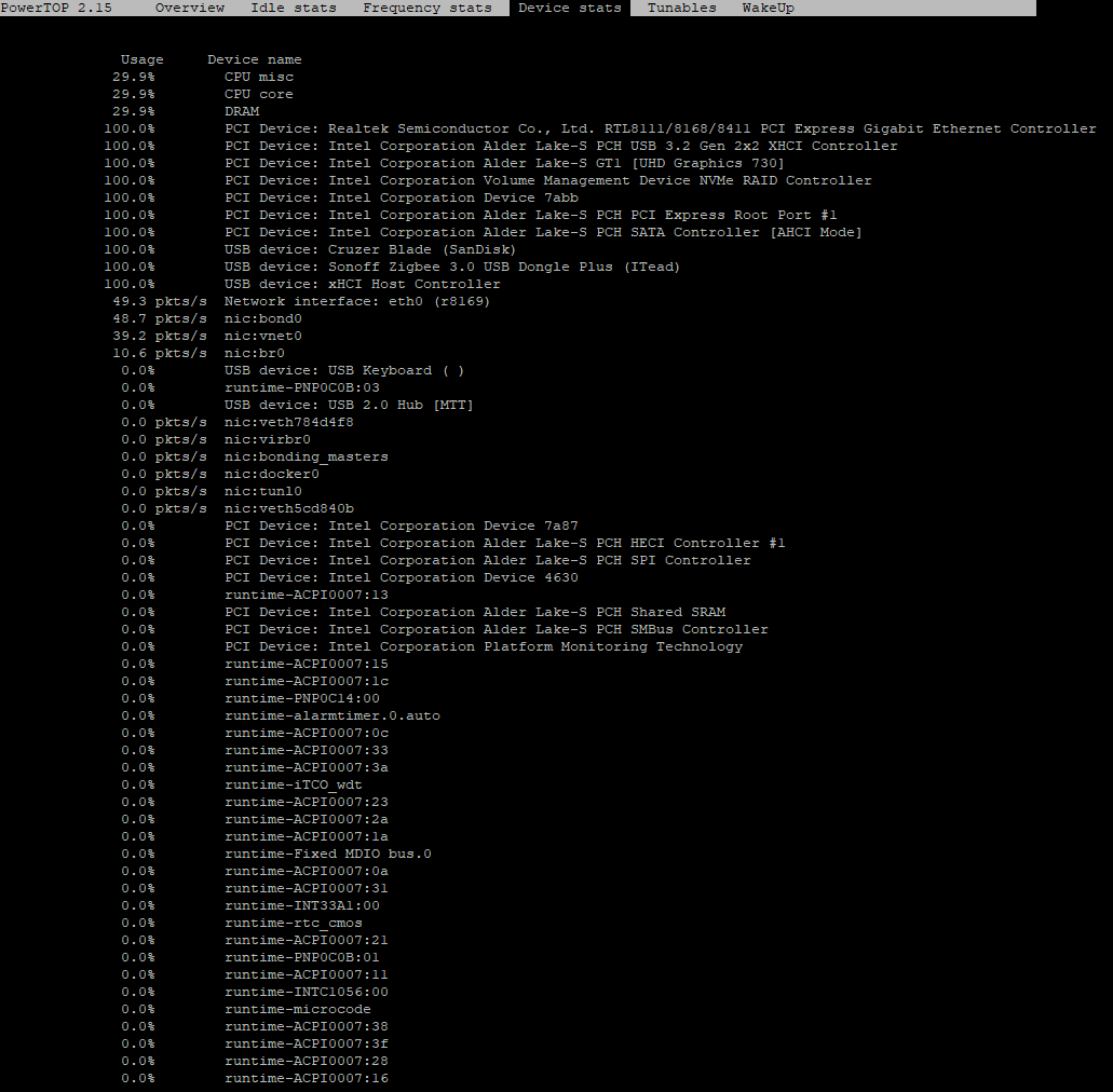

CPU: 9900k underclocked to 2500 MHz
Motherboard: E3C246D4U
RAM: Corsair 4*16 GB
Cache: 2x Samsung 500 GB M.2 NVME, one in a PCI card
Array: 2 exos 18 TB and 2 WD purple 10 TB
Additional drive: WD purple 10 TB passed through
Always on dockers include plex and wyze bridge, there is also an always on windows VM running Blue Iris.
With disks spun down (except for the one passed through to the VM) I am at 40-45 W at the plug (with a 1500 UPS in series).

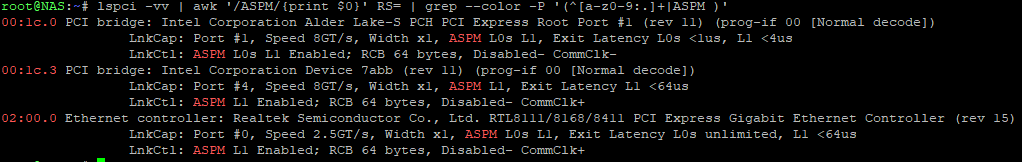

I have spent time using powertop and trying to get ASPM working, but these don't seem to get me past C3.
more details here: ASPM for E3C246D4U
I guess my power consumption is not bad for what the system is doing.
Edited by tdatta
added info
And without? Which power supply do you use? Fans?
With a VM it is nearly impossible to reach the lowest states. What is your CPU load? (Execute "uptime" in terminal)
Readings without UPS:
40-50W standard idle, (plex and wyze and windows VM with passthrough HDD and Blue Iris)
38-39W with dockers off but BI VM running (seems strange that docker would use so much power)
24-27W with docker and VM off. I guess this is "true" idle.
Power supply is an EVGA from ~2018, probably 550-650 watts, I need to check to be sure.
Fans are two Noctua NF-A8 @ ~1700 RPM (each max 1W), and one Noctua industrial NF-12 iPPC @ ~1500 RPM (max 3.6W)
output from "uptime":
20:34:00 up 5:32 , 0 users, load average: 3.20 3.22, 3.00
You can see in my previous linked post what the c states are like with and without the VM.
With the VM off it can spend close to ~50% in package C3
FYI- running powertop auto-tune saves about 10W at idle (the numbers above are after auto-tune)
Edited by tdatta
add info

Hi all,
i switched from AsRock H110M-ITX , i5-7400 to a AsRock H570M-ITX , i5-11400 (Rocket Lake), 16GB RAM.
When using powertop, only ACPI states show up (C1 to C3).
Idle consumption is also quite high with 30W compared to 19W with my old setup.
I have installed the INTEL Plugin and used the CLI-commands.
Further, deepl sleep and the c-states are activated in the BIOS.
Any ideas, what might be the reason, why i can't see the C1-C10 states?
Thanks for the help!!
Powertop displays only C3 if the CPU is not supported. So it probably reaches C10, but powertop isn't able to obtain this status. Recent version?
It kind of works after the update to 2.15 :) Idle consumption is down from 30 to about 22W.
Powertop itself has nothing to do with your power consumption. It only displays the states.
What's the --auto-tune command for then?
Something is still weird, i think.
Right now, i can reach no more than C3... i have no PCIe Device but 2 M.2 NVMe SSDs (SN570).
Do you have any idea?
Thanks a lot!
It enables the power saving setting on all pcie slots, USB and SATA ports. This is a one-time setting (which gets lost on every reboot). It is the same as the custom commands in the first post. So it's nothing like a background process watching and reducing power consumption if you thought about that.
The bios settings are looking good to me. Did you place the NVMe into the CPU M.2 slot? Try a Chipset M.2 slot then.
