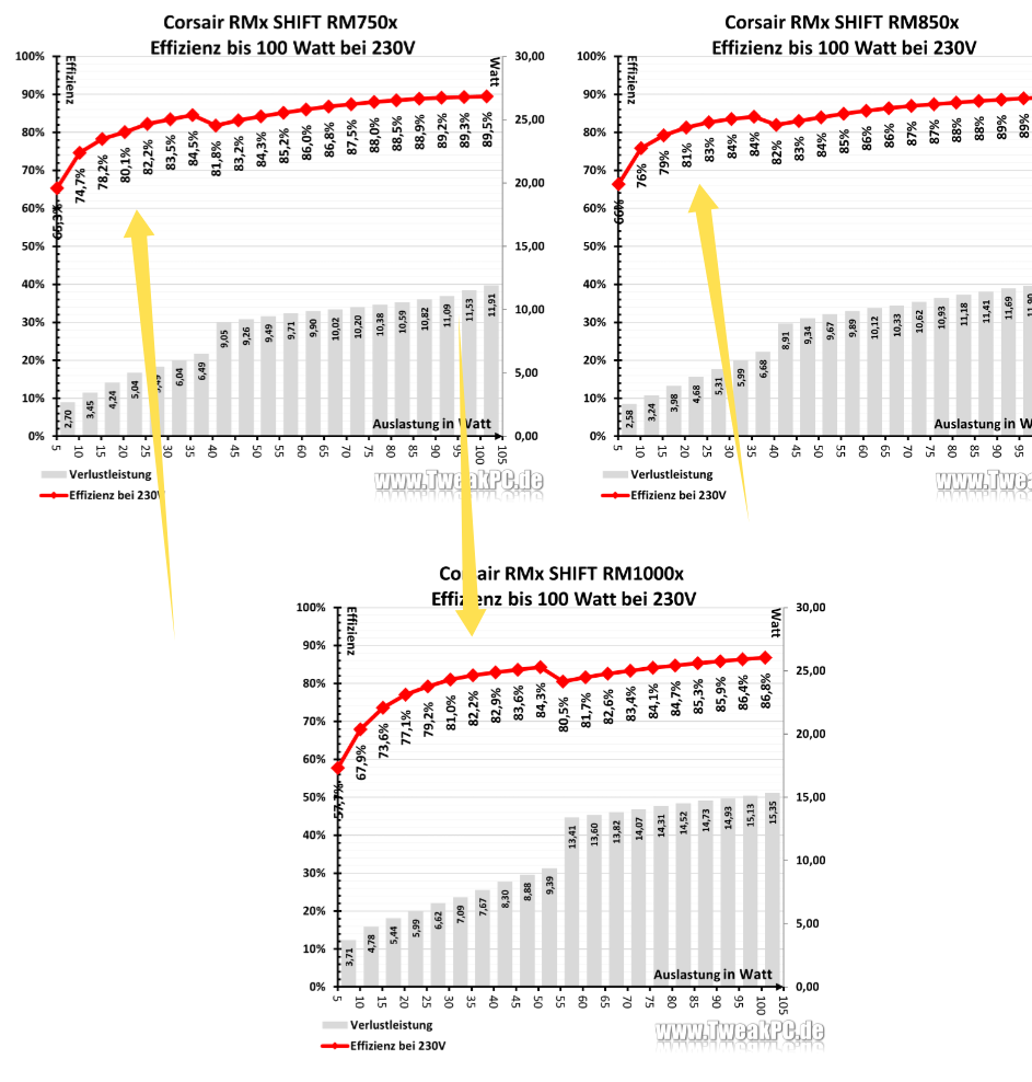

But it seems all recent Corsair Power Supplies have the same low power efficient feature:
https://www.tweakpc.de/hardware/tests/netzteile/corsair_rmx_shift_rm750x_rm850x_rm1000x/s02.php
But: They start at 750W. Which can't be as efficient as 550W (or even smaller ones). Sadly there is still no update regarding the SF-lineup. Having an SFX power supply with 450W and this efficiency would be a dream.

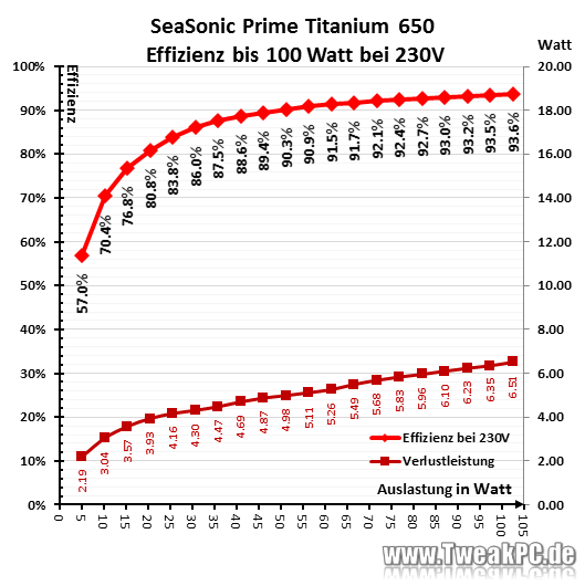

I have the Seasonic PRIME TX-650 (80+ Titanium) installed in my unraid-server. I'm pretty sure, it's more efficient than the 2021 rm550x in the usual power range of low power unraid sytems (20-30W). In higher load scenarios, the TX-650 blows the rm550x out of the water.
Source: https://www.tweakpc.de/hardware/tests/netzteile/seasonic_prime_titanium/s03.php

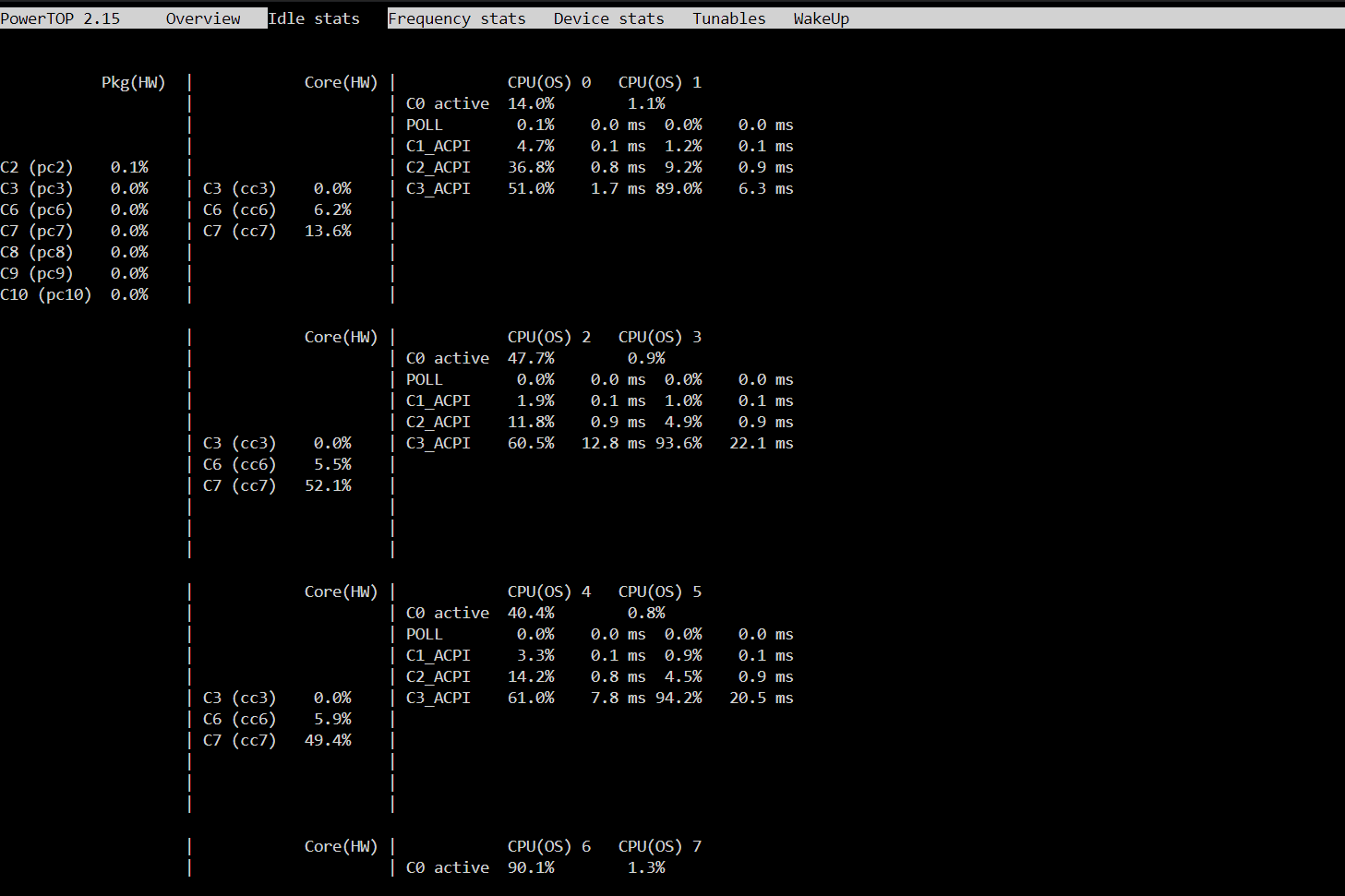

Hey,
I am not sure if it is safe to use for me to use
powertop --quiet --auto-tune
because I have a SAS controller?
This is my current setup:
ASRock B450M Pro4
AMD Ryzen 5 2600
Corsair RM White Series™ RM850 (2021)
LSI® SAS 9211-8i (Chipset LSI SAS2008 PCI-Express Fusion-MPT SAS-2 [Falcon] (rev 03))
This is my
powertop
output, it looks diffrent than the one in the example, only 2 C states and Pkg(OS) instead of (HW):
Are these errors a problem (unraid 6.11.5) ?
root@manitoba:~# powertop --auto-tune
powertop: /lib64/libncursesw.so.6: no version information available (required by powertop)
powertop: /lib64/libtinfo.so.6: no version information available (required by powertop)
modprobe cpufreq_stats failed
Loaded 0 prior measurements
Cannot load from file /var/cache/powertop/saved_parameters.powertop
File will be loaded after taking minimum number of measurement(s) with battery only
RAPL device for cpu 0
Devfreq not enabled
glob returned GLOB_ABORTED
Leaving PowerTOP
On 6/15/2023 at 5:56 PM, Interstellar said:
Anyone running 6.12 noticed increase in power usage?
Updated two weekends or so ago and now I’m 10W higher draw all of a sudden!
6.11 before upgrade - 32-34W measured at the wall
Updated to 6.12.1 - 50+W
Downgraded to 6.11 - 32-34W
It is like disks aren't spinning down when they say they are (I forgot to check physically if they were)... going to file a bug report.

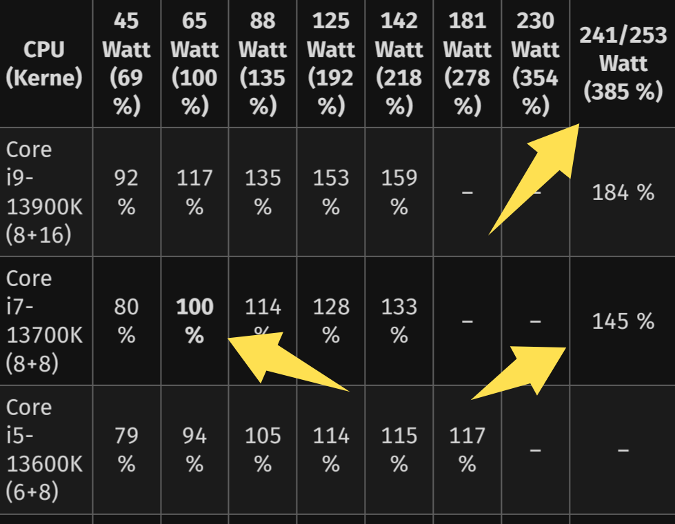

https://www.computerbase.de/2022-10/intel-core-i9-13900k-i7-13700-i5-13600k-test/2/
And only to highlight this: At 65W this CPU has equal power as the i7-12700K at over 200W.

No, because the most impact of this power supply is under 20W. Or maybe yes because your current power supply is really bad at low loads. But: the 2021 version is sold out in most countries. It's really hard to get and because of that extremely expensive.
Ok ,so that means if I'm over 20 Watt it make no sense to try it out. Maybe if they will be getting more and more available again, i will order one and try it out.

Hey guys. I used
when I started to setup my server on I guess 6.12 rc. Now if I have a look at powertop all tunables are bad. Sometimes they also show as good (I guess when I use the powertop auto-tune command even though I get this "error"). If I try to execute powertop --quiet --auto-tune again I always get the following response:
How can I fix this?
image.thumb.png.bca31b6b7dc43c5b95f869f70f5a359e.pngIt does not look good anyway. But I seem to have a good power consuption with 52 Docker containers running all the time. My Eaton USV says 20W and that with my router attached additionally to the server.
