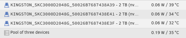

1 hour ago, JorgeB said:
Not my experience:
Interesting, which plugin gives you the wattage of individual devices?
It's a stock feature, you can enable in Settings - Disk Settings - Enable NVME power monitoring

I sadly did not have a full screenshot but I do have this little one.
This is with the KC3000.

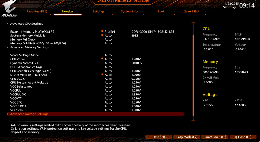

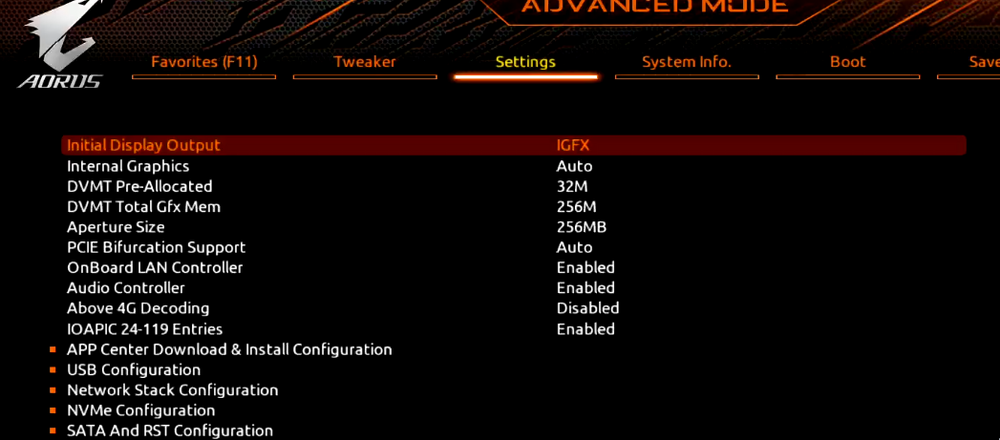

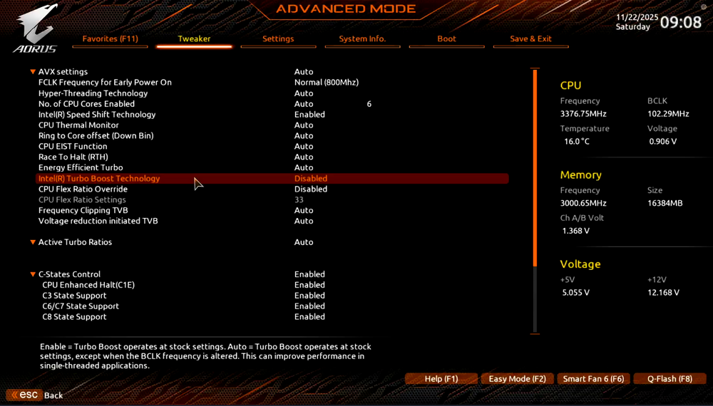

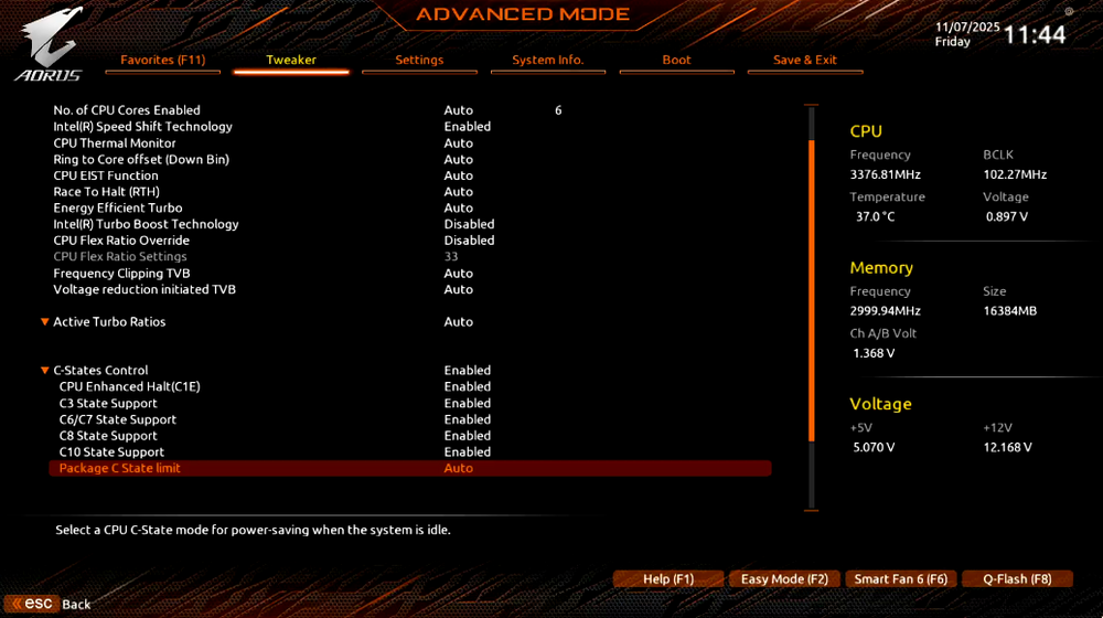

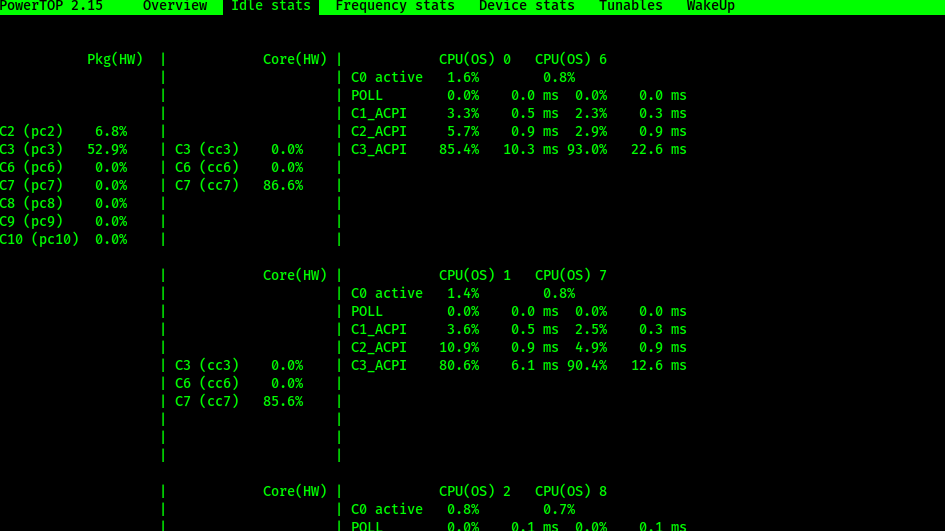

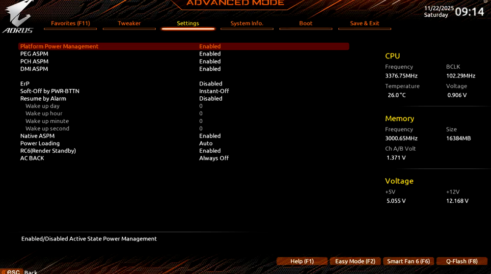

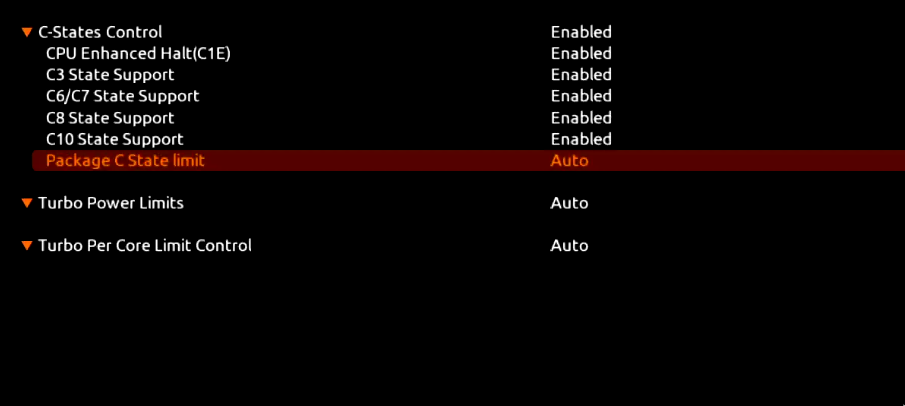

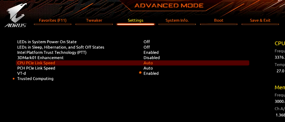

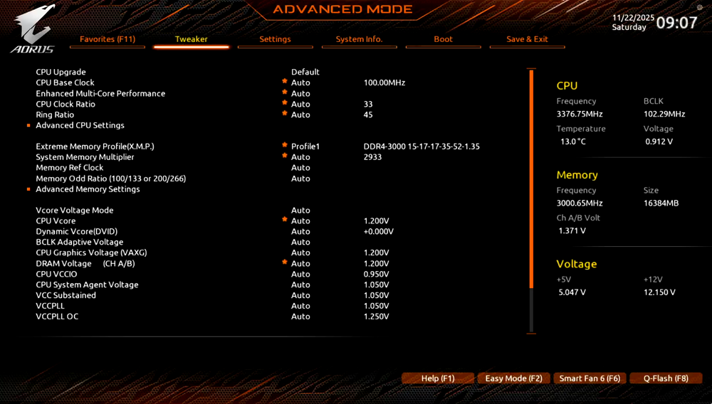

Can someone verify that my bios settings are alright, or have I missed something?
Screenshot_2025-11-07_12-00-11.pngScreenshot_2025-11-22_09-07-57.pngScreenshot_2025-11-22_09-08-53.pngScreenshot_2025-11-22_09-09-59.pngScreenshot_2025-11-22_09-14-12.pngScreenshot_2025-11-22_09-14-34.pngScreenshot_2025-11-22_09-18-51.pngScreenshot_2025-11-22_09-27-59.png
You need to explicity set C State Limit to C10. "auto" often means "disabled".
On 11/21/2025 at 6:48 PM, W0nderW0lf said:
I cannot restart the array.
This is not normal. Check your syslog. The block diagram of the board looks pretty normal (not additional controllers visible). So maybe something related to the ASMedia card?!
@mgutt
Thank you very much for taking a look and ur detailed guide on this specific topic.
As you suggested "auto" really meaned "disabled" in this case. ;D
