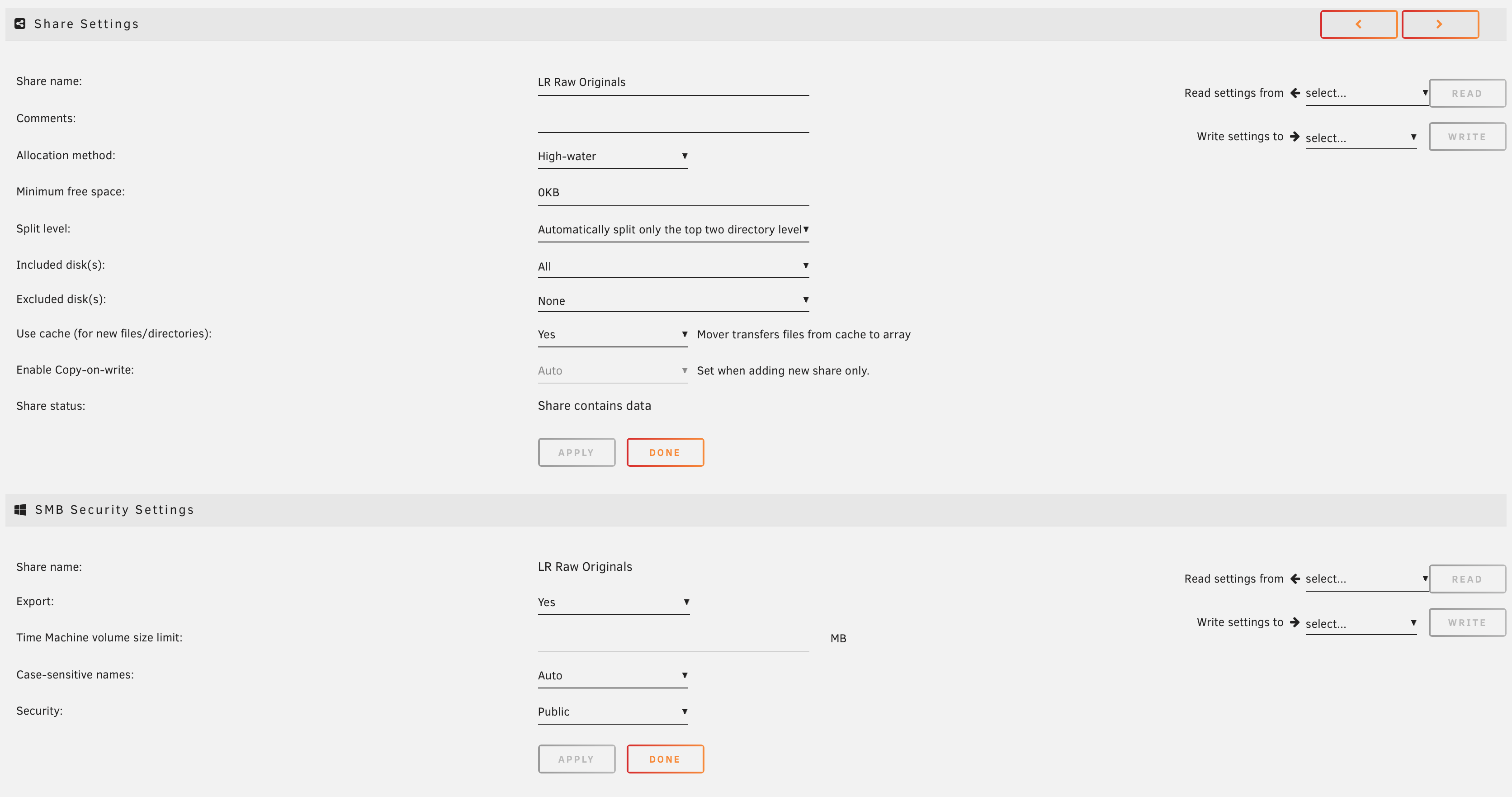

Hello I just started noticing that only recent folders I have added to my user share is propagating data within the finder window on OS X Catalina (10.15.7). But when I go into the Unraid GUI and look at the actual user share I can see all the data is there and am able to download it. What would cause this issue? Attached are screenshots of this share's setup and my recent log file.
