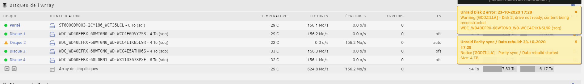

I have the former disk2 unplugged.
Looks like it didn't mount, not that surprising since like mentioned parity wouldn't 100% in sync, you'll need to run xfs_repair on it after it's done (or now after canceling the rebuild).
