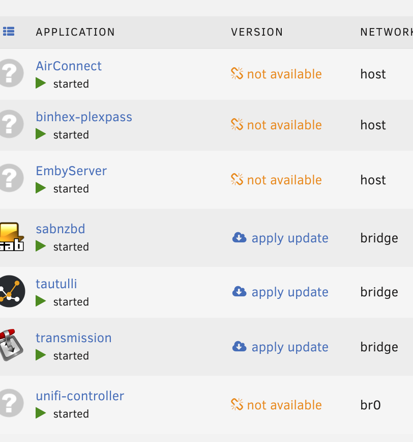

I swapped to a new one, got the key replaced, copied some of the files and setup what was missing. Its the dockers that seem odd, initially re-installed just fine but went I try to update them they stall and go missing.

Which files? If you didn't copy the docker templates then you would have to setup your dockers again. While they might technically still exist in the docker.img, you can't work with them in the webUI without the templates.
Yes your right, i think I missed that folder but have re-setup the existing dockers as shown and they were initially working pointing at there original appdata, its just when I try and update they go missing?
Go to Tools - Diagnostics and attach the complete Diagnostics ZIP file to your NEXT post in this thread.
Not likely to be the cause of your problem, but appdata and system shares have files on the array. And other warnings from FCP. You also seem to be having some problem with Unassigned Device sdu.
Go to Docker page and set the slider at upper right to Advanced Mode. Do you have any orphan containers?
appdata and system got a bit missed up with the recent crash and am gradually working through that stuff. Yes I do have ophaned containers.
Delete the orphans. Maybe won't fix anything but they need to be deleted anyway.
You might have to recreate docker.img and use Previous Apps on Apps page to reinstall your containers.
