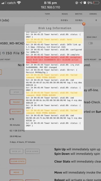

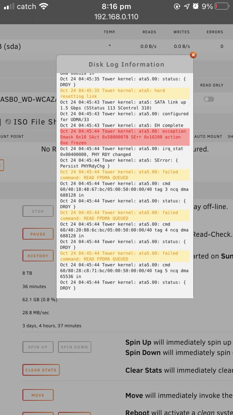

Yes it is getting write errors. Attached is a screenshot from the live disk log information. I will have to generate a diagnostic log when I am home again.

I ran extended smart test and it came back with no errors. I then ran the sequence to make the drive reconstruct but it’s going at 600kb/s and the eta is 18 days. It’s still showing errors like in the above screenshot when I click show disk information. Any further advice?
Edited by partyhat
Replace/swap cables on that drive, can't see which one is ATA5 since log rotated.
Thanks I reseated the drive and the errors are gone and the drive is rebuilding much faster now. Seems odd that would fix it but oh well, looking promising! Thanks!!
edit: All appears to be working now after the drive rebuild. Thanks :)
