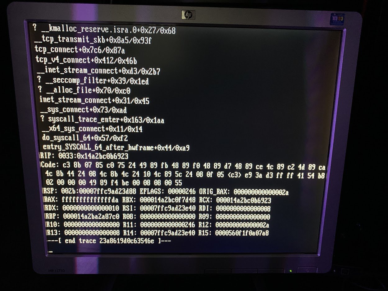

So now the server went from a few hours to almost a week with no issues.. earlier this morning (my time) whilst not in use just running in the background it happened again.. was notified that server was not available (from uptime monitor) I when to its screen physically and took a photo of what was on it.. it was unresponsive to keyboard/mouse inputs.. was unable to get to it over network.. did a reboot and also extracted syslogo.. does not show anything happened.. last task was normal scheduled stuff early morning and then the restart procedure.. hope the photo from the servers screen helps in any way to help me solve the issue..
syslog-192.168.0.21.log
Macvlan call traces are usually related to having dockers with a custom IP address, see here:

Issue again started with Macvlan call traces, if you're not using custom IP it's still likely network related, try simplifying your lan config as much as possible to test.
