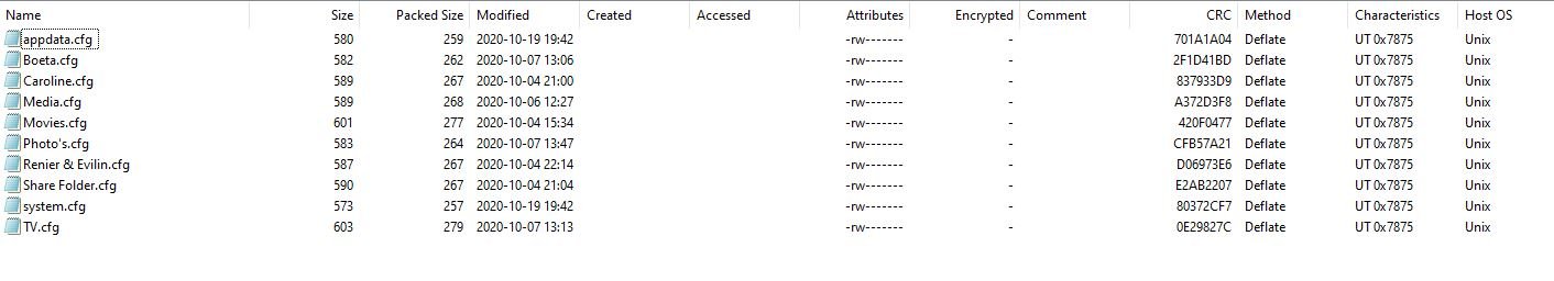

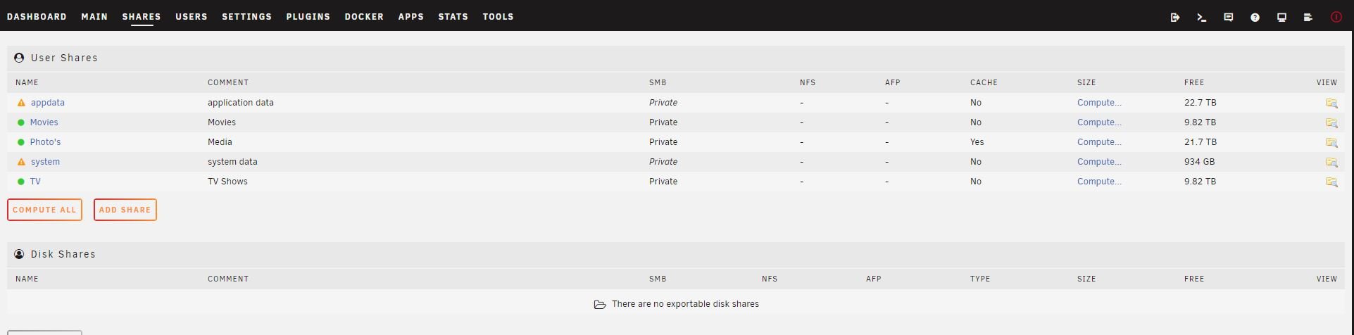

Hi Guys, I am brand new to unraid and I hope this is a simple fix... I installed a UPS on my unraid (V 6.8.3), did a proper shutdown... and after reboot most of my folders are gone. In the flash backup Z IP I created, I can see the folders is shown in the shares folder.

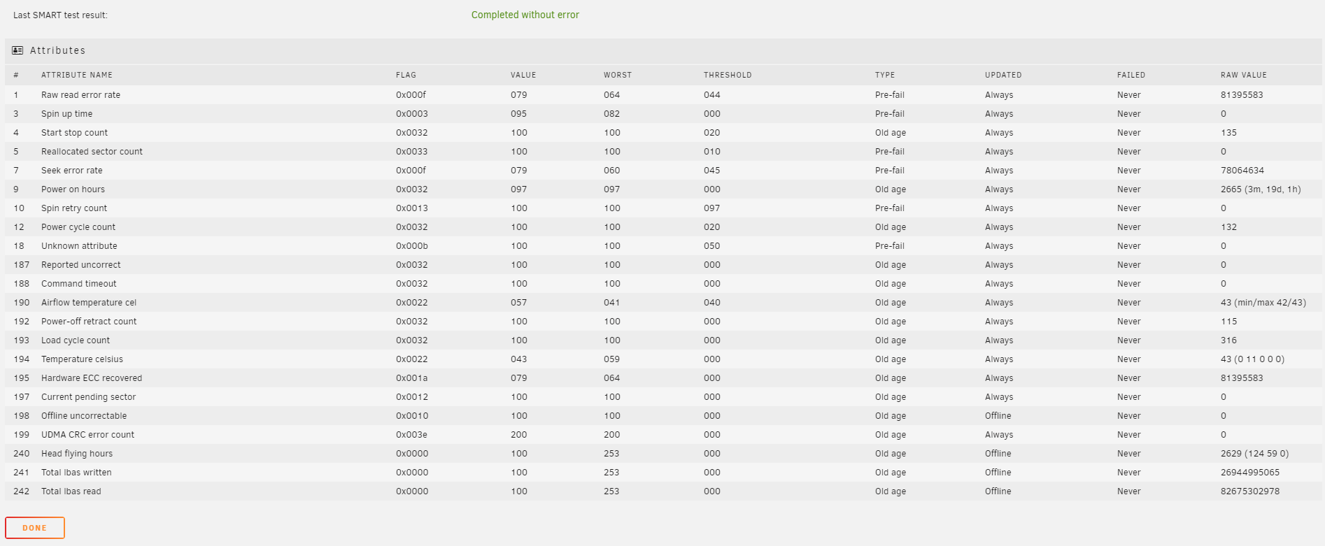

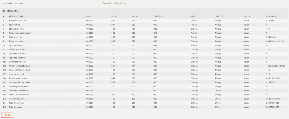

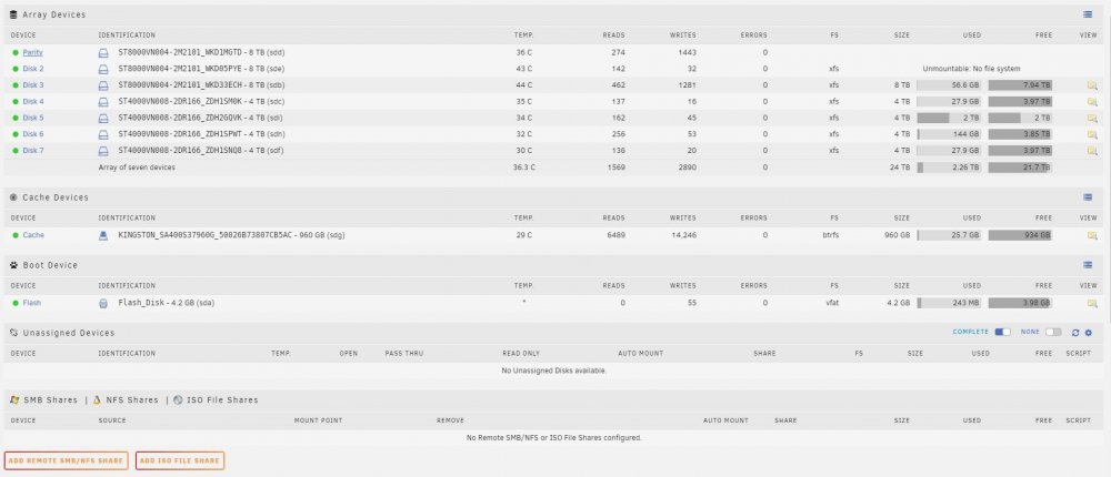

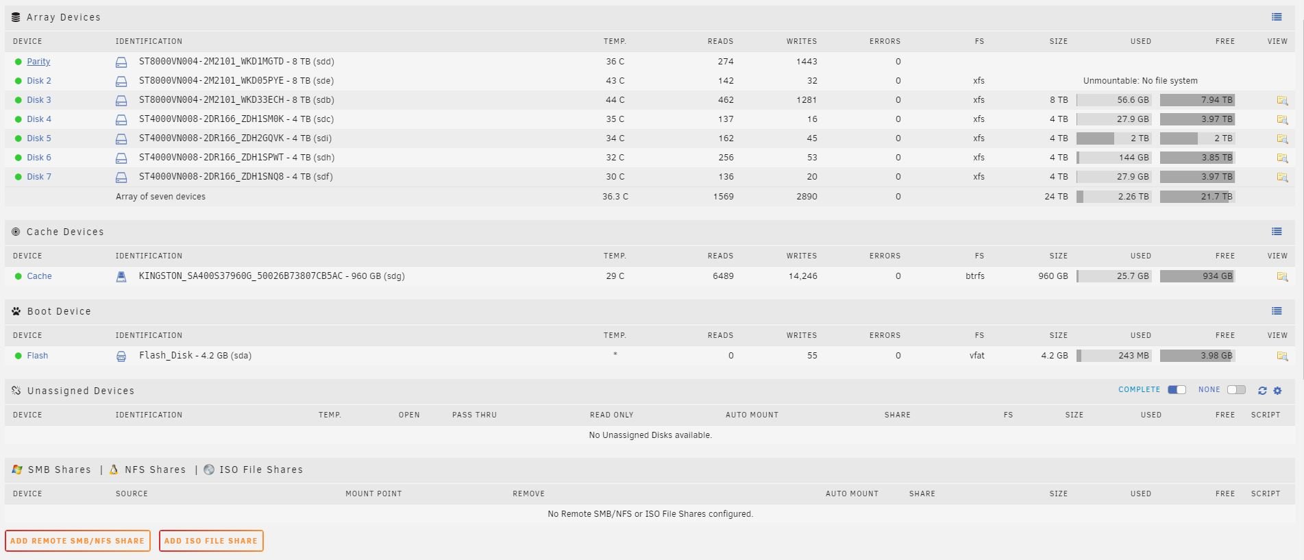

Another strange thing is, a brand new 8TB drive suddenly shows as unmountable: No file sysytem, however, the SMART test results shows its healthy...

I followed the instructions, and got ERROR message:
Phase 1 - find and verify superblock...
Phase 2 - using internal log
- zero log...
ERROR: The filesystem has valuable metadata changes in a log which needs to be replayed. Mount the filesystem to replay the log, and unmount it before re-running xfs_repair. If you are unable to mount the filesystem, then use the -L option to destroy the log and attempt a repair. Note that destroying the log may cause corruption -- please attempt a mount of the filesystem before doing this.
This is just the way the XFS repair tool works regardless of which system it is run on. In the case of Unraid, it has already been determined that the disk is unmountable, so you have to use the -L option.

You can but it isn't necessary. In any case, we should leave that for later until you get your disk2 filesystem fixed.
... I have all my files back...
