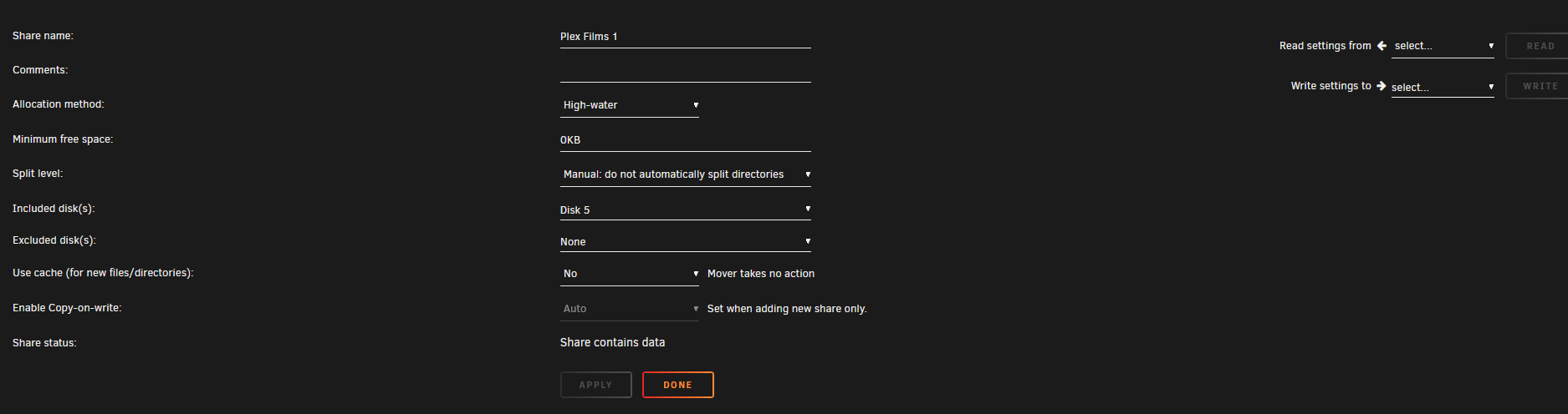

Hello
Ive been using Unraid for about 6 months now with no issues.
Due to my own requirements I have my setup set so a Share will use a disk and that's it.
e.g FILMS SHARE 1 will only use DISK 5 ,  FILMS SHARE 2 will only Use DISK 7.
This has worked fine until now, I have made no changes to Unraid.

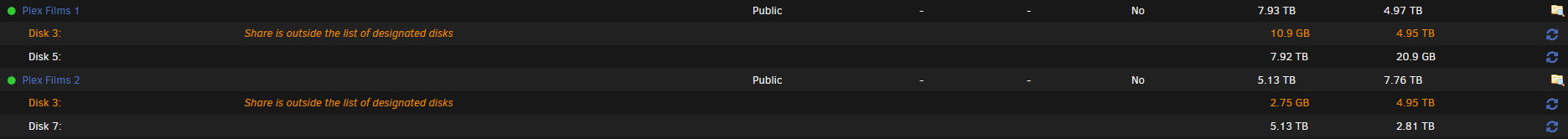

Now data is also being written to DISK 3 by 2 different shares.
Sonarr and Radarr are set to download files to the Download share which is only setup to use DISK 3, these are then moved to their respective share.
I am aware that one of my shares is low on space but my other still has nearly 3tb of free space.
I have tried deleting the data, Unraid recognizes that there's no data outside the designated disks.
I ask Radarr to do its thing and once again its over both disks.
Ive had a google and cant seem to find a solution, even more puzzling is that I haven't done anything.
Thanks in advance
