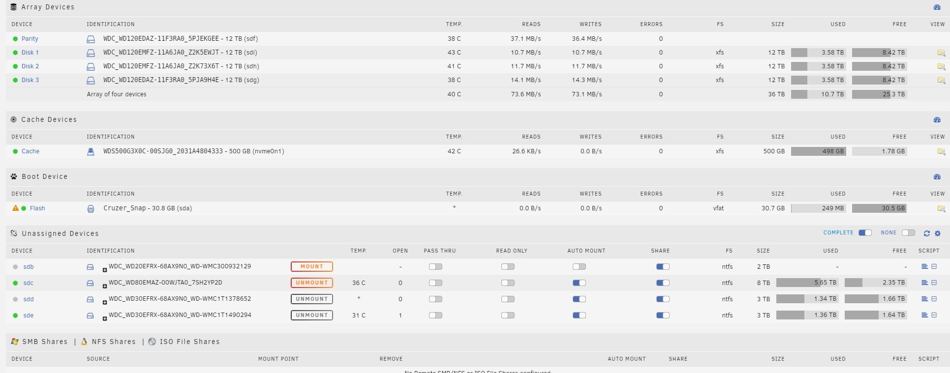

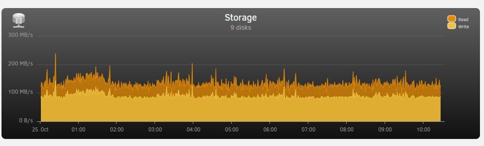

Here's a screenshot the speeds of my array.. mid transfer.
You appear to be using the "most free" allocation method, that's very bad for performance due to overlapping writes to parity.
