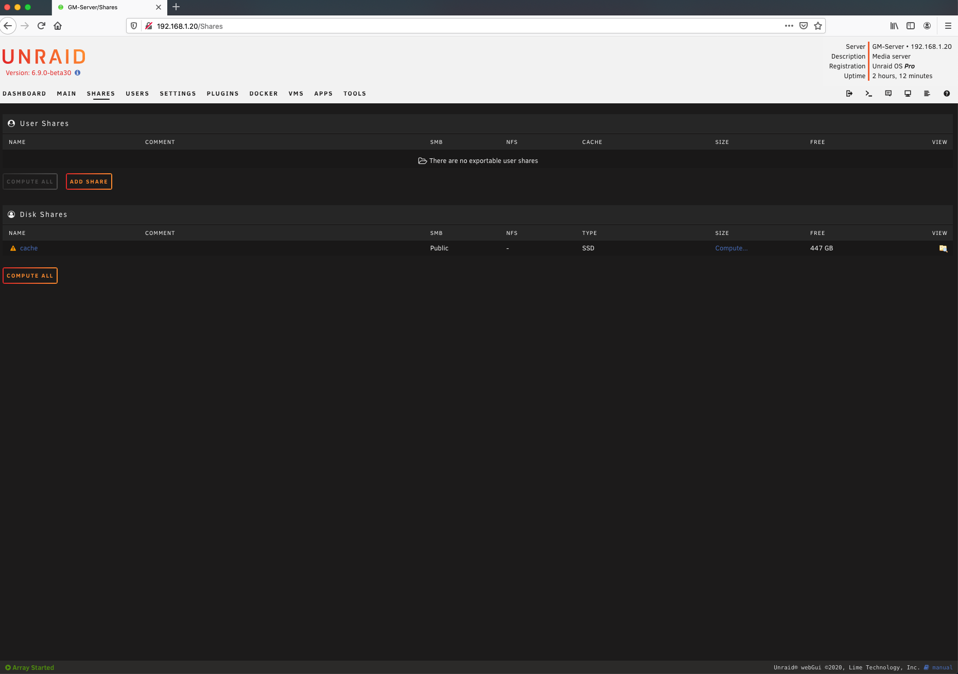

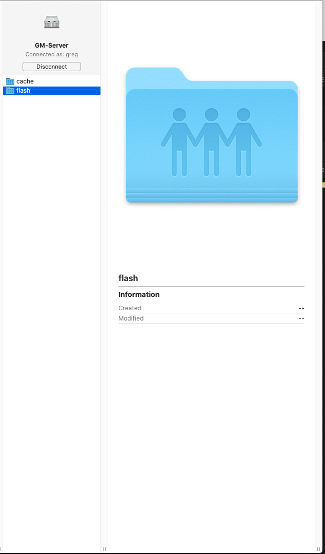

Post screenshots showing the problems.
Thanks for taking a look.
Logged in via web GUI on Chrome (default), firefox, and Safari. Neither Firefox or Safari have any extensions installed at all. Confirmed on multiple different computers on the network that I can't see the smb shares. Also, weirdly enough, attempted to add a test share via web GUI with no luck. Attempting to add a new Test share just ends up at the "share deleted" confirmation page. Screenshots attached.

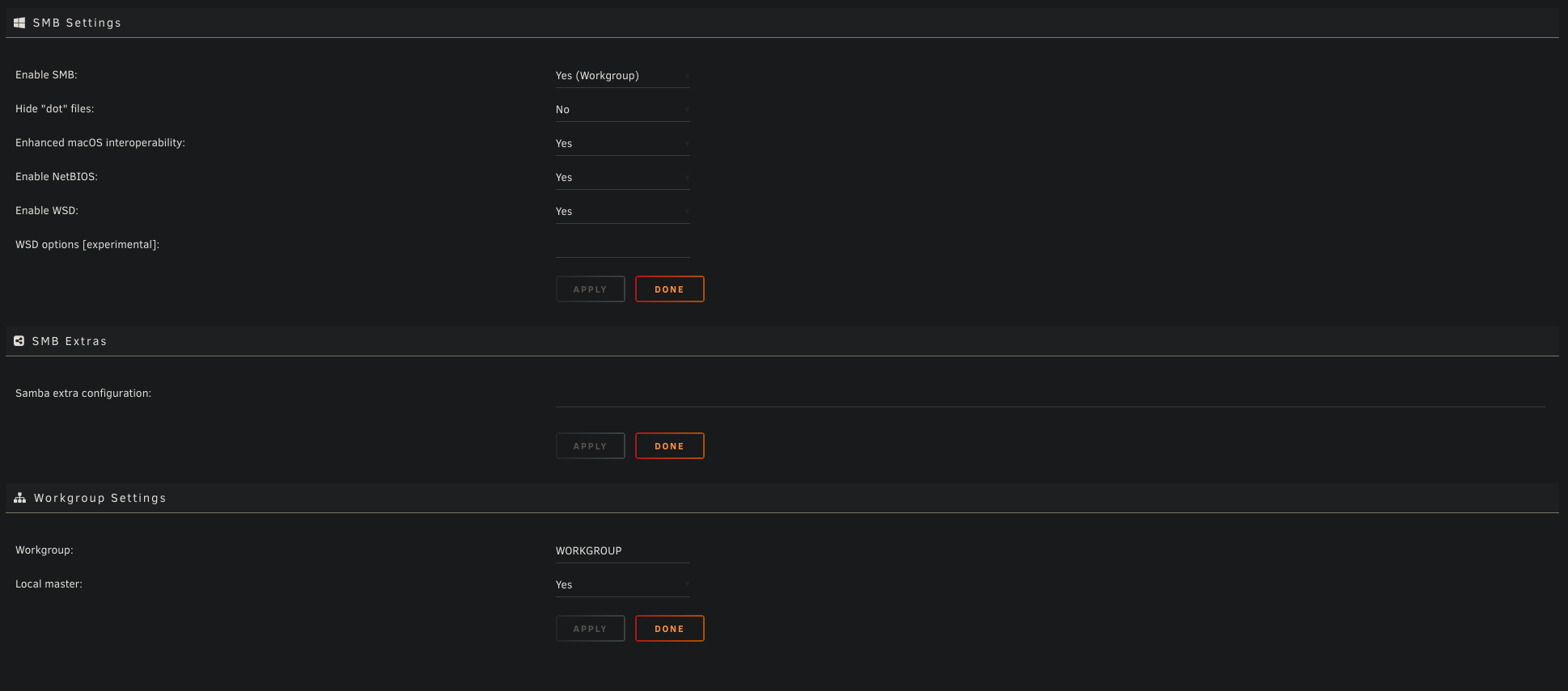

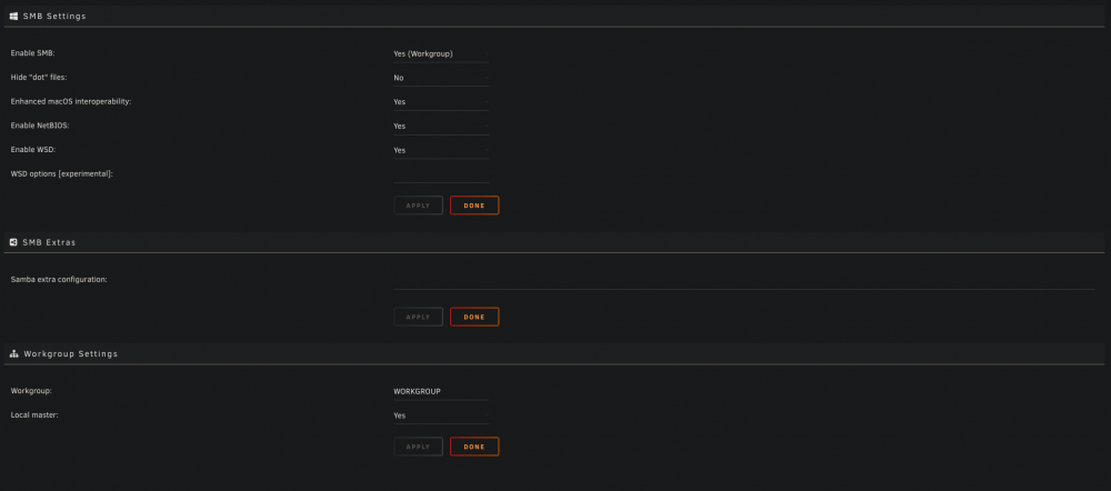

Post a screenshot of Settings - SMB - SMB Extras
Nothing in that section
