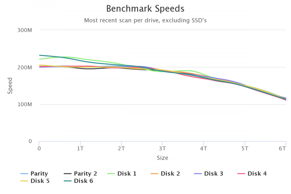

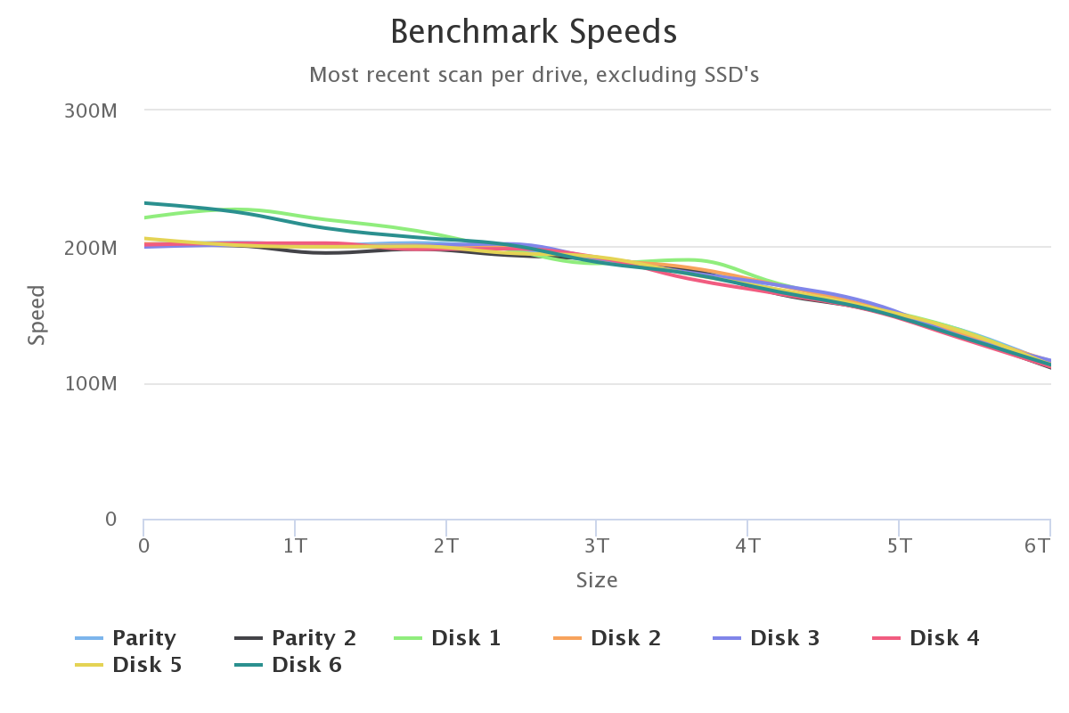

Attached here is the results of diskspeed. They are all over 100 MB/s. How do I interpret these results against the parity check throughput?

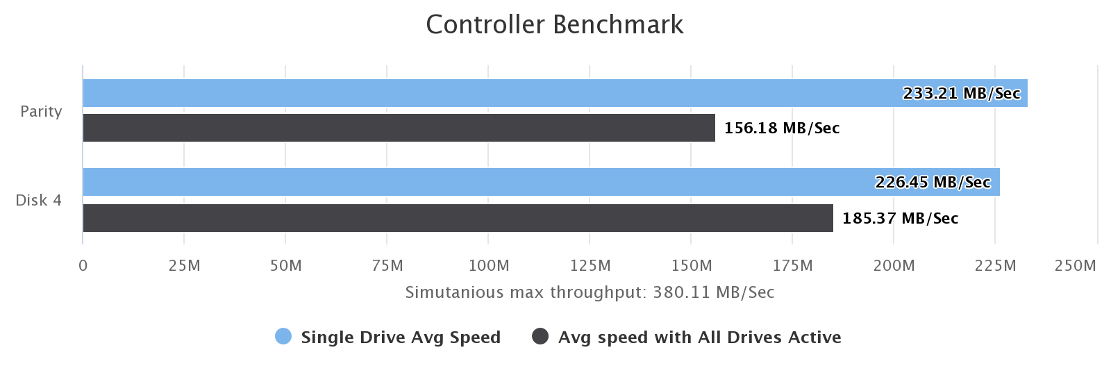

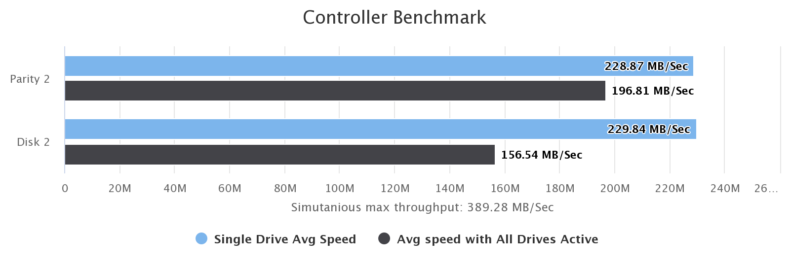

Disks look fine, was the controller bandwidth test also normal? If yes and still slow parity check install sysstat using the Nerdpack plugin, then start a parity check, let it run for a couple of minutes, go to the console and post the output of:

I attached two images. One is for Parity 1 and Disk 4, the other is Parity 2 and Disk 2. Controller throughput looks fine to me?
