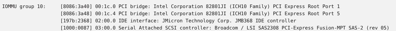

Also looked through my syslog and see this:
Oct 27 02:54:54 AnimNAS kernel: pci 0000:03:00.0: 8.000 Gb/s available PCIe bandwidth, limited by 2.5 GT/s x4 link at 0000:00:1c.0 (capable of 63.008 Gb/s with 8 GT/s x8 link)
Is this what you're referring to? I also note that the 0000:00:1c.0 device is in the same IOMMU group as the LSI card. Perhaps splitting the LSi card into its own IOMMU group might help? The LSI HBA is installed in a x8 slot on the motherboard but that message indicates it appears to be running at x1 speed.
Thanks again!
Edited by AgentXXL
Added info re: LSA HBA PCIe slot
This will be the main issue, HBA is caped at 1GB/s theoretical max bandwidth, usable max is around 80% of that, so 800MB/s, on the diags posted you have 25 drives reading at 31MB/s, that's close to the 800MB/s expected limit.
Ideally you'd want a PCIe 2.0 ou 3.0 slot for the HBA, and your board should have a couple of x8 PCIe 2.0 slots, if you use one of those it will quadruple current bandwidth.

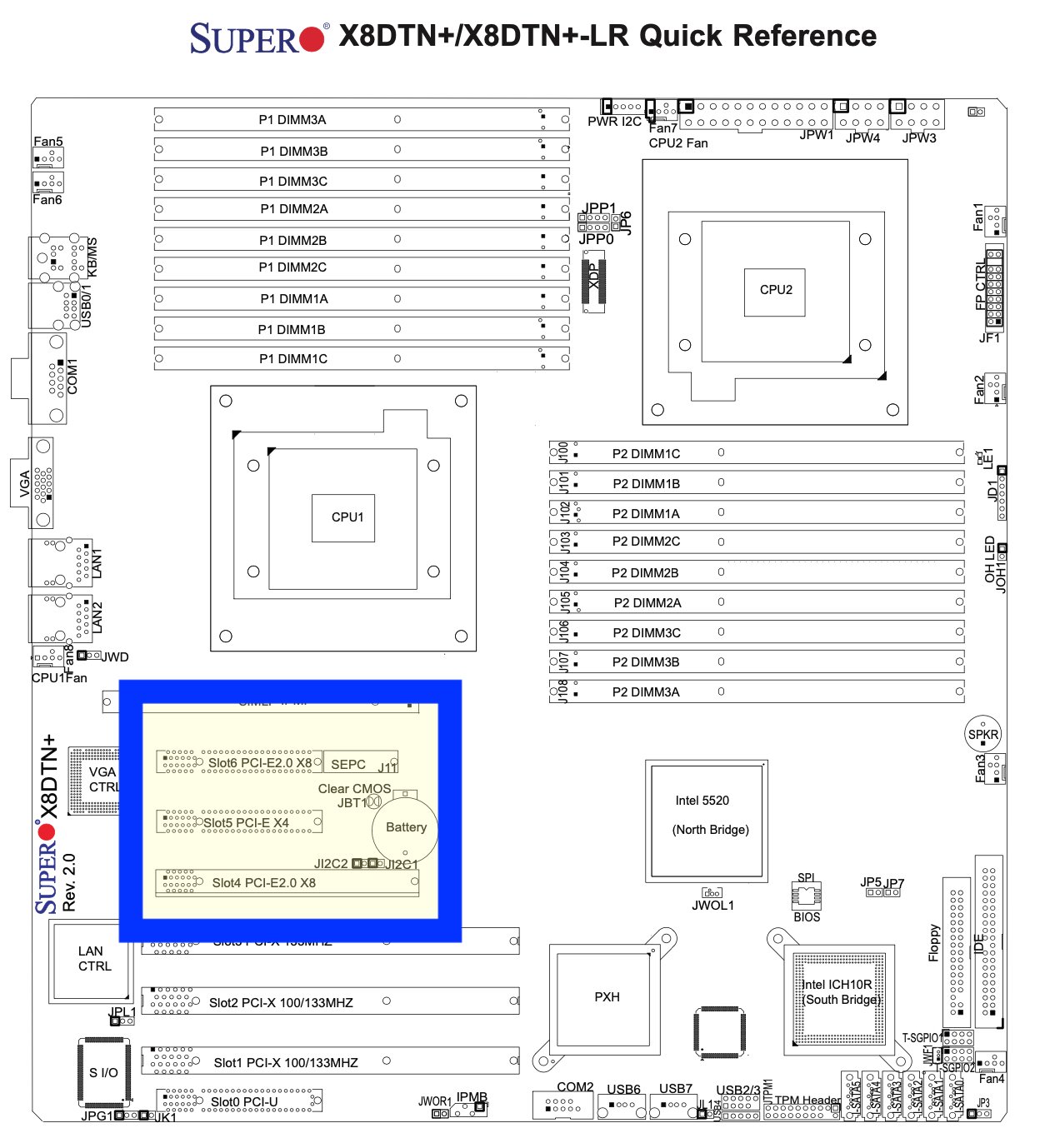

Yes, that's what I've determined as well. The motherboard (a Supermicro x8DTN+) has 2 x8 slots and 1 x4 slot. Only one of the x8 slots is connected to the 5520 chipset whereas the other one is connected to the ICH10 PCH. I will be moving the card to the other x8 slot once the parity rebuild completes.
If I could pause the parity rebuild and have it start-up again after a system shutdown/reboot, I'd go ahead and try this right away. But it appears that's not possible. I don't want to have to start the parity rebuild from scratch, especially if moving the card to the other slot doesn't change the performance. So I'll (im)patiently wait for the rest of the parity rebuild to complete... still estimating just over the 3 day mark.
Both x8 slots are connected to the chipset, though it's still an older FSB design, still much better than the PCI 4 slot that uses the DMI.
Also make sure the HBA and expander are connected using dual link (two cables).
Restarting from the beginning using a x8 PCI 2.0 slot with dual link should be be faster than waiting 3 days, should...

The Tylersburg 5520 only supports PCIe 2.0. The Supermicro CSE-847 model I have only supports low-profile cards and I only have the one LSI 9217-8i which only has 2 x SFF-8087 miniSAS ports so I can't do dual link cabling. I had tried dual link cabling before by using a 9201-16i with 4 miniSAS ports but it's a full height card so I couldn't put the chassis cover back on. My testing showed that dual link made minimal difference at that time, but it may help now as I've reset and reconfigured the motherboard BIOS (details later in this post). I may give it another try after the rebuild completes but if it works, I'll need to purchase a PCIe slot extender so I can lay the 9201-16i horizontally in the chassis (allowing me to put the cover back on). Here's the board layout:
Regardless, I wanted to try the other x8 slot. However, upon opening the chassis, I noticed that the HBA was actually installed in the x4 slot (physical slot 5, bus 3). OOOPS! Not sure how I did that but I then moved the HBA to the 1st x8 slot ( physical slot 6, bus 9 ). In this config unRAID no longer sees my drives. The HBA itself is seen and the link speed is x4. I captured diagnostics while in this config and will start comparing the syslogs. Here's the link speed info from the 1st x8 slot:
Oct 31 16:52:56 AnimNAS kernel: pci 0000:09:00.0: 32.000 Gb/s available PCIe bandwidth, limited by 5 GT/s x8 link at 0000:00:03.0 (capable of 63.008 Gb/s with 8 GT/s x8 link)
I then moved the HBA to the 2nd x8 slot ( physical slot 4, bus 8 ) and decided to look through the motherboard BIOS. I went ahead and loaded the defaults for the BIOS. I then went through the BIOS re-configuring items that didn't need to be enabled like the floppy controller, serial ports and the option ROM support for the PCI-X slots. Yes, this motherboard is so old it has both PCIe and PCI-X slots.
After re-configuring the BIOS I restarted with the HBA still in the 2nd x8 slot (slot 4). This time the logs show that it also negotiated a link speed of x4, but now the drives were seen and passed through to unRAID. I captured the diagnostics with this config also.
Oct 31 17:03:16 AnimNAS kernel: pci 0000:08:00.0: 32.000 Gb/s available PCIe bandwidth, limited by 5 GT/s x8 link at 0000:00:05.0 (capable of 63.008 Gb/s with 8 GT/s x8 link)
So at least re-loading the BIOS defaults and the changes I made now have the HBA running at x4. I've gone ahead and started the array and am seeing about 90 MB/s for the rebuild. That has reduced the time for the rebuild to 2 days so at least that's some movement forward. I'll spend some time comparing the syslogs to see why the drives aren't seen when in the other x8 slot, even though the HBA is (and also at a x4 link speed).
Note: After reloading and reconfiguring the motherboard BIOS I did retry the HBA in slot 6. It still negotiated a x4 link speed but the drives were not seen or passed through to unRAID. Hopefully comparing the syslogs will reveal why the drives aren't seen when the HBA is in slot 6.
