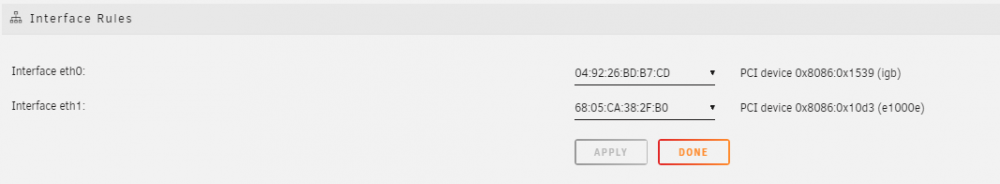

So my interface rules are set as follows: image.thumb.png.0a86447f335ed1b3a797b9872cc153bf.png

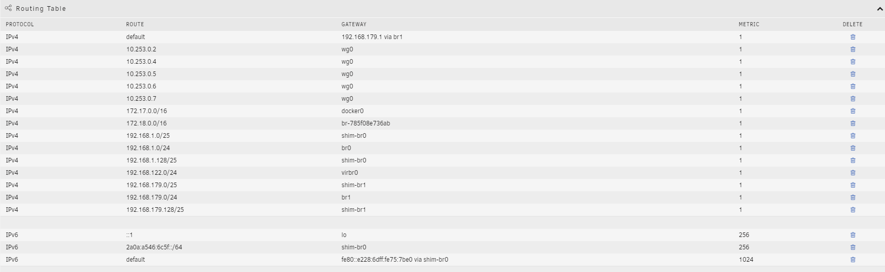

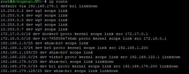

But after each reboot, unraid sets the default gateway to br1, like this: image.thumb.png.fbb300f3e484dd23bafb37a1f2a07782.png
It should use 192.168.1.210 via br0!
I can't delete the default route via GUI, so I do it after every reboot by hand via SSH.

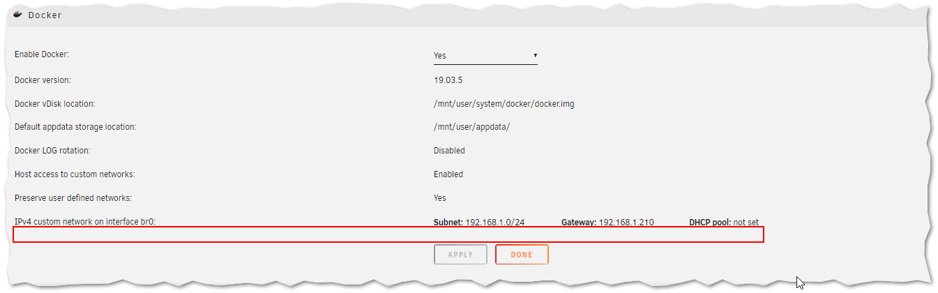

I've solved the docker issue for now. I changed the following setting:
There was a second entry for br1  with no gateway etc. I've unchecked the entry and restarted the docker service. The dockers are resolving the addresses correctly now. I have no clue, why a docker with an IP in the 192.168.1.0/24 net would try to communicate via br1 and its not available gateway. It's a mystery to me.
