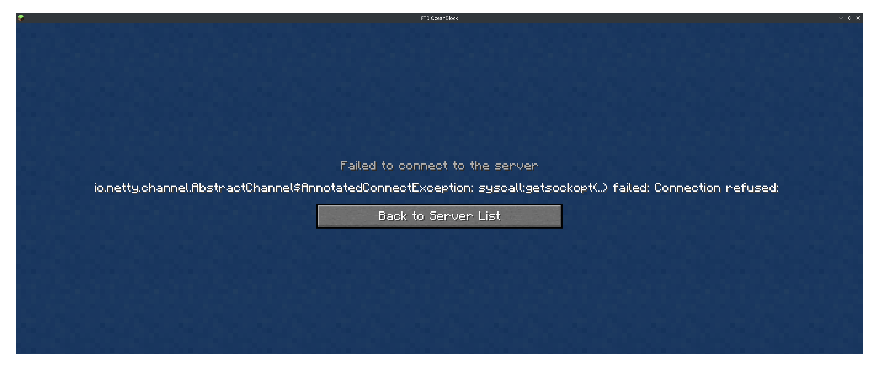

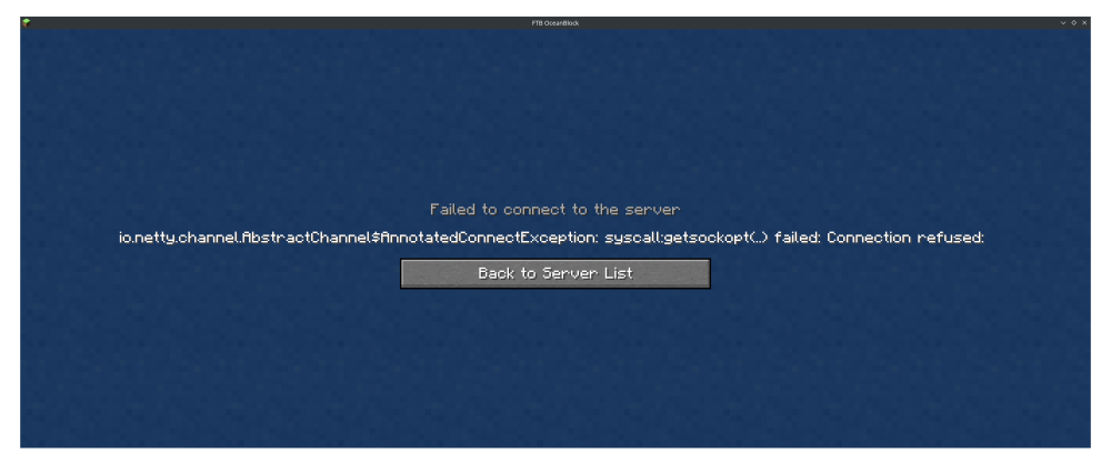

anyone have issues setting up a minecraft java server? I keep getting connection refused no matter what. It's driving me crazy. Everything appears to be setup properly. If i use another docker container with just a backend minecraft server i can connect to that server using the same exact settings i am using in AMP with zero issues.. If i then remove that server, then try to set it up in AMP i cannot connect.. So i know its not something simple like a firewall problem.. Any advice on whatelse to check? I've spent hours trying to figure this out.
