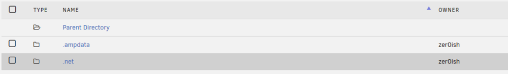

I have created a dedicated UID/GID for this container, and trying to run it with those by setting UID and GID container variables to what I created (1500). However, these seem to get completely ignored, the container always starts as my main unraid user.
I also tried using docker extra arguments "--user 1500:1500" but then the container does not start.
Any advice on how to set the runtime user?

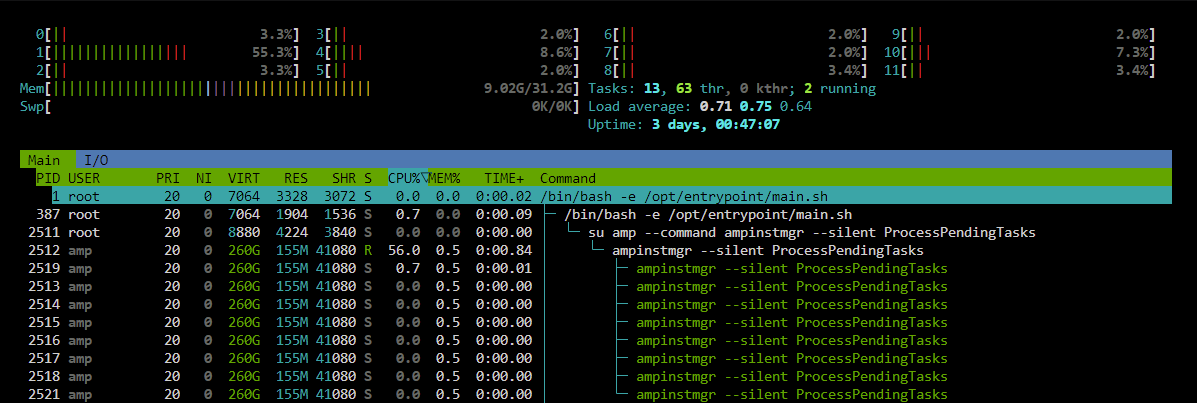

Im having CPU spikes with only a Minecraft Java Instance created but sleeping.
htop shows it being the command "ampinstmgr --silent ProcessPendingTasks"
I cannot find any Info anywhere to why this would be spiking the CPU usage every few seconds.
Does anybody have any Ideas?

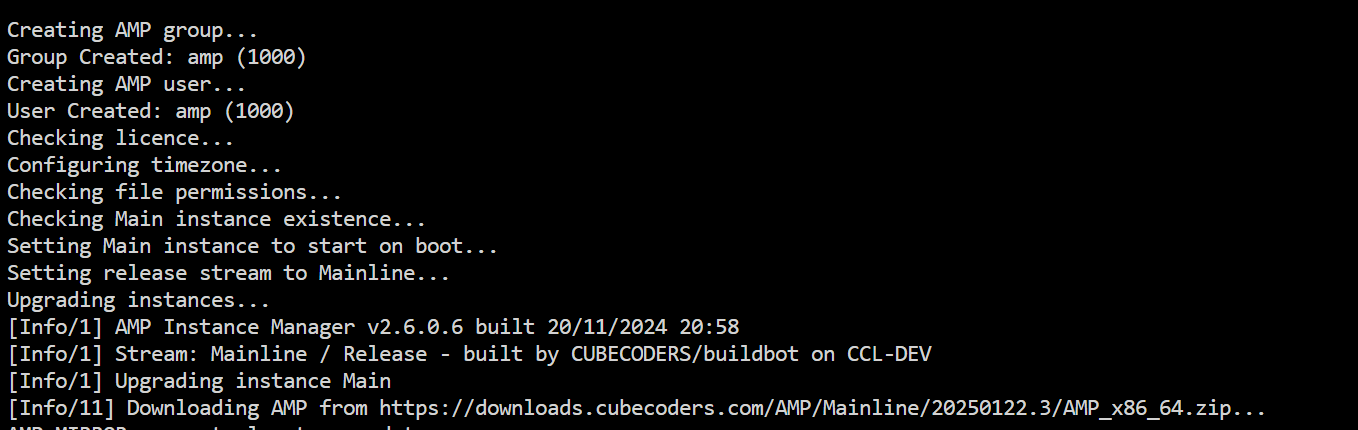

Hey,
I am having issues with access to my AMP this morning. Looks like it is trying to update, but it seems that it is not working and I dunno what to do.
It is stuck on the following if i check the logs:
Any one a idea how to solve this?
or how i would force to use the us server?

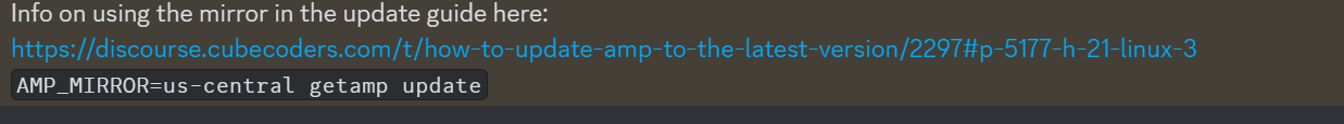

https://discourse.cubecoders.com/t/how-to-update-amp-to-the-latest-version/2297
Thanks for help
for anyone who has the same issue:
click on amp docker and user console and use the following command:
ampinstmgr --nocache upgradeall --mirror us-central
downloaded the update within seconds and amp is back running
Edit:
Did you ever get to the bottom of this? I'm suddenly experiencing this a week later when I've had 0 issues.

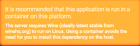

Hiya! I have to say first and foremost, I LOVE that this is containerized.
The only thing I dislike, or maybe I am just bad at making it work: Is games like Ark that need WINE and it needing to be dockerized within the docker, is not possible. Which is fine, I host those outside of the AMP docker. Other than that, this shit just makes everything super simple!
However, I've recently been trying to make my server more secure and be robust, and with that I've drifted away from using Bridge mode for all my networks, and using custom networks for all my containers etc.
When I switch AMP Docker to its own container, it no longer can communicate and bind ports. Is this because it has its own network IP and I am port forwarding to the server and not the network/IP of AMP?
I have not set AMP up with a static IP itself, so I am not sure if that is the problem.
I appreciate everything by the way and thank you again for making this wonderful container!
EDIT: I've read through the thread and have found my answer. ^^ Thanks. :)

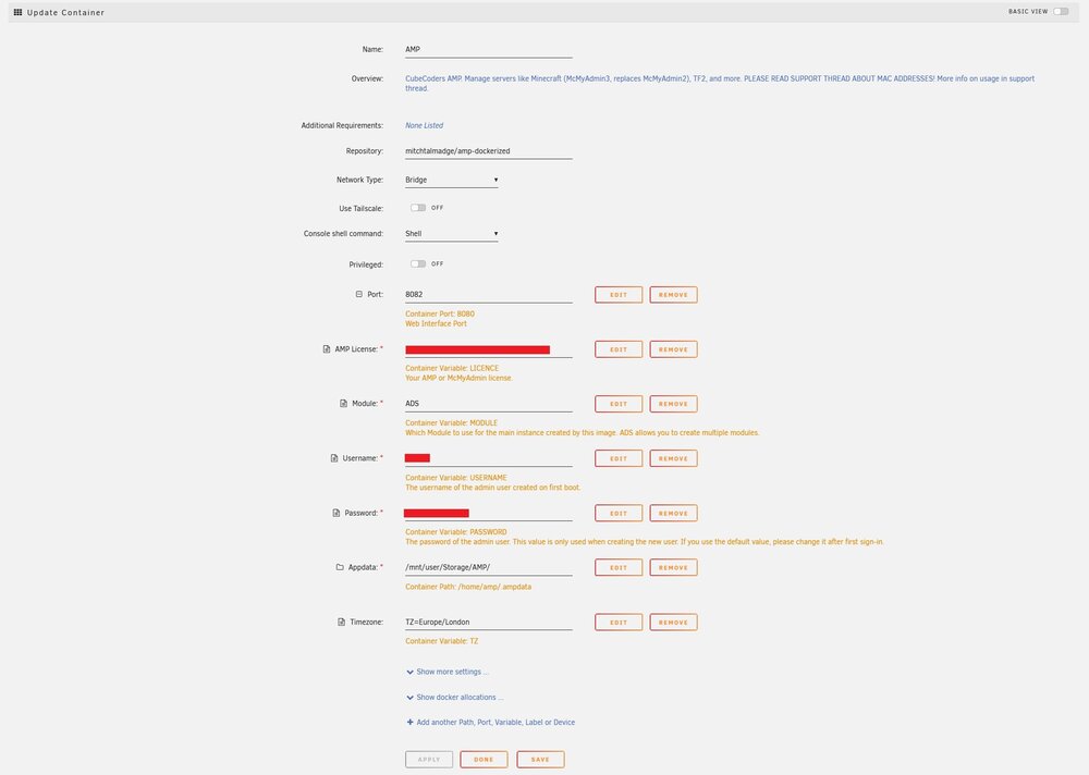

i can't get this to work at all, i create a minecraft java server and it says it's up and running but when i try to connect to the server on minecraft it says can't find server yet if i setup the same thing on crafty, it just works and that's free, what's going on?
It might be a port issue, can you show me your configuration for the container? Block out the password and license of course.
thank you for helping me, i have no idea why it's acting up, i have it fully port forwarded and working online with crafty4 and with crafty4 stopped and this started i just cannot get minecraft to see my server at all, whether that's using my dns address or local port.
also i did have it set to 8080 and just incase that was the issue i changed it to 8082 but that changed nothing.AMP Configuration.jpg
the amp page itself works as intended.
