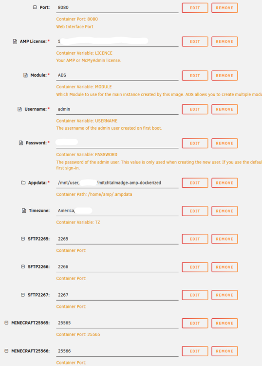

1 minute ago, RazorX said:
thank you for helping me, i have no idea why it's acting up, i have it fully port forwarded and working online with crafty4 and with crafty4 stopped and this started i just cannot get minecraft to see my server at all, whether that's using my dns address or local port.
also i did have it set to 8080 and just incase that was the issue i changed it to 8082 but that changed nothing.AMP Configuration.jpg
You’re just missing the Minecraft port :) At the bottom of that page click on the button like “Add another Path, Port, …” and then set it to Port, with value 25565 in host, container, and default. Use TCP as the protocol. Like this:
ok will do, i didn't know i needed to add it on this as it wasn't part of the default config, i believe it was on crafty4, i will give that a try thanks.

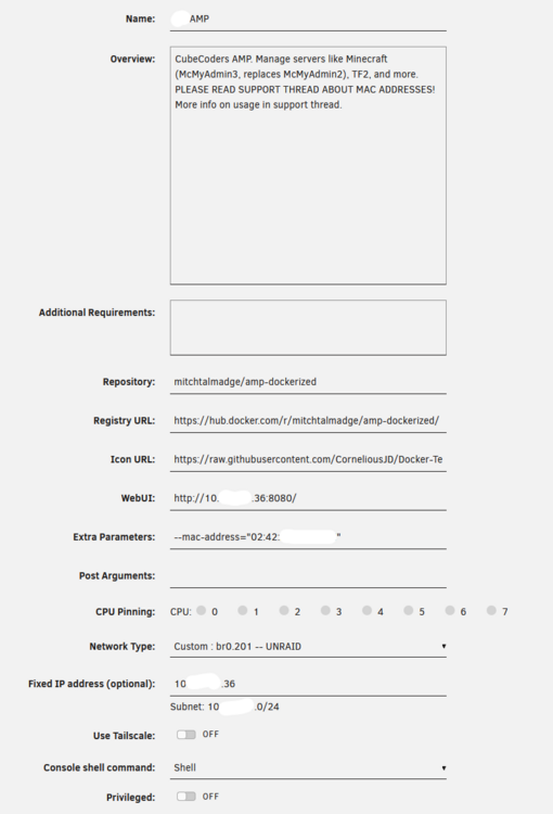

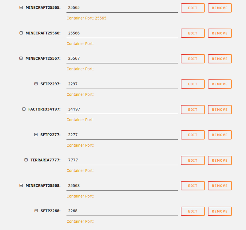

Yeah, sure thing! No worries. I hope I got all of the sensitive data. Here are screenshots.
I did not change anything in AMP to my knowledge. The change I was making was removing some VLANs that are no longer needed and then adding a new one for a new project. None of which were the network or VLAN that AMP uses.
Thanks! Your config looks fine. I tried creating a 2.6.4.2 instance and upgrading to 2.7.0.0, but it didn't cause the same problem you had. I wasn't able to reproduce it. However, we can probably still fix it. Can you answer these for me?

Answers to your questions:
1. ADS01, 4 x Minecraft servers, Main, 1 x Factorio server and 1 x Terraria server.
2. There is just 1: "InstanceName": "ADS01"
3. Yes, lots, 99 in fact. Dating all the way back to 2024. So that's great. The last one that looks good is: instances.json-20260301.bak.
Here is what I did. I renamed the current instances.json to instances.json-20260307.2.bak. Then I copied instances.json-20260301.bak and renamed it instances.json. Then I moved the instances\ADS01 folder to my workstation, so it's off of the server. Since I suspect that one to be the problematic one. Now the instances.json file matches the file system. Then I turned my container on and it did the same thing. It created an ADS01 folder and started a factory instance. I removed the new instances.json, re-copied the last known good instances.json, edited the file to change Main to ADS01, deleted the new ADS01 and then copied the old Main and renamed it ADS01. I then had to hop in the CLI and run 'su -l amp' and then 'ampinstmgr reactivate Instance_Name_01' for each server. All of my servers are up now, hooray! I will try restarting the container at another time. I don't have time to do much else today.
I appreciate your support! Thanks so much. AMP really is a great tool, so thanks for doing the work to make it available to us all on Unraid.

First image is when trying to install Abiotic Factor. The 2nd deployment log is when trying to install Astroneer. Thanks
If you really want to use CubeCoders AMP on Unraid to be honest a docker container is by far the worst way to do it. It really needs its on system. If you must run it on Unraid do so within a Debian VM. Trying to run containerized game instances inside an AMP Docker container that’s the problem. You’re stacking container runtimes on top of each other. Im not saying you can't get it running just saying it's wrong way of going about doing it.
Understood, but i can't even get a non containerised version working of Astroneer. And Abiotic Factor is recommended as a Container, so Im just sharing my experience. If they work that'd be enough but I'm facing issues right now as above.
