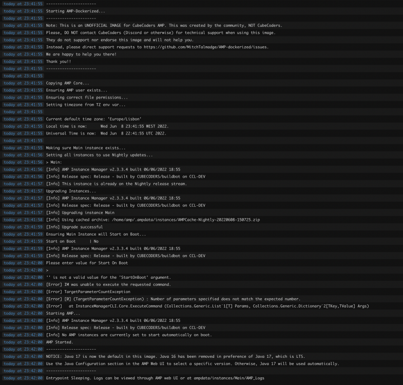

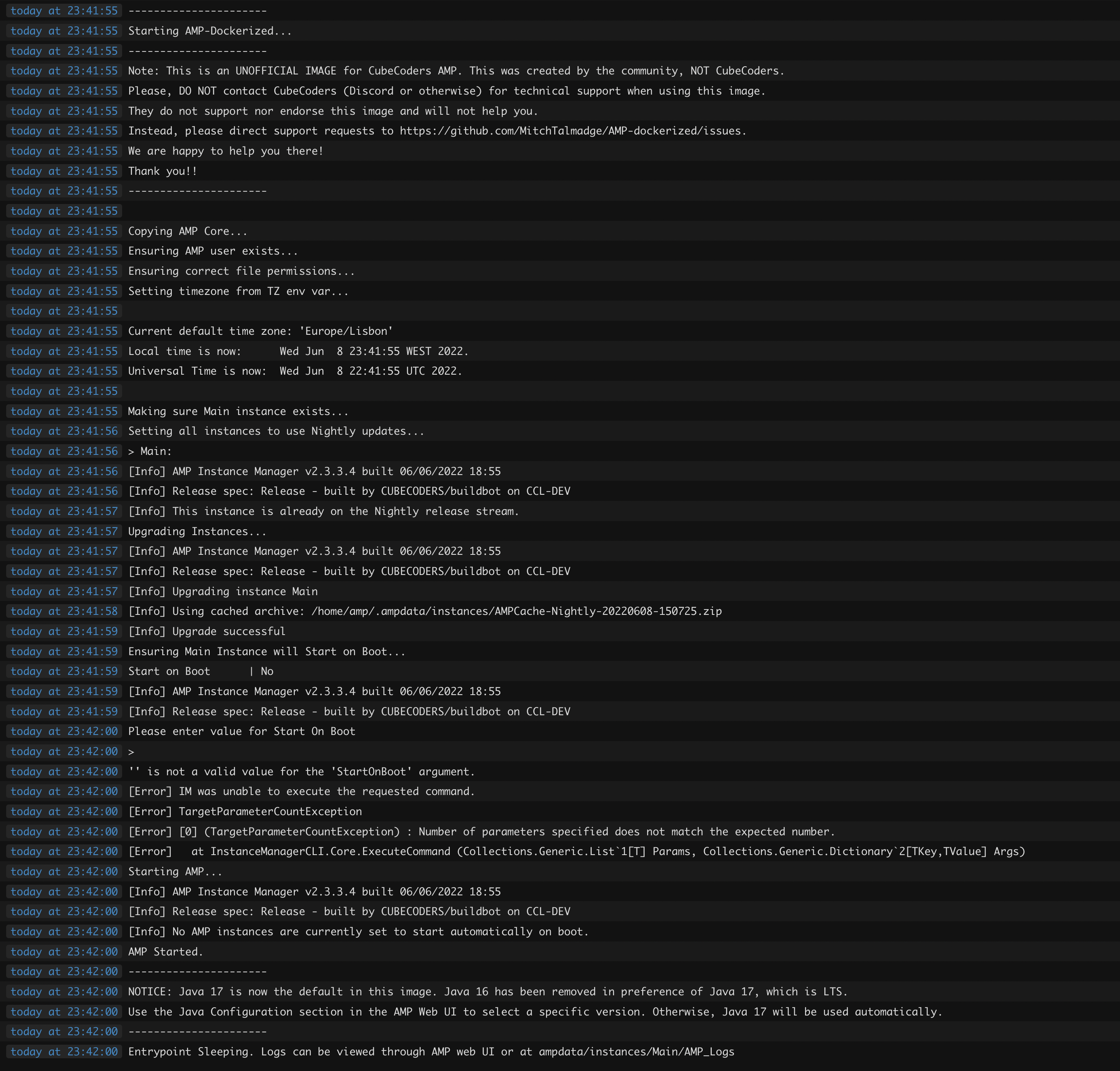

    It looks like the StartOnBoot command syntax changed. I'll need to find a workaround
  • MitchTalmadge
    MitchTalmadge
    Hello, if everyone experiencing the web UI problems could try out the following image, I think it will solve your problem:   mitchtalmadge/amp-dockerized:staging-startonboot   @xXMrZom

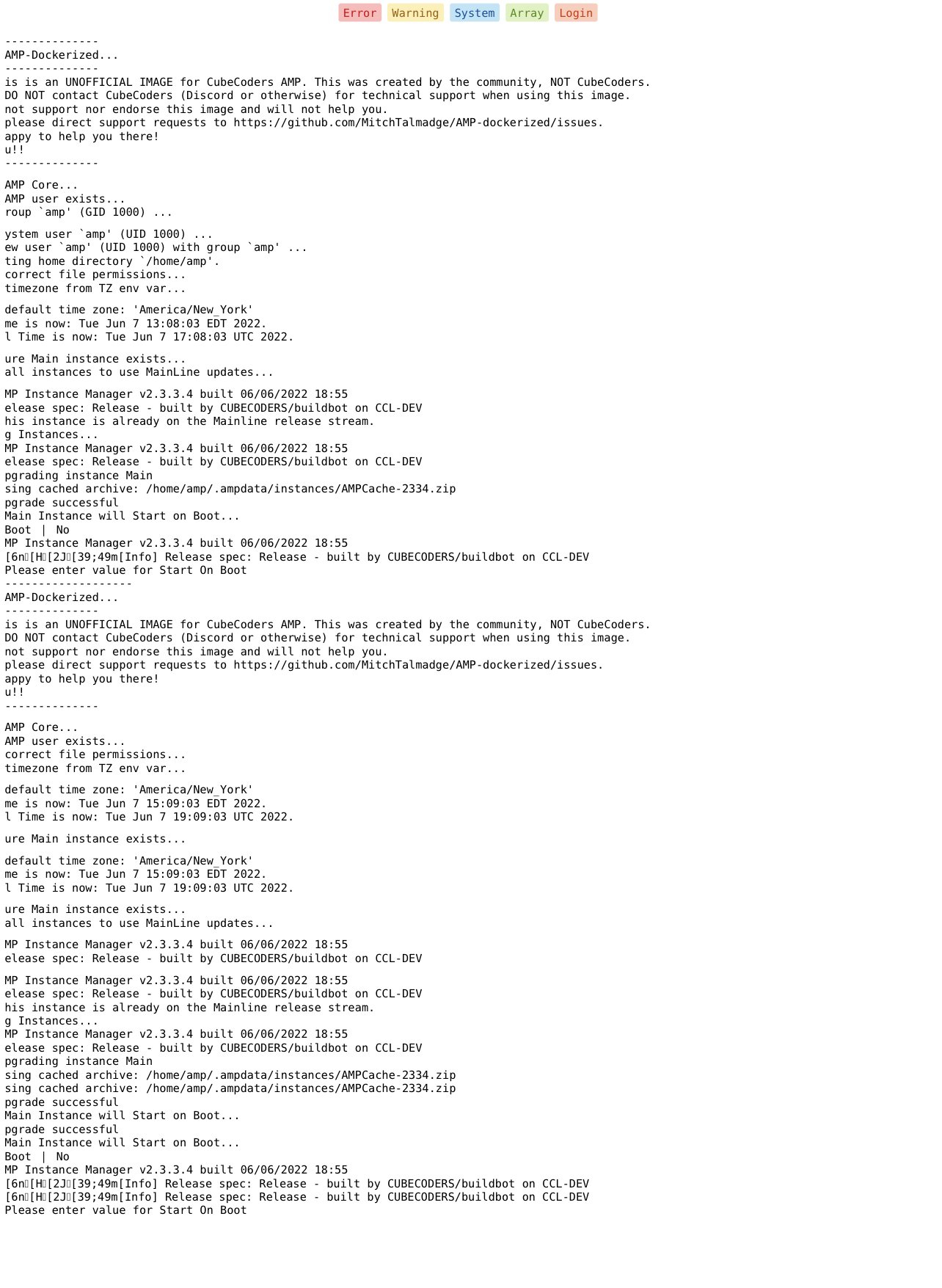

Hello, I’ve been running into an issue when I install this docker on Unraid. When I follow all instructions and install I try to visit the WebUI but it never grabs the website. I only change the TZ and MAC address settings. With the addition of the license.
What do the docker logs say?
This is all I am getting.
thanks, I just tried setting up a brand new container of AMP as well and see the same thing.
@MitchTalmadge are you able to see what might be up for deploying brand new containers w/ the :latest image? It no longer seems to be working, can't get web UI to load.
thx in advance!
Note to @xXMrZombie20Xx if Mitch doesn't reply here within a few days it might be best to post these logs on his github for the project here: https://github.com/MitchTalmadge/AMP-dockerized/issues
thx in advance!
Yeah I'll see if I can reproduce it

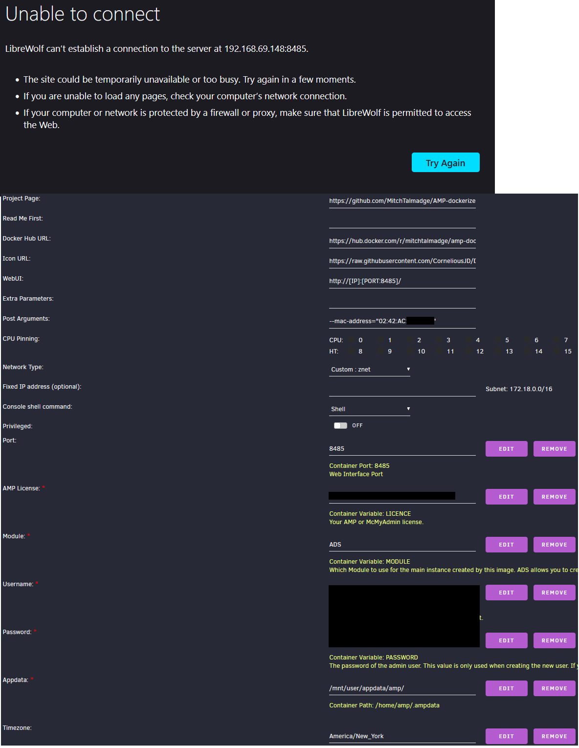

Installed the amp from apps gallery, but cant hit the webui.
Port 8080 is used by another container so i assigned port 9999, but cant reach web ui.
Anyone can help? Thanks
Edited by synnc
no text
@xXMrZombie20Xx @CorneliousJD @synnc
Thanks!
Thanks!
This has worked for me so far thank you.
I'm glad to hear that it works. You can change back to the latest image now (mitchtalmadge/amp-dockerized) as I have pushed this patch to latest.
try switching to advanced view and changing this as well as the port mapping:
1281515845_Screenshot2022-10-21at20_51_09.thumb.png.fd2b65bdfdb4a94395adeb510776ecdc.png
