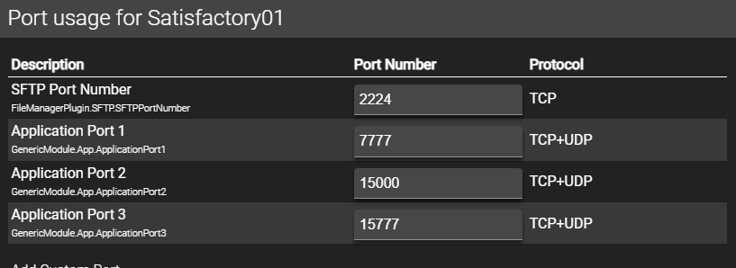

im having real issues getting satisfactory working, seems that the ports are not allocating within the docker. i have set everywhere I Can but when launched the only port showing as active is the webserver port., port 1 2 and 3 are set just not allocated when you do the ampinstmgr ports command.
this is the error below.

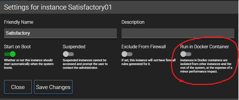

So I am having an issue where the Create in Docker Containers slider tells me it can not find docker, or something similar to those words, I am not currently able to check. Is there something I am missing? I am currently running local instances inside the AMP docker, and I think it is causing performance issues, for example my Project Zomboid server takes  30 minutes to restart, when my friend using the same server files on a windows 10 machine using the normal AMP application is seeing 5-10 minute restarts. I am pretty new to unraid and AMP so I am sure I did something wrong lol. I appreciate any help!

how can i run Instances in Docker containers

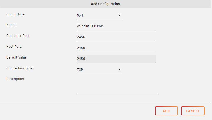

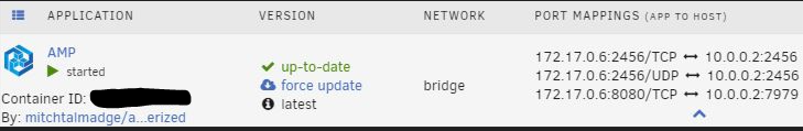

I had some trouble with getting AMP going in UnRaid as I'm brand new to both it and Docker. For any other newbies that may be cruising around looking for a brief step-by-step, I hope this helps. **As an aside, this is primarily for addressing port issues**
My goal was to migrate my existing Valheim world from my ancient Dell R300, bare metal Linux server, to my newly built custom chassis with UnRaid. Here's what worked:

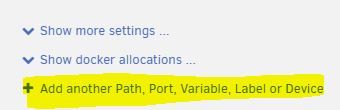

Edit the AMP container and follow these instructions:

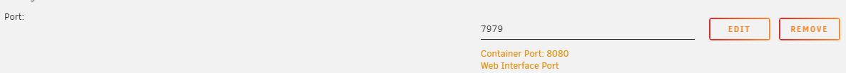

  • By default, the container will have a 'Port:' variable for you to populate. You'll notice in that variable that it's commented as 'Web Interface Port'. This will be the port you use to get to AMP's GUI. Pick a port that's not being used by anything else on your network.
  • Now we need to add the ports the game server needs. For my Valheim server, port 2456 is default, so that's what I'm going to add. First, navigate to the bottom of the page and click "+ Add another Path, Port, Variable, Label or Device".
  • On the configuration window that opens, select "Port" from the drop-down, choose a name for the new config. (this can be anything you like), and then put your game server port in "Container Port", "Host Port", and "Default Value". Now, for connection type, you're going to select TCP or UDP. You'll need both of these, so once you finish creating this one as TCP, you'll create another config. for UDP using the same ports.
Once you have all of this done, you should see all of these ports being mapped to AMP in your docker tab

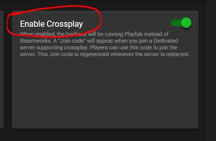

And now, specifically for the folks who want to run a cross-play Valheim Server, you'll need to do a couple of things before it will work.
  • Enable cross-play in your Valheim configuration in AMP
  • Next, you're going to need to install some dependencies in your AMP Docker container. To do this, navigate to the Docker tab in Unraid, click on the AMP icon, and select Console. Your first command should be 'apt update'. Once the repo is updated, enter this: 'apt install libpulse-dev libatomic1 libc6'. Once these packages install, restart AMP and you should be good to go.
Most of this is probably common knowledge, but I hope it helps someone!
With AMP being dockerized is possible run a AMP game instance in docker mode? I want to be able to set CPU & Ram limits on certain games.
