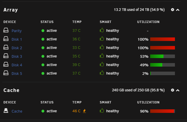

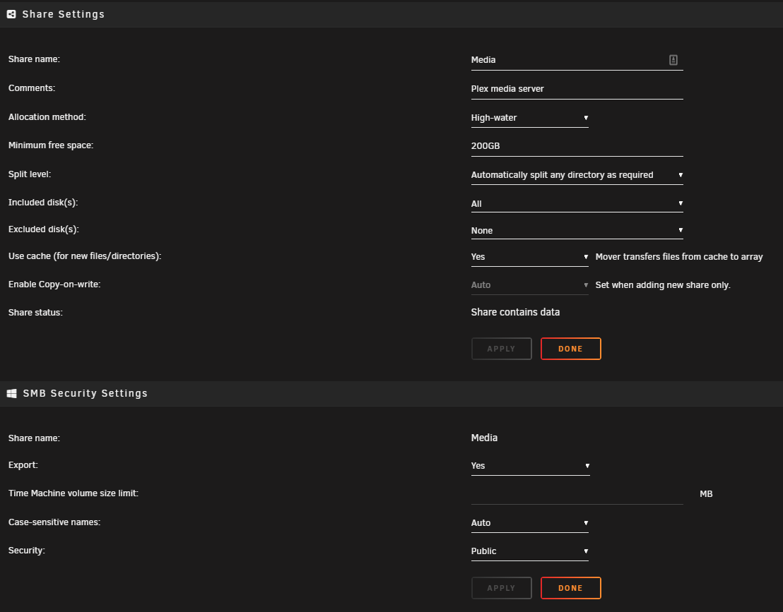

I have a problem with a share on my UNRAID server. It seems like it won't move files from my SSD cache to the 3 disks which aren't full.
I have looked around for a solution, but can't seem to find any.
The problem is my "Media" folder. And as you can see on picture 1 the first 2 disk are full - and so are the cache.
I'm using the high-water method, so as far as I understand it, the other disk should have been used a long time ago. I have tried to run the Mover, but nothing happens. It seems like it just keeps adding to disk 1 and 2.
The server was at first setup build with 3 disk (1 parity, 2 array), and I have later added the other 3 disk, which is then added into the share setting. I don't know if UNRAID has some problems with adding new disks to existing shares?

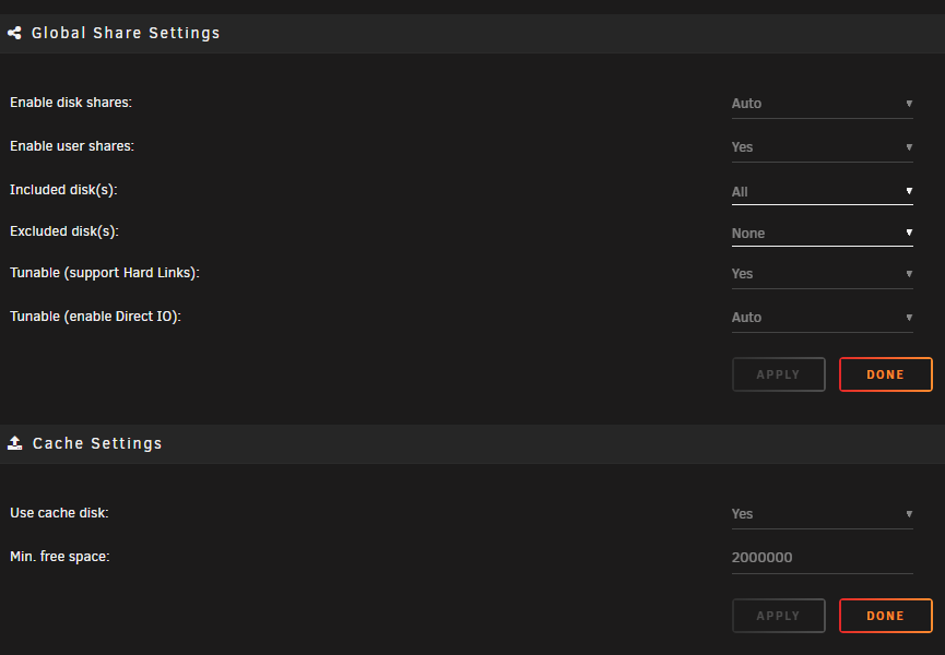

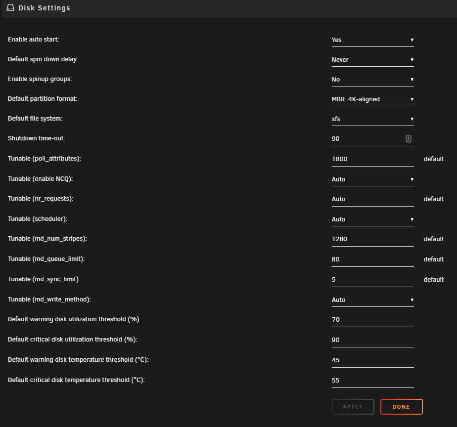

I have also looked into the global disk setting, and for me it looks good. (Picture 3).

Edit: Forgot the global share setting.
Picture 1:
Picture 2:
Picture 3:
Picture 4:

Post up the screenshot of the Share settings for   Downloads.
Oh god... I was so focused on the Media share, that I didn't realised that I was looking the wrong place...
Problem is solved. Thank you so much Frank1940!
