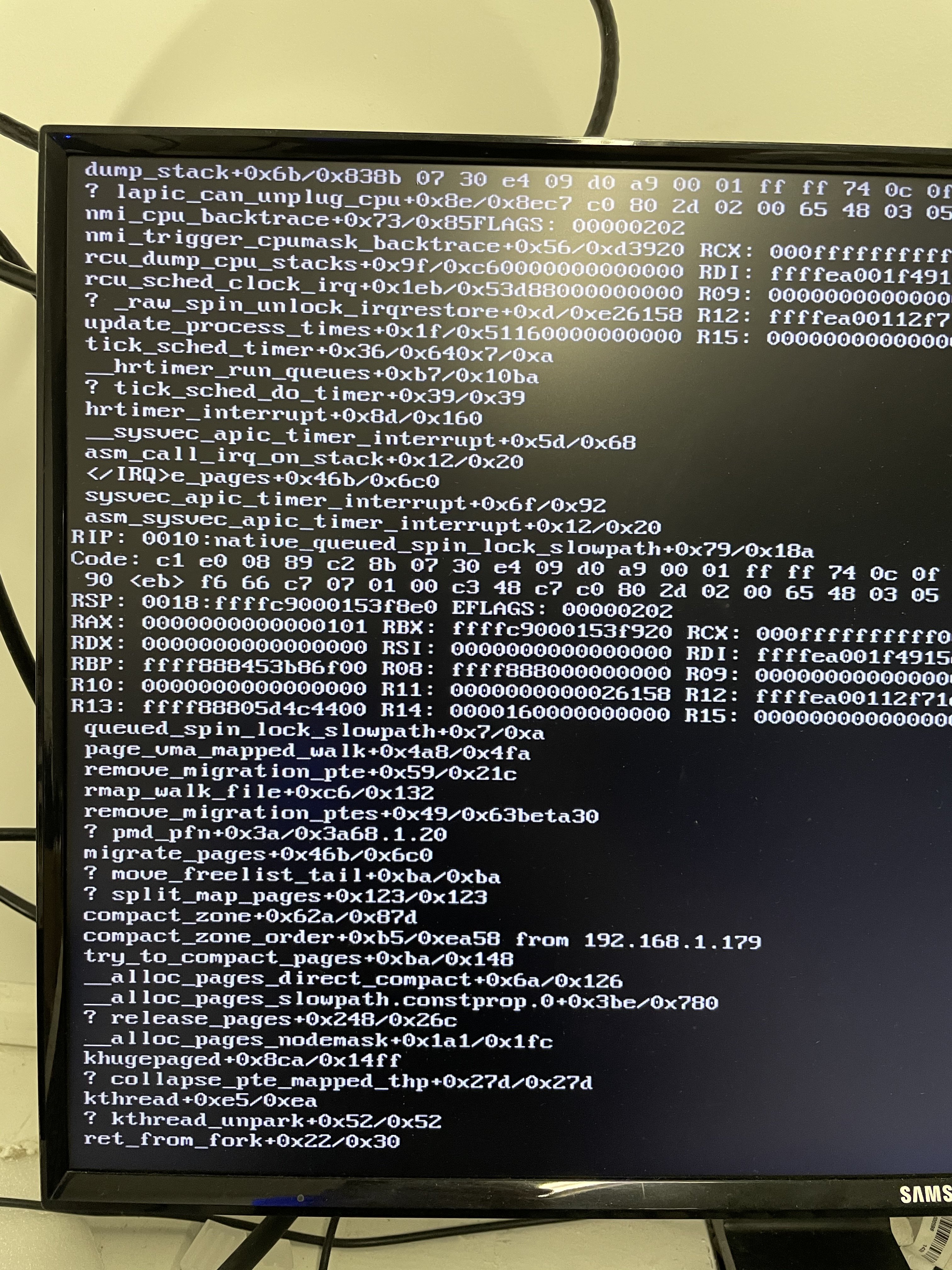

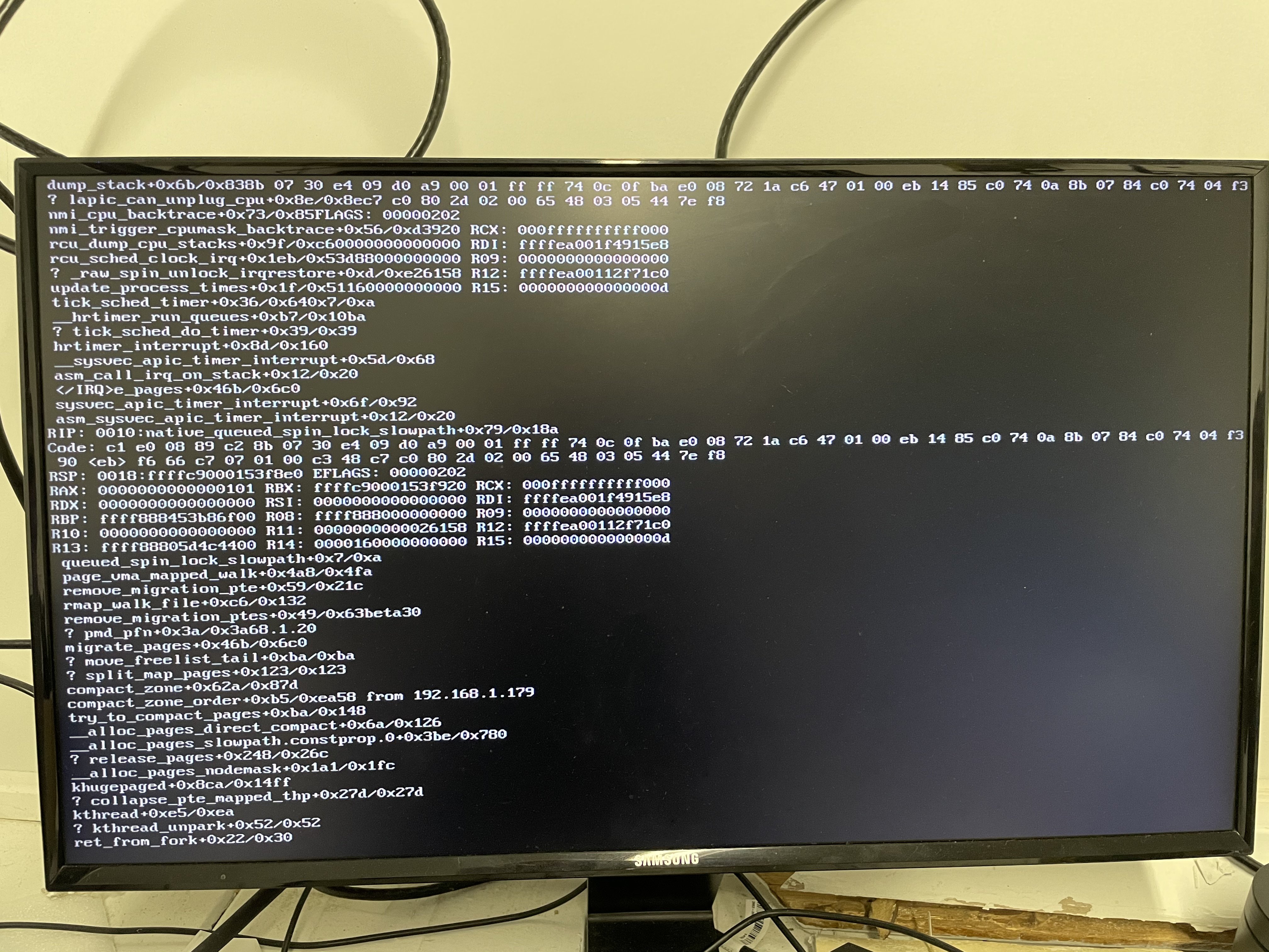

OK, another failure overnight. Was able to get a screenshot showing a kernel panic (attached). I did setup Syslog to Flash, but I'm not seeing any items in the logs folder on the flash that would be what I'm looking for. The only log in there with a date from the last week is from unbalance.
Thanks again for any help.

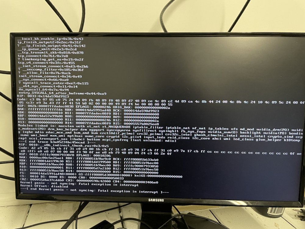

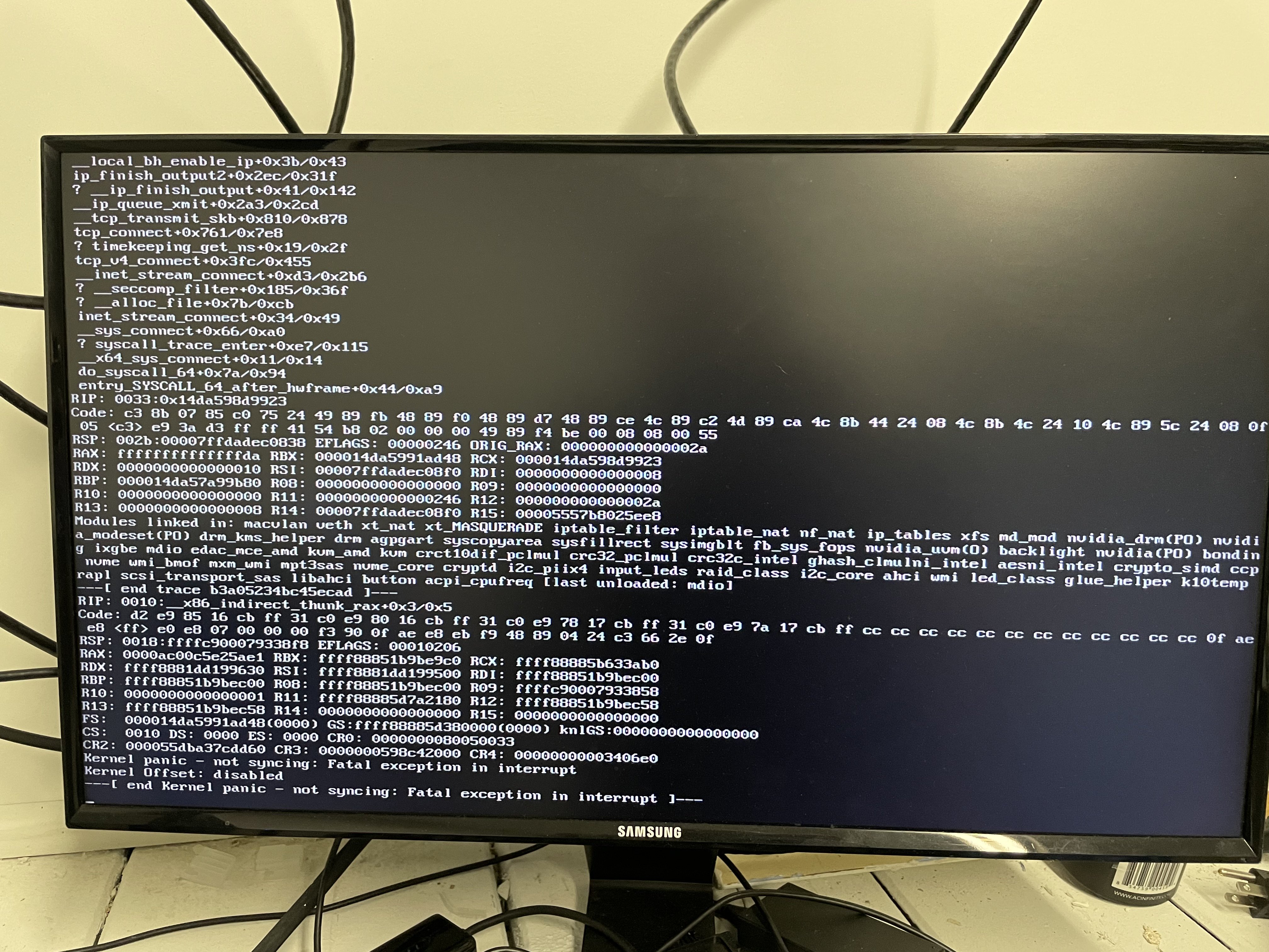

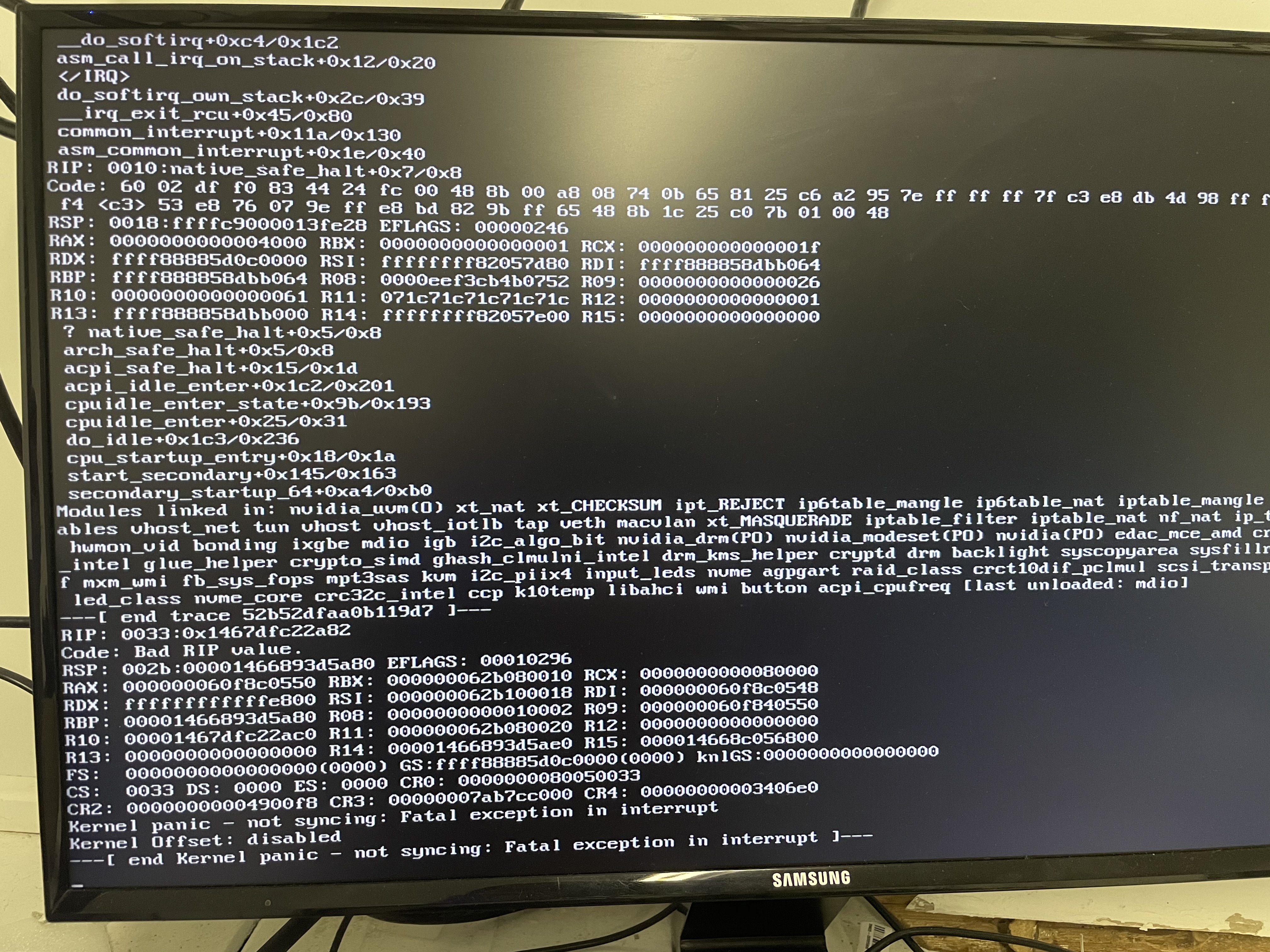

Another kernel panic overnight, screenshot attached. (have had a few over November, but have been so busy with a baby coming that I just didn't have time to get a screengrab and make a post)
I was certain I had enabled local syslog server, but it was disabled when I checked now. I have enabled it for when the next kp will undoubtedly happen.
Any help would be greatly appreciated.
