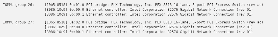

I recently bought and installed a intel 82576EB Quad port Gigabit NIC card in my Unraid server. The installed NIC is not discovered by Unraid. I quickly checked the forum and found:

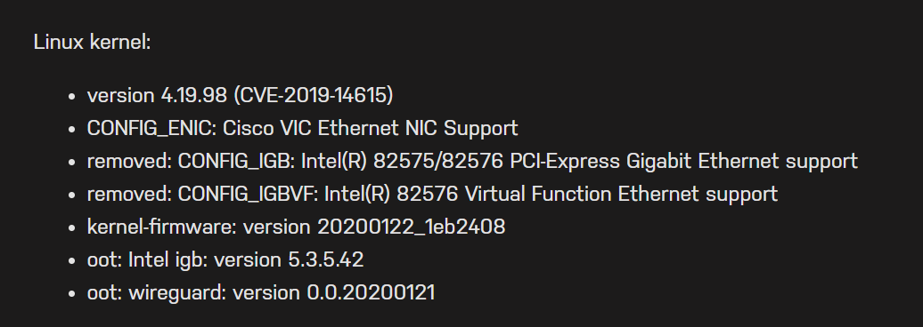

and it mentions, that the support for intel 82575 and 82576 has been removed in linux kernel used for v6.8.2 (picture attached). Is that the reason I am not able to see the NIC in unraid? Just want to make sure before I make another purchase. If anyone has good experience with quad NIC a recommendation is really appreciated.

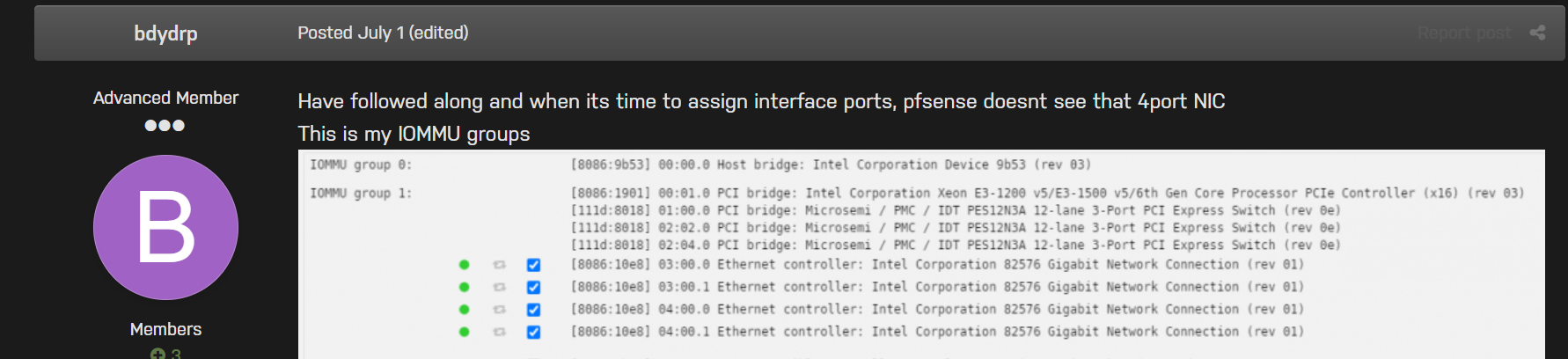

Ok, I found another post from July, where the 82576 is working. So in that case why I cannot see it in unraid? any insights?
