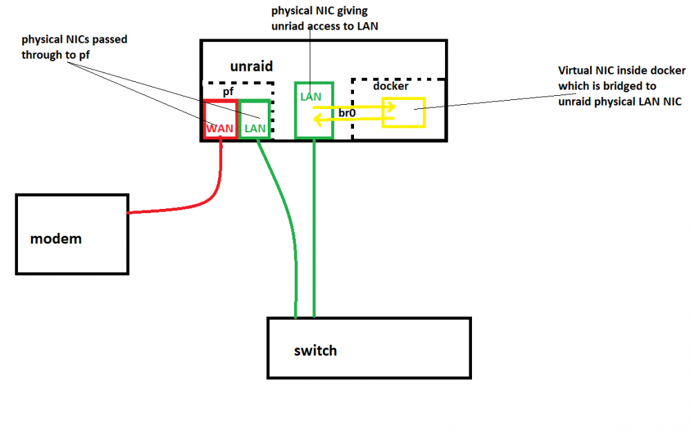

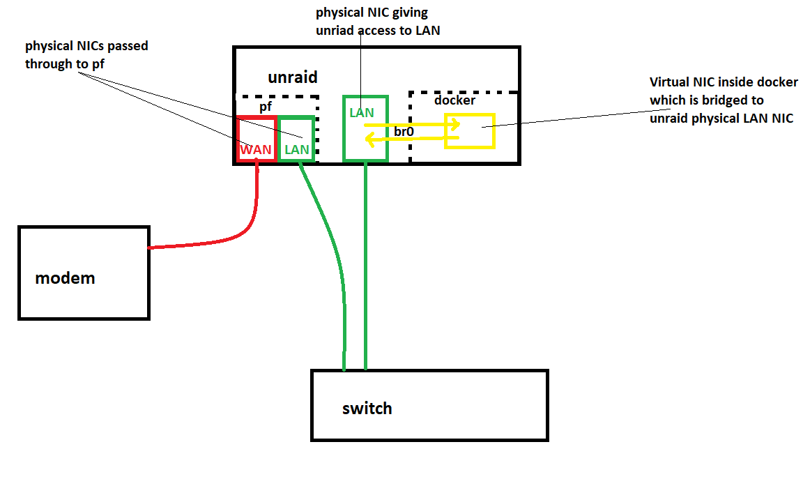

1. I assume your network setup is similar to the one I have pictured below? As far as pf is concerned your Unraid box only has one MAC address and as such the other IPs that exist in docker are reached through you unraid box over the docker bridge br0.
I did look into this before and it seems you would need to use a docker macvlan where each container is assigned a virtual MAC address and can then reach out to the pf box for an IP. I never went any further with this myself but there is info here https://docs.docker.com/network/
let me know if you get anywhere with this as I'm interested in my containers showing as physical devices on my network.
I assign an IP to the container when its created (its in the range of reserved IPs from pf DHCP settings for LAN. I can then get to that IP address via LAN (look at attachment custom br0). However this is just for one or two containers which need it.

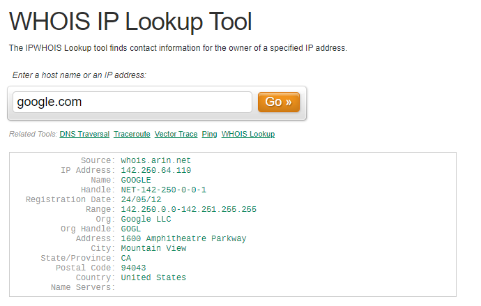

a) So when you access from LAN are you going to nextcloud."your domain".whatever or are you doing "server IP":"nextcloud port"?
b) Have you tried accessing the service via the domain name from outside your LAN ie using a mobile phone not connected to Wi-Fi?
c) Does you domain resolve to your external IP?
type you domain name in here https://www.ultratools.com/tools/ipWhoisLookupResult
the result should match the one given here https://whatismyipaddress.com/
^^^^if your using cloudflare for you DNS make sure you have the cloudflare proxy turned off when you do this^^^
