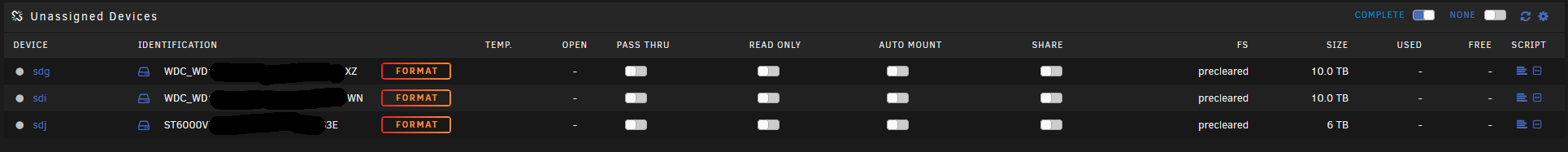

I am trying to add 3 new drives to my existing array on Unraid v6.8.3 and my Preclear Disks plugin was updated on 2020.10.22. I have run preclear on the new drives, which completed successfully, and the drives show the precleared status in Unassigned Devices. The drives were precleared in my server chassis (i.e. not in some external enclosure). This is shown below.
I am having the issue that when I go to add the precleared drive to the array, Unraid is stating that it wants to clear the drive again. Here are the steps I am taking. I add the first drive (sdg ending in XZ) to disk slot 6

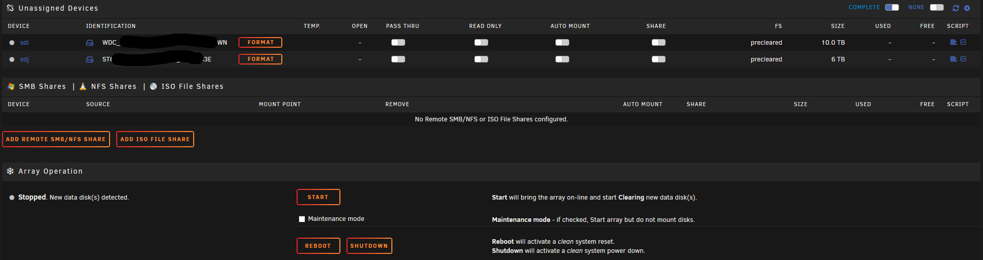

Then looking at the Array Operation area it shows that when I start the array it is going to clear the drive.
This is the part that I don't understand. It was my understanding that if I were to preclear the drive in advance, then when I add it to the array Unraid wouldn't need to clear it again. Am I doing something wrong in the order in which I am adding new drives to my array? Any advice/suggestions would be much appreciated. Thanks.

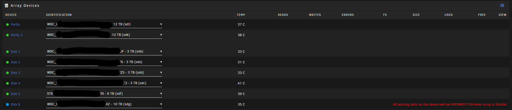

So I hate to answer my own question, but I took the plunge with my 6TB drive and added it to the array. It immediately showed up in the drive list as unmountable. Going down to Array Operation, I had a new option to select format drive. Once accepting the warning and clicking yes, the format took a couple of seconds and then the drive was online in the array. The disk was not cleared again.
It might be worthwhile to change the text, as "start Clearing new data disk(s)" is wrong. The disk was not cleared again.
