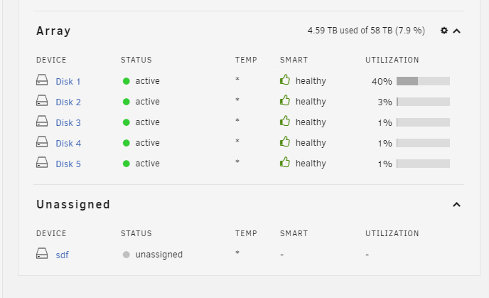

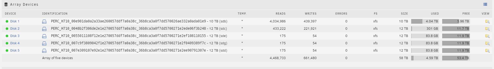

I have noticed that my Read Speeds have been about half the speed as my writes. I did not setup ssd cache yet as an fyi. My write speeds are over 100MB/s and but read speeds when copying a file from unraid are between 40-65MB/s. Speed test from the server look good and from the desktop that I have the drive mapped my read and write speeds to my synology nas are over 100MB/s.  I am a bit new to unraid so I was not sure if it was a setting I am missing.  I am running unraid 6.8.3. Thanks in advance for any advice. :) Let me know if you need anymore screenshots or info.

You shouldn't be using a RAID controller. That can cause a number of problems though that may have nothing to do with the speed you see.
Go to Tools - Diagnostics and attach the complete Diagnostics ZIP file to your NEXT post in this thread.
Attached! Ill have to look and see if I can add the drives without using the raid controller. The only way I could get unraid to see the drives is using the raid controller when I first set it up. Ill have to do some searching on dells site.

You could flash your raidcontroller to IT mode, but make sure you have a backup of your files before you do that.

Thanks! I will check this out. I did not know about IT mode.
