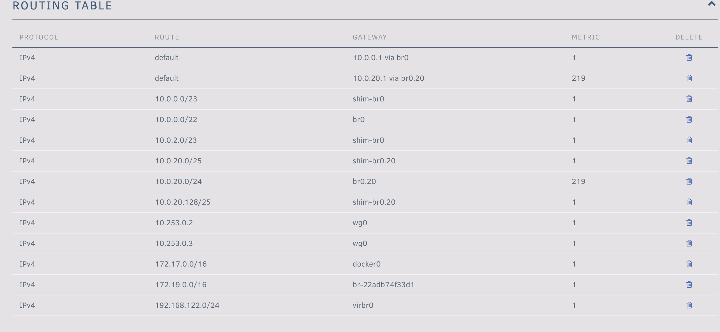

So I don't have any custom networks right now, just one VLAN. I attached my routing table...
Server went down again because of this....
Not sure what to do... I suspect it is some misconfig when I changed out MB and CPU.
