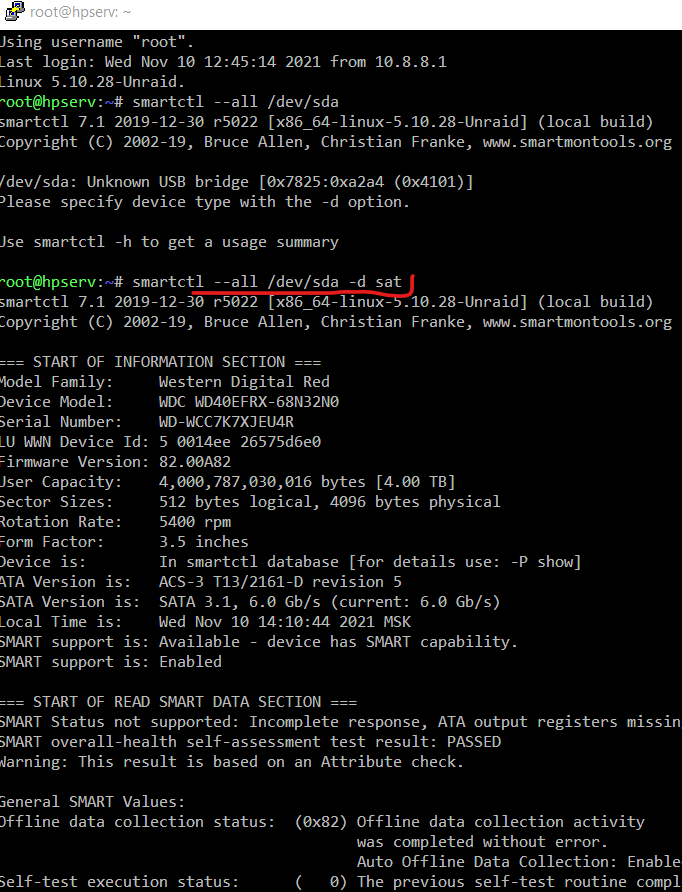

November 10, 20215 yr I have one with JMS578 on a board. Works perfect. But i can not see SMART. i found something about JMS578 - it is needed to use smartctl with -d sat parameter. But how to insert this in Unraid webUI ? Edited November 10, 20215 yr by Nuke
November 10, 20215 yr Author 5 hours ago, Nuke said: i found something about JMS578 - it is needed to use smartctl with -d sat parameter. You should post this as a bug report.
