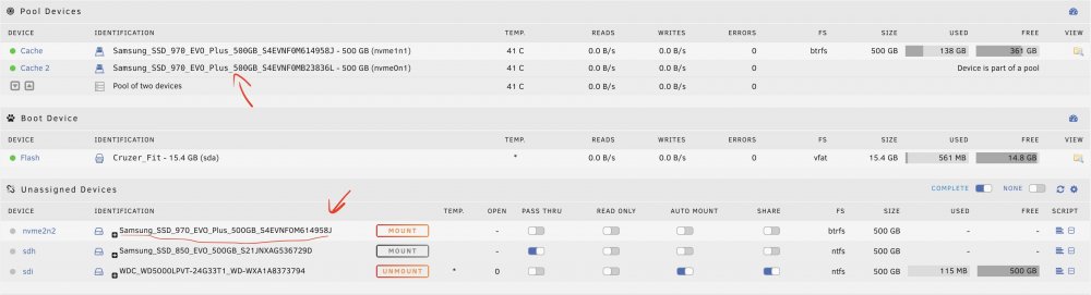

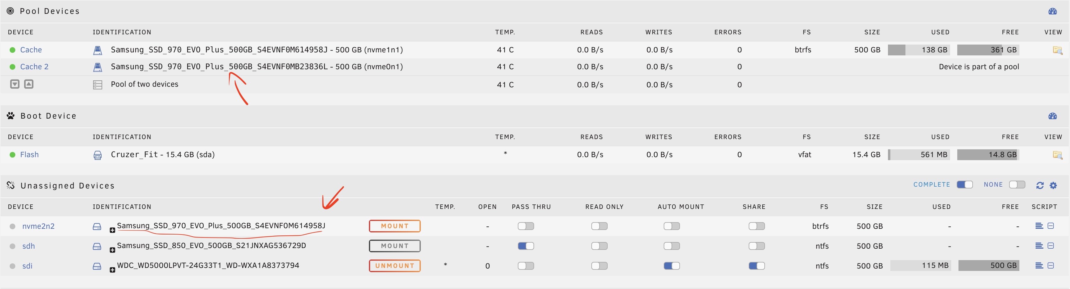

1. Problem: my 2nd SSD in the Cache-Pool is in the cache-pool and displayed as unassigned device?!

Please post current diags.

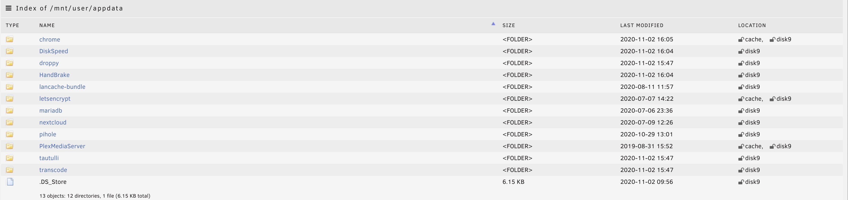

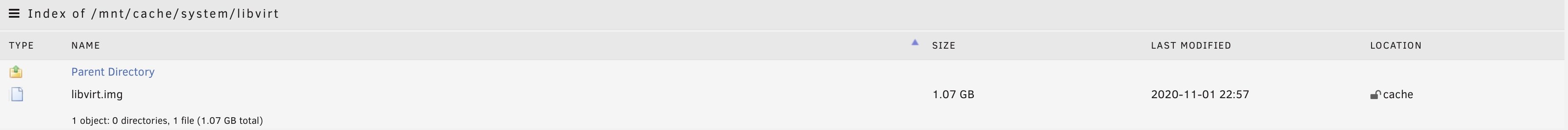

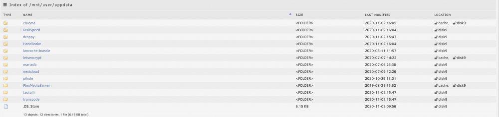

Yes, there are definetly files still on the cache. One is the libvert.img and appdata-files from plex. You can look at the pictures. And here is my log and diagnostics.

The mover cannot touch used files. Did you deactivate the Docker service before running Mover ?
no, I deactived the Docker service afterwards. What can I do now?
