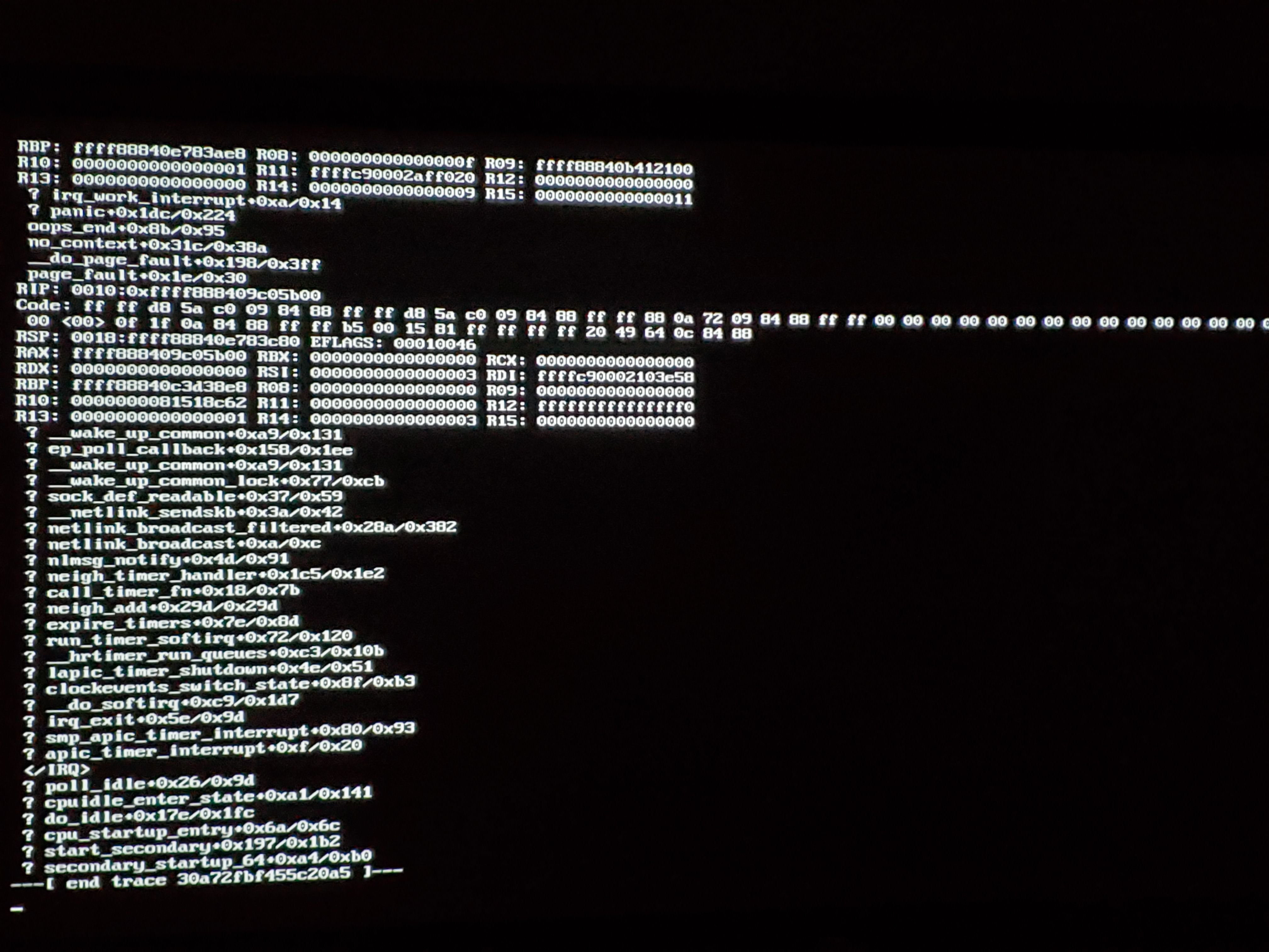

Server is crashing every night.
I'm in the process of running memtest to rule out the ram as the logs don't really show any obvious errors that I can see. The only ones that stand out are:
Oct 29 06:26:43 Tower kernel: br0: received packet on bond0 with own address as source address (addr:xx:xx:xx:xx:xx:xx, vlan:0)
which is also the last entry in the log file before crashing.
I uploaded the diagnostics archive, however the log file inside wasn't the full syslog server logs so I uploaded that separate as "syslog-full.txt"
I also took a picture of my monitor as it looked after a crash, it was stuck on this screen. Most of the time after it crashes it just gets stuck on the usb OS boot selection screen, however.

36 minutes ago, trurl said:
