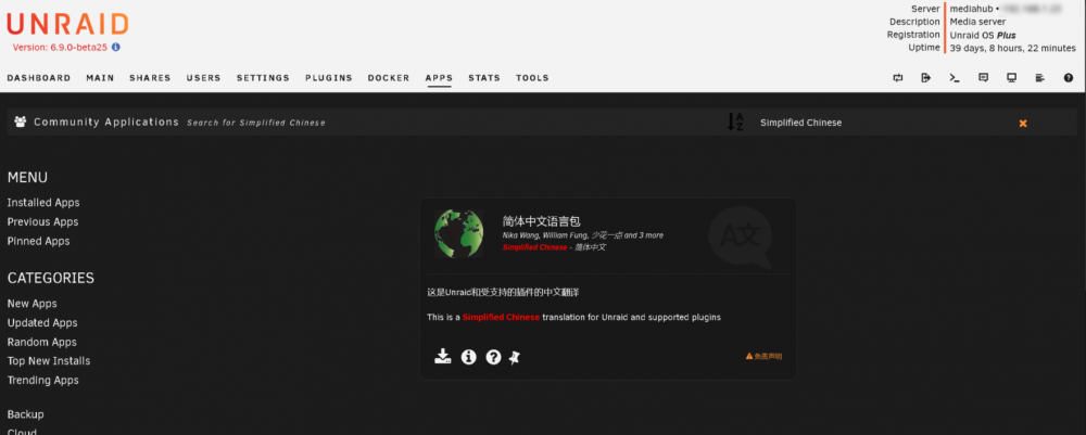

October 30, 20205 yr Author 19 minutes ago, JorgeB said: https://s3.amazonaws.com/dnld.lime-technology.com/next/unRAIDServer-6.9.0-beta30-x86_64.zip 6.9 Version support Chinese?
October 30, 20205 yr 1 hour ago, FameKing said: 6.9 Version support Chinese? You would need to install the Community Applications plugin : Then go to Apps and install the Chinese language pack.

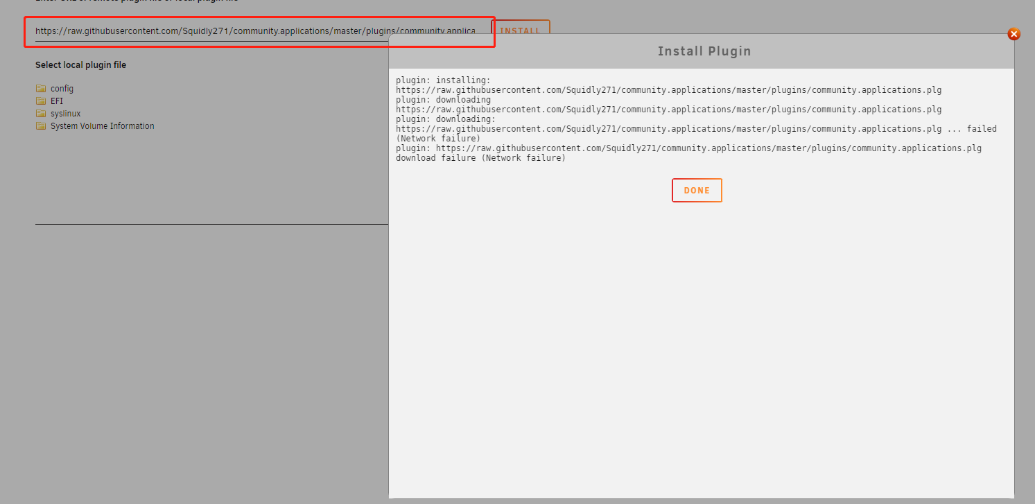

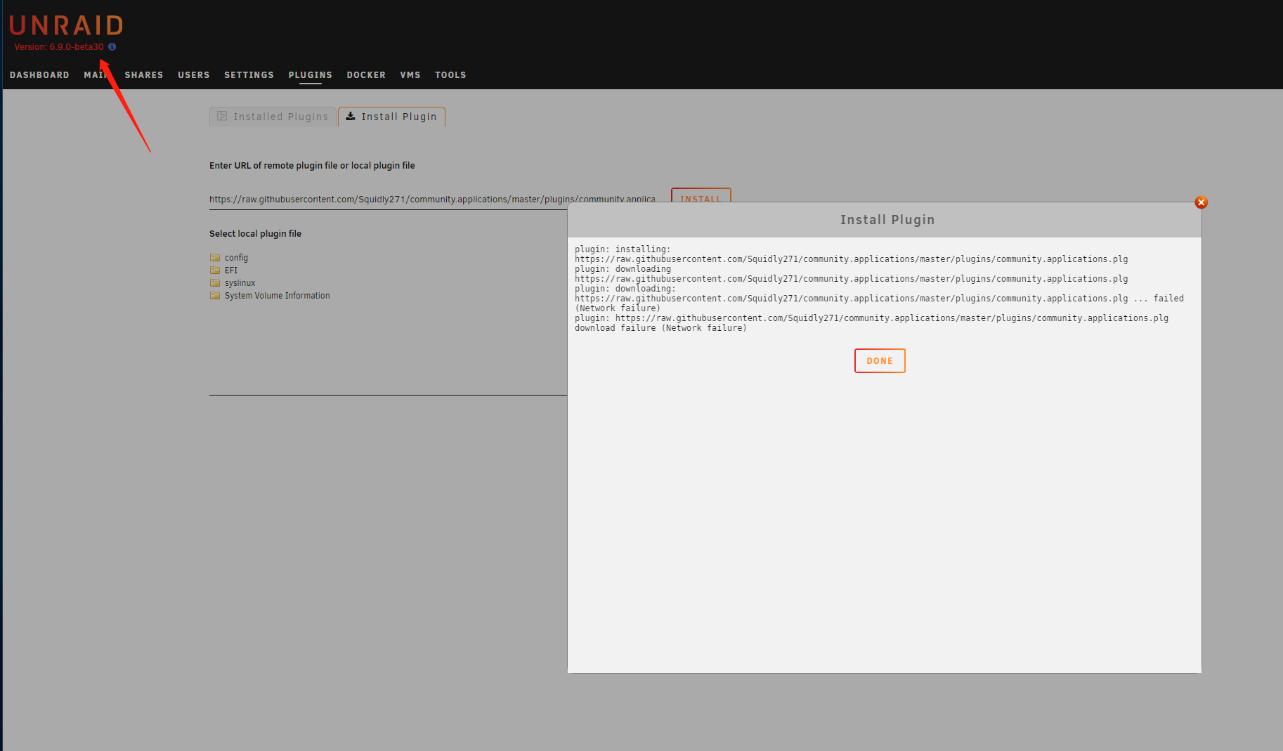

October 30, 20205 yr Author 1 hour ago, ChatNoir said: You would need to install the Community Applications plugin : Then go to Apps and install the Chinese language pack. plugin: installing: https://raw.githubusercontent.com/Squidly271/community.applications/master/plugins/community.applications.plg plugin: downloading https://raw.githubusercontent.com/Squidly271/community.applications/master/plugins/community.applications.plg plugin: downloading: https://raw.githubusercontent.com/Squidly271/community.applications/master/plugins/community.applications.plg ... failed (Network failure) plugin: https://raw.githubusercontent.com/Squidly271/community.applications/master/plugins/community.applications.plg download failure (Network failure) It doesn't look like it can be downloaded Edited October 30, 20205 yr by FameKing
October 30, 20205 yr Author 1 hour ago, ChatNoir said: You would need to install the Community Applications plugin : Then go to Apps and install the Chinese language pack. https://gitee.com/BlueBuger/community.applications/raw/master/plugins/community.applications.plg I have downloaded and installed the app market through this link

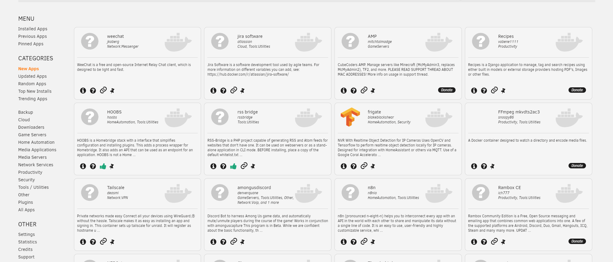

October 30, 20205 yr Author 1 hour ago, ChatNoir said: You would need to install the Community Applications plugin : Then go to Apps and install the Chinese language pack. But I can't load the icon, and I can't find the related plug-in by searching Chinese

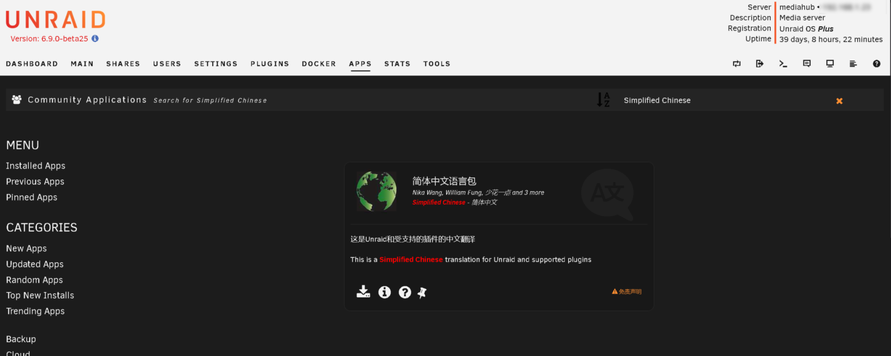

October 30, 20205 yr Community Expert See if this helps: https://unraid.net/blog/unraid-6-9-multi-language-support
October 30, 20205 yr Community Expert 29 minutes ago, FameKing said: But I can't load the icon, and I can't find the related plug-in by searching Chinese Are you running the 6.9.0 beta? Multi-language support (and thus Chinese support) is new in the 6.9.0 release and not available in the 6.8.3 release.

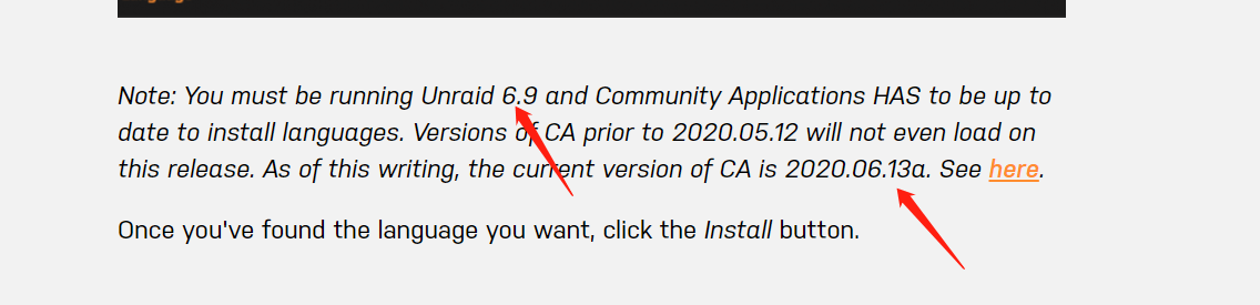

October 30, 20205 yr Author 29 minutes ago, JorgeB said: See if this helps: https://unraid.net/blog/unraid-6-9-multi-language-support This requires that the CA version number is 2020.06.13 or above, but I can't download the latest version through the address you sent to me. I don't know what's wrong with the networkThis prompt appears when I try to download it from the website you gave me I found the address to download and install 2020206, and can not be updated
