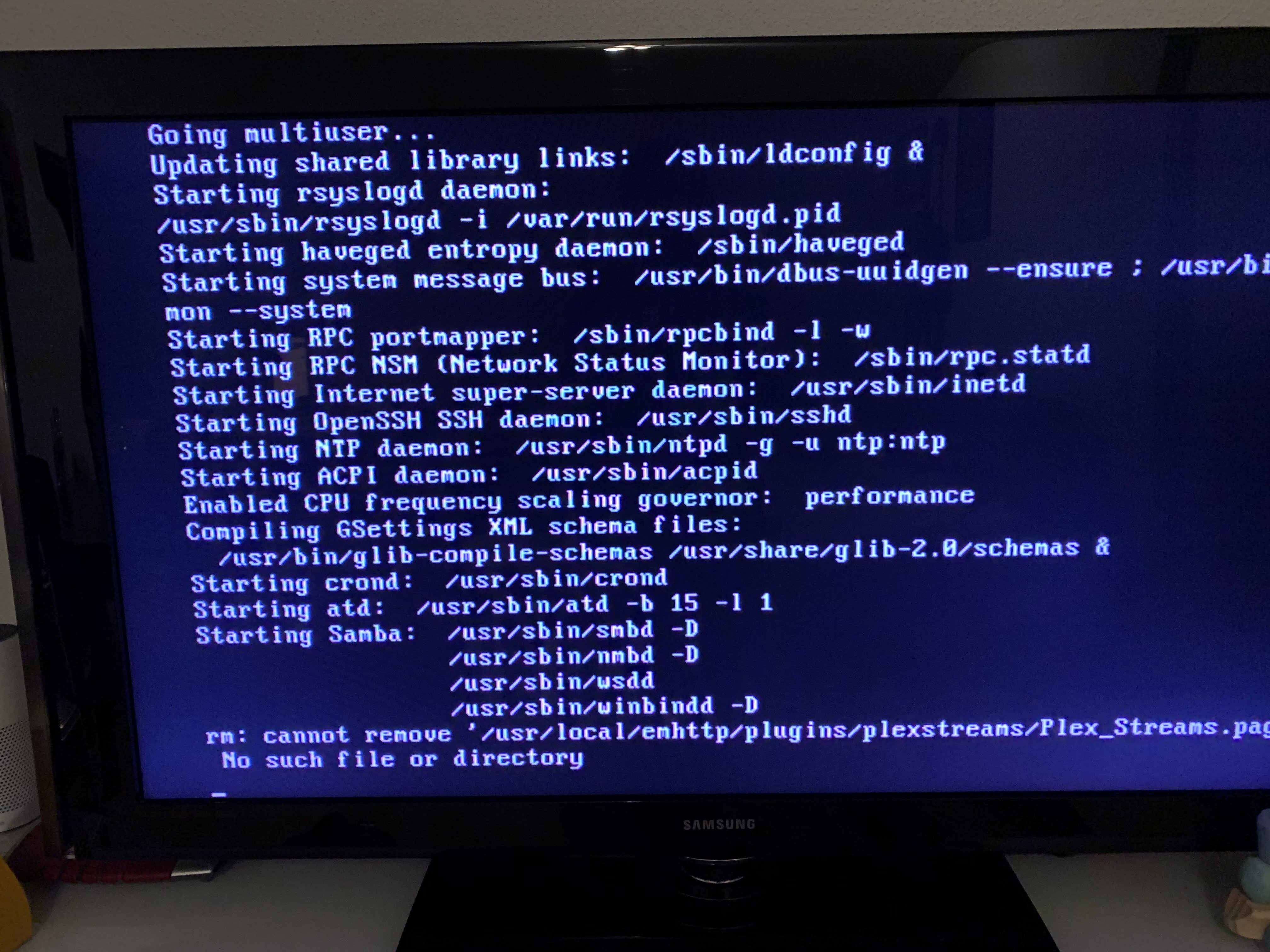

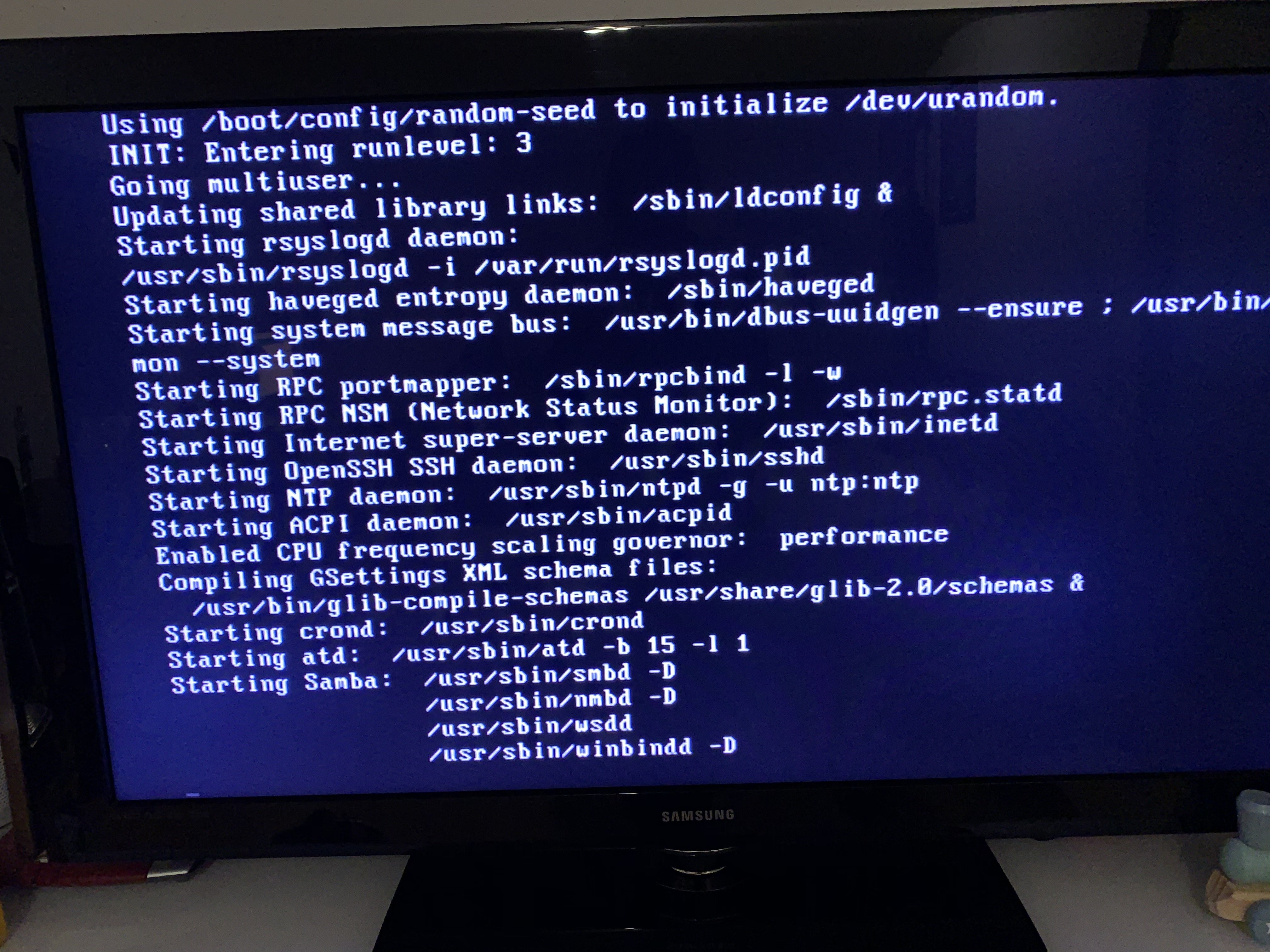

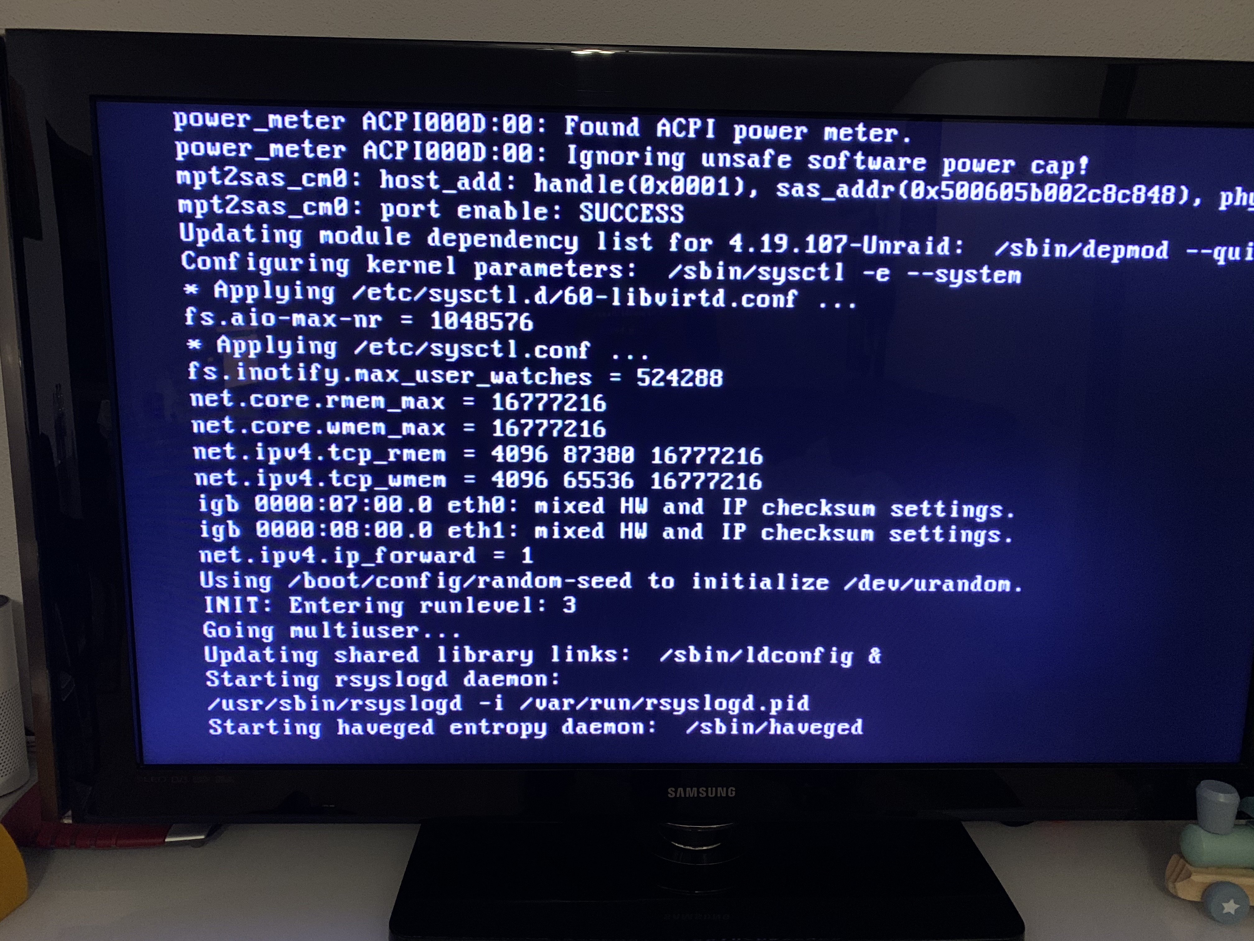

While booting it stuck very long on this sequence:
then this:
and after this, it goes black screen:

It still stuck very long on this:
starting haveged entropy daemon: /sbin/haveged
then black screen ...
