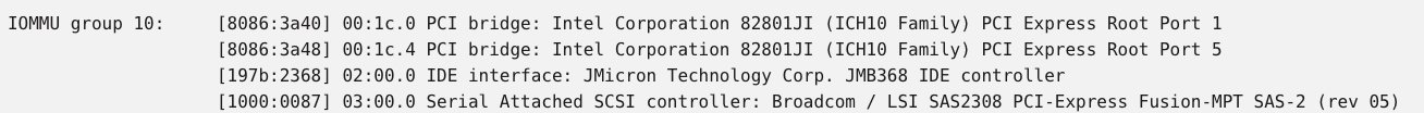

I've got another thread here where I'm trying to resolve slow parity rebuild/sync speeds - estimated 6 days to do a 16TB data disk rebuild from parity. It looks like my LSI HBA is being throttled to PCIe x1 even though it's in a x8 slot. The message I see in the syslog says this:
Oct 27 02:54:54 AnimNAS kernel: pci 0000:03:00.0: 8.000 Gb/s available PCIe bandwidth, limited by 2.5 GT/s x4 link at 0000:00:1c.0 (capable of 63.008 Gb/s with 8 GT/s x8 link)
I want to try 2 things to see if I can resolve this:
1) Isolate the LSI HBA in its own IOMMU group - currently it shares a group with 3 other items, one in specific that the syslog mentioned is limiting the PCIe link speed.
2) Move the LSI HBA to another x8 slot on the motherboard.
Both of these will require me to power down/reboot the system. The data drive rebuild has been running for 3 days and estimates another 3 days to go. I just want to know if the rebuild state will continue from where it left off before the reboot or if I'll have to start the rebuild from scratch? I know that preclears can be resumed after reboot so I'm hoping a data drive rebuild from parity also can be resumed.

Seems you plug the HBA to ICH PCIe, no IOH ( 5520 Tylersburg ) PCIe for HBA ?
BTW, platform was Gen2 max , so LSI SAS2308 won't perform better then SAS2008.

There are only 2 PCIe x8 slots on the Supermicro x8DTN+. From the block diagram in the manual it shows that the one I'm plugged into should be connected via the 5520. That's why I want to shutdown/reboot - to move it to the other slot to see if that improves the link speed. I still would prefer to know if the shutdown/reboot will mean restarting the data drive rebuild from scratch or if a clean shutdown will let the system continue the rebuild from where it left off.
Yes

Yes ( IOMMU group won't be the issue ), real issue was PCIe bandwidth provide for HBA, so you need make decision.
