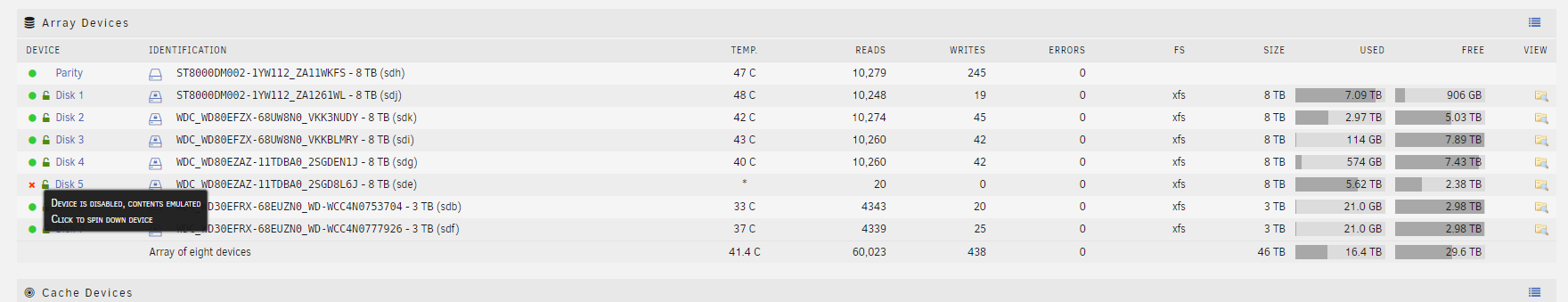

Disk disabled content emulated
Hi guys
Just a quick query on this. This disk seems to be causing some issues. It says disabled contents emulated.
I dont beleive there is anything wrong with the hard disk. I did a clean of the server and used a blower to get rid of the dust. I ensured all cables are secured. This started happening after the clean so I dont think there is anything wrong with the disk.
I also dont know what emulated means? There is a lot of data on the drive and I am at a loss as to what to do about this.
Emulated drive means that the data is only available by computation of data from all other drives and parity. It also means that any other issue on another drive might cause data loss. You should fix this quickly.
You should attach your diagnostics (Tools / Diagnostics) in you next post.
Disk looks healthy, the emulated disk is mounting so if contents look correct you can rebuild on top.

Thank you @JorgeB I just saw the upgrade post and I think I will really need some help with that, like a video of some sort.
Can you please explain what you mean by the emulated disk is mounting? It shows as disabled so not sure what you mean. How do I rebuild on top? SOrry I have been out of touch with unraid for a while since I have been busy with work and not had time to do anything here.

This section of the online documentation (accessed via the ‘Manual’ link at the bottom of the Unraid GUI) covers rebuilding a disk onto itself.    You may also find the preceding paragraphs to be of interest.
Thank you guys. I have started the rebuild. It will take 3 days to do it.

Just a quick update, it seems like that HDD has been disabled again. This is most bizzare. It just gets kicked out by itself.
history-diagnostics-20201103-1046.zip
You still didn't update the HBA, older firmwares have known issues with some newer drives, you can also swap cables with another drive to rule them out.
