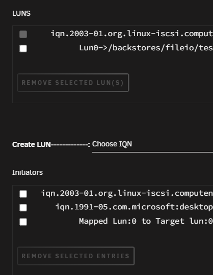

39 minutes ago, Killersplace said:
hi al
i am new to ISCSI i installed the plugin en uset the guide in there and all seems ok but in windows side i can add the iscsi but when i try to connect it cant i get Authorization failed
Does you Initiators tab look Similar to this?
Edited by SimonF

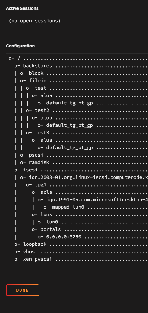

i cant see anything !!
here is my pics
and windows side sorry its in swedish but you can tell i hope

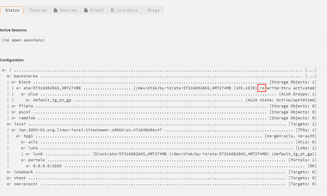

here is my pics
You need to create the IQN for the windows machine. And add a mapping.
ok i thot i did it already
and did it again and now it works THX

i tested some disktools an they say the disk is READ ONLY
meaby the disk is bad but in unraid i have used it before but i am emptying  an other disk that i can test whit
Look at your screenshot from above:
Do you see where the issue is? Please remove the drive from the Windows Initiator side, after that remove it in the iSCSI plugin and then add it again and make sure that you do NOT click "Read Only".
OMG now i just feel stupid    the read only thing wasent obies i that it was for ID to the disk
but now it works i whan to thank you so mutch fore the help

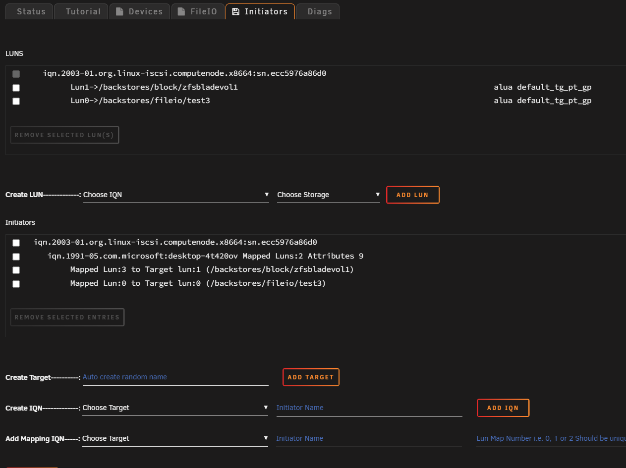

Would it be possible to use a zvol now that unraid has ZFS i can create the zvol fine but cant seem to map to it under devices its only showing the /dev/sda and not /dev/zvol
At present you can add via  targetcli

/backstores/block> create zfsbladevol1 /dev/zvol/zfs/vol1
Created block storage object zfsbladevol1 using /dev/zvol/zfs/vol1.
/backstores/block> exit
Global pref auto_save_on_exit=true
Last 10 configs saved in /etc/target/backup/.
Configuration saved to /etc/target/saveconfig.json
Then you can create a LUN and add via the gui. Will look into adding the Device mapping part.
